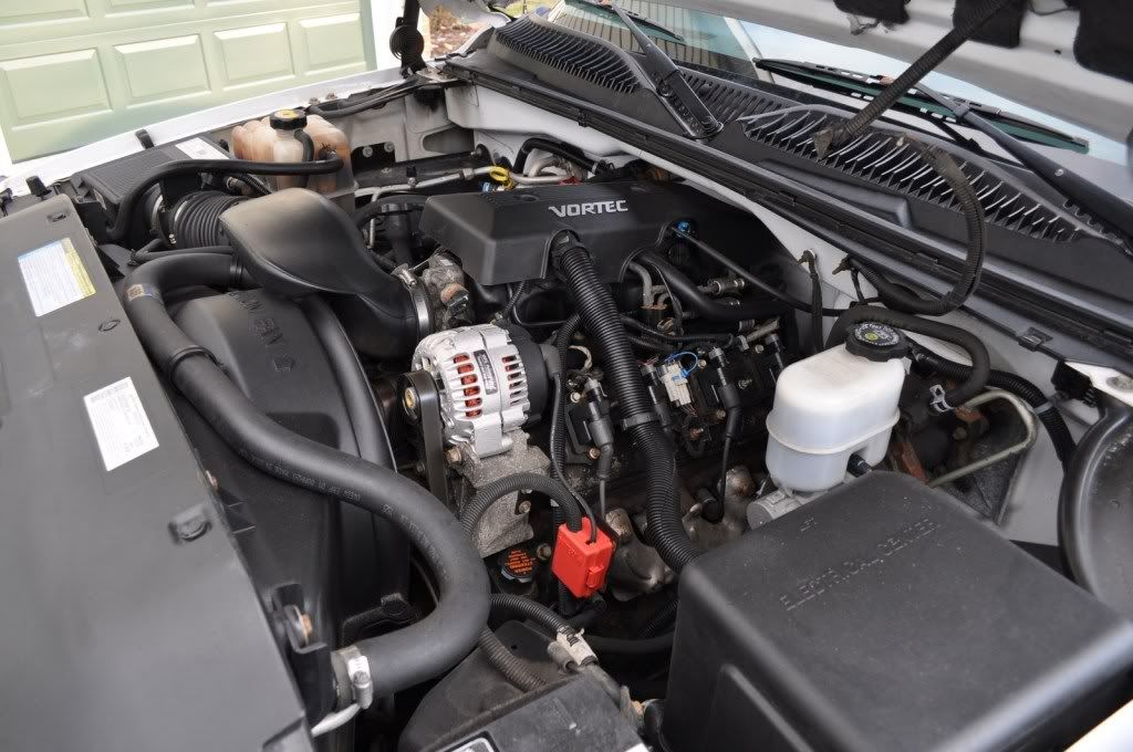

so i picked up this truck
2000 silverado 2500 light duty.
6.0, 4l80e, 14 bolt rear, 212k miles young!

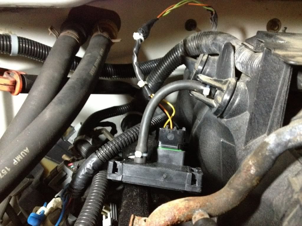

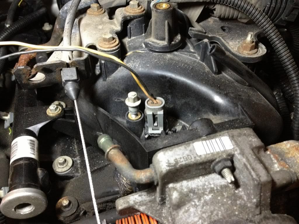

pulled the evap, isntalled a IAT sensor since im removing the maf
3 bar map from EFI source

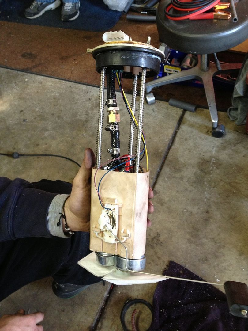

 twin walbro 400s in the tank
twins!

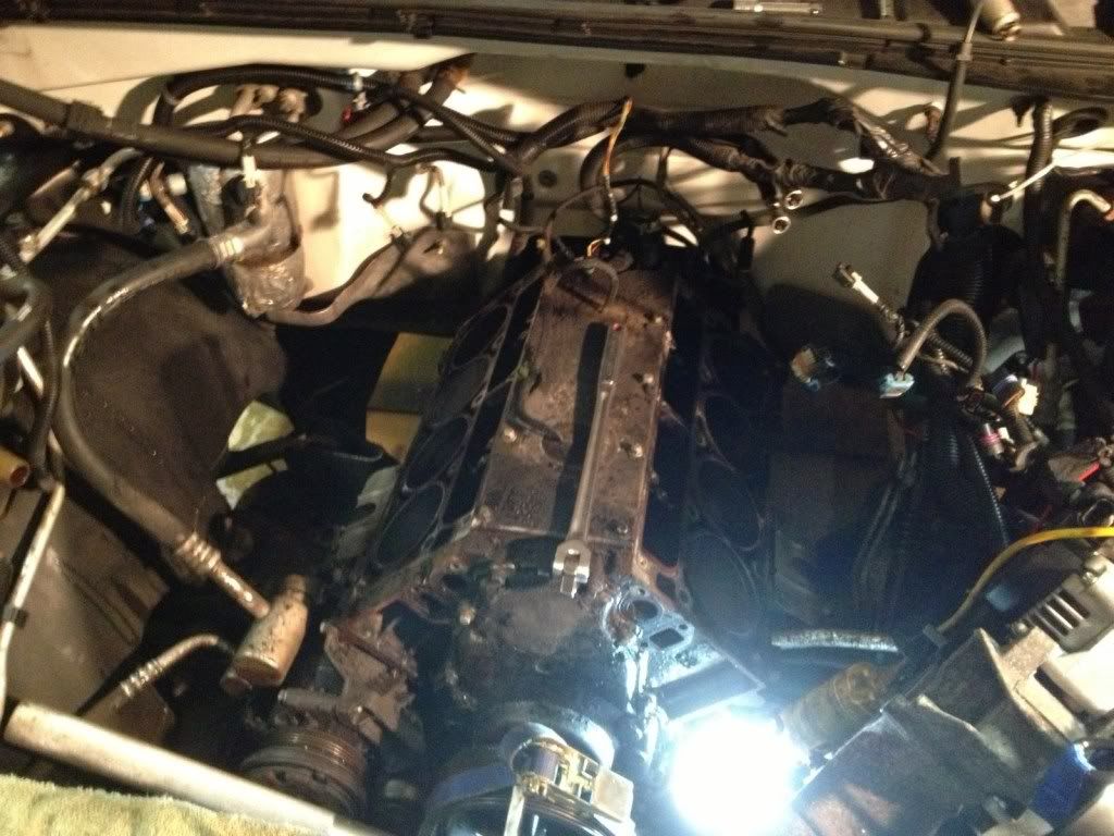

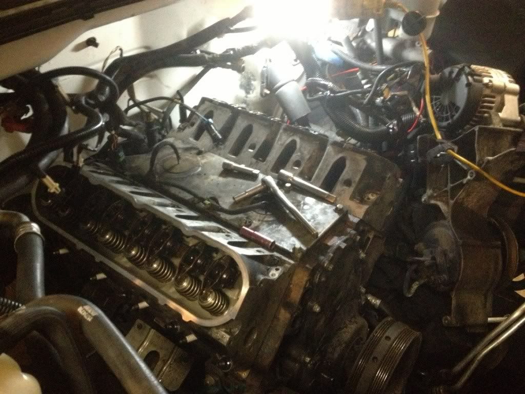

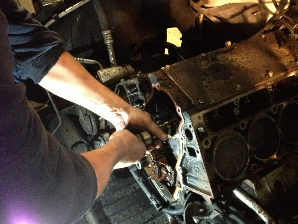

 started the tear down
custom cam from martin @ tick performance
 80lb injectors
alum 317s with pac 1218 springs

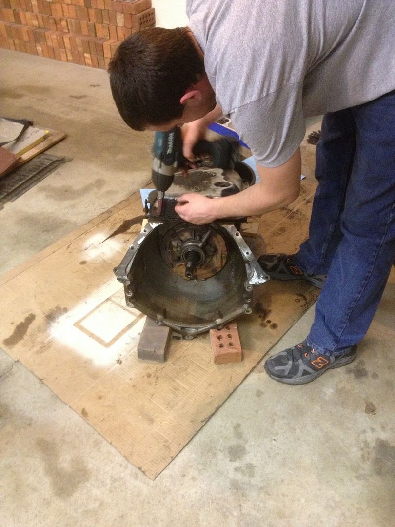

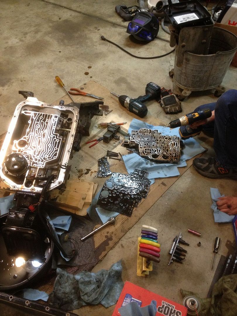

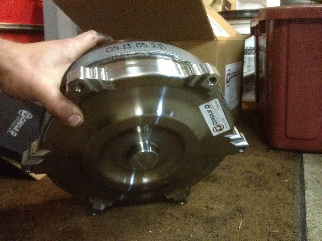

pulled the 4l80e for some work
 circle D triple bilelt lockup

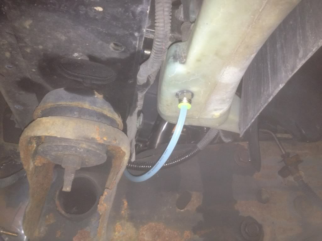

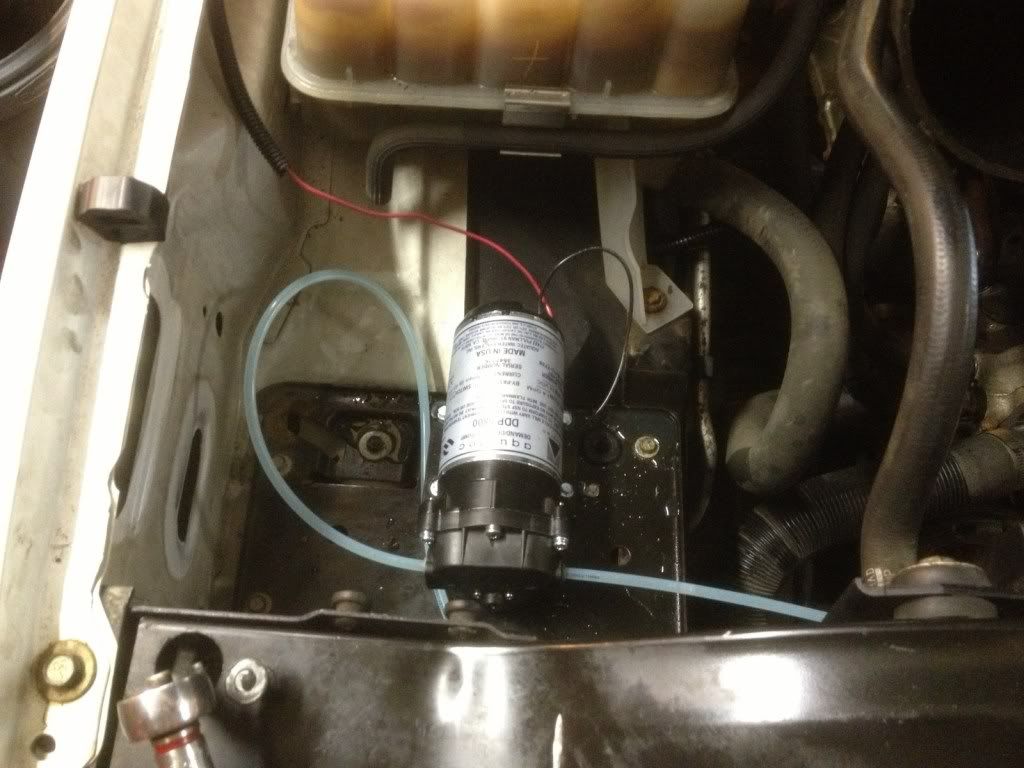

 meth kit in the stock washer fluid tank

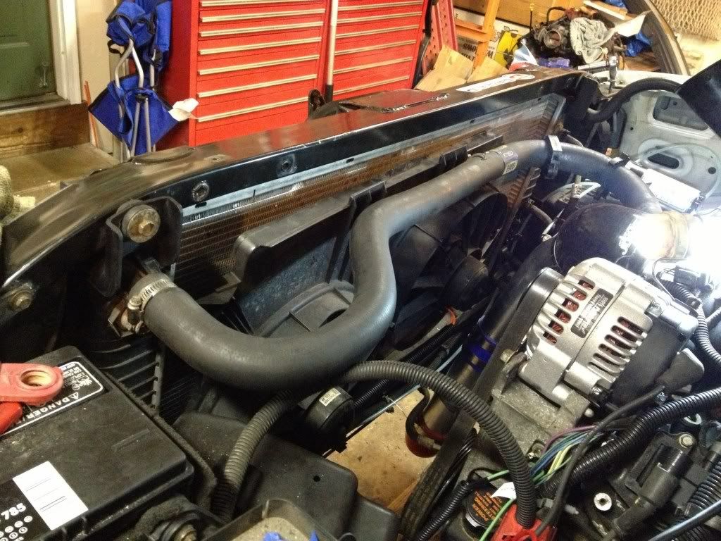

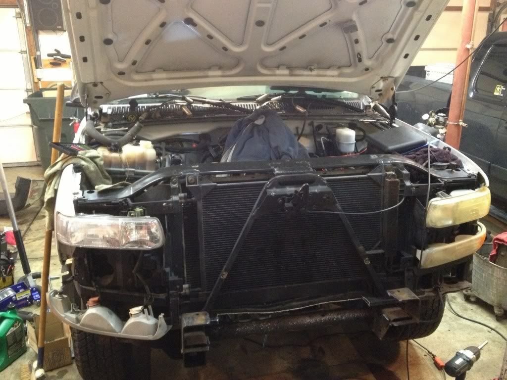

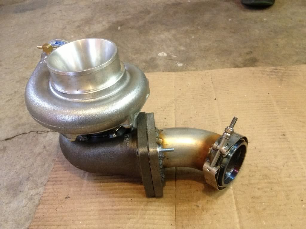

 removed the clutch fan and installed LS1 fans

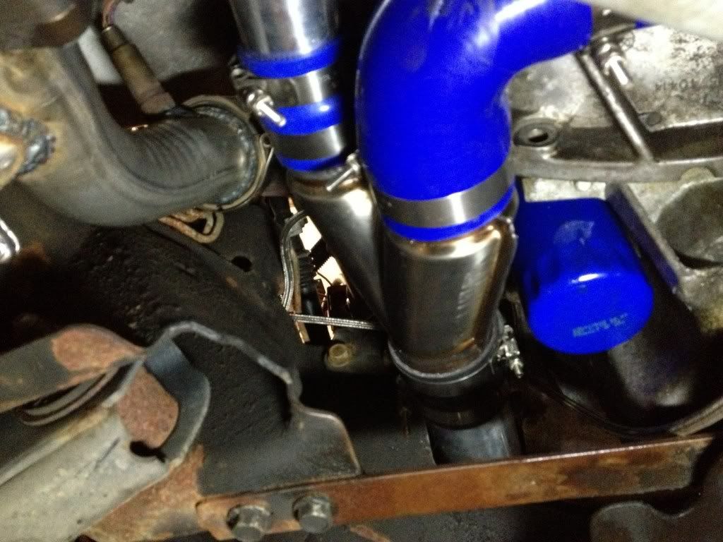

intercooler piping
 out on 12psi valentines day

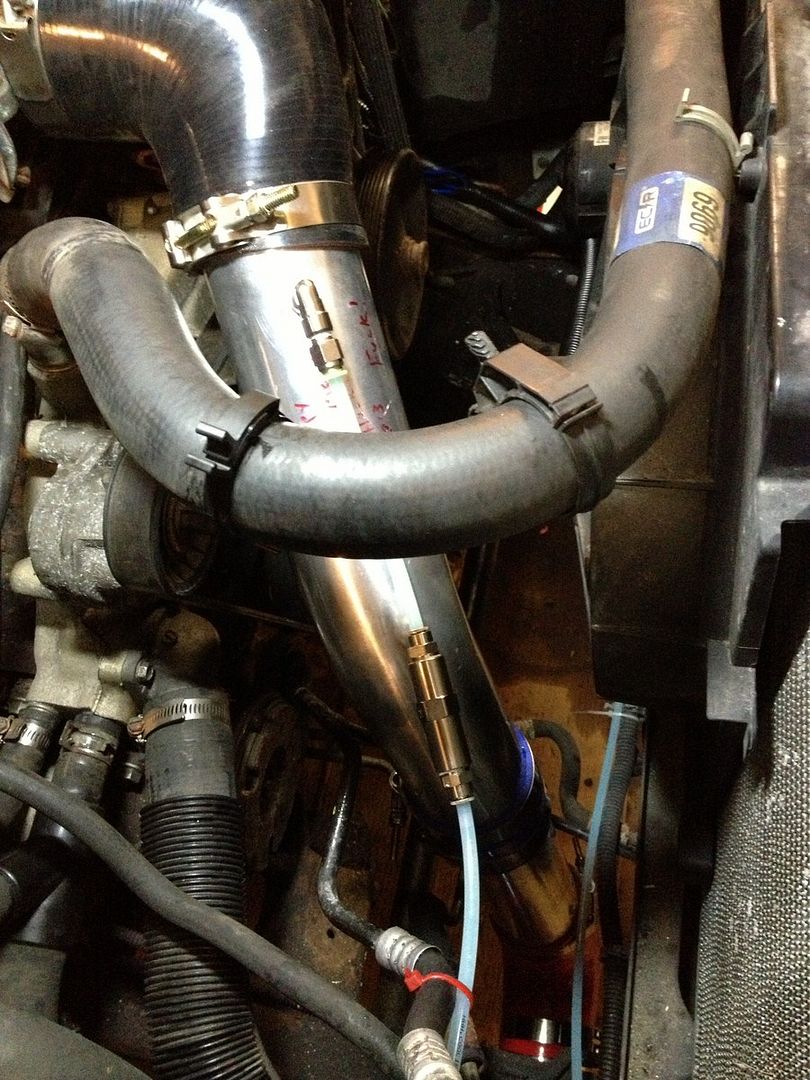

Info on the water meth setup,  pump, lines, nozzles, location of nozzle before or after turbo, hobb  switch being used or not.
it was a base cooling mist kit off ebay.
i set it at 6psi hobb switch that came with it
single nozzle, i dont even know what size, you can see it right there before the 90 into the throttle body.

« Reply #9 on: February 16, 2013, 06:27:08 PM »

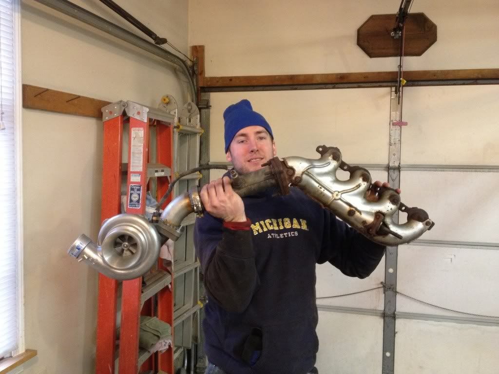

Fuck yea! I been thinking of turbo'ing my 03 yukon (same motor). More info on the iat/3bar? Also with the turbo mounted in that location how do the return lines look?
denmah
  • Posts: 55
Re: 2000 silverado 2500 LD (sloppy mechanics)
« Reply #10 on: February 16, 2013, 06:32:14 PM »
its a buick 3800 sensor and pigtail out of a junkard, thats where i get all my sensors when i do megasquirt builds,
the 3 bar and pigtail is from EFI source, its like 40~ shipped.
i have a turbowerx scavenge pump pushing the oil back to the oil fill cap in the valve cover.

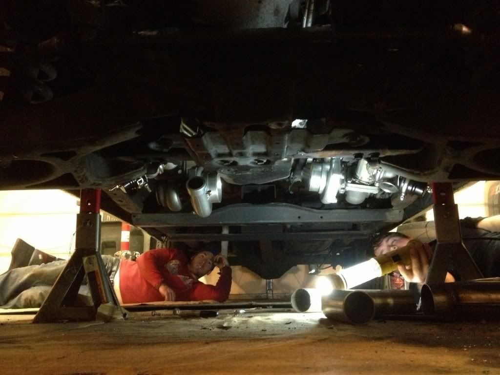

nope i just got it together the other day, built it in about 2.5 weeks start to finish, had some problems with my wastegates getting stuck open haha!

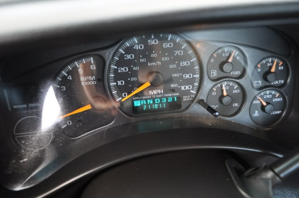

Am I seeing that right, 211k on the odo???? FUCK!
denmah
  • Posts: 55
« Reply #17 on: February 19, 2013, 05:57:53 AM »
Wow, that looks like fun.
yeah i bought it with 211,866 or so. and immediately turbo'd it
its over 212 now haha
i have only had it 4 weeks now
i was out beating up these drilled chinese wastegates, they are holding boost great.

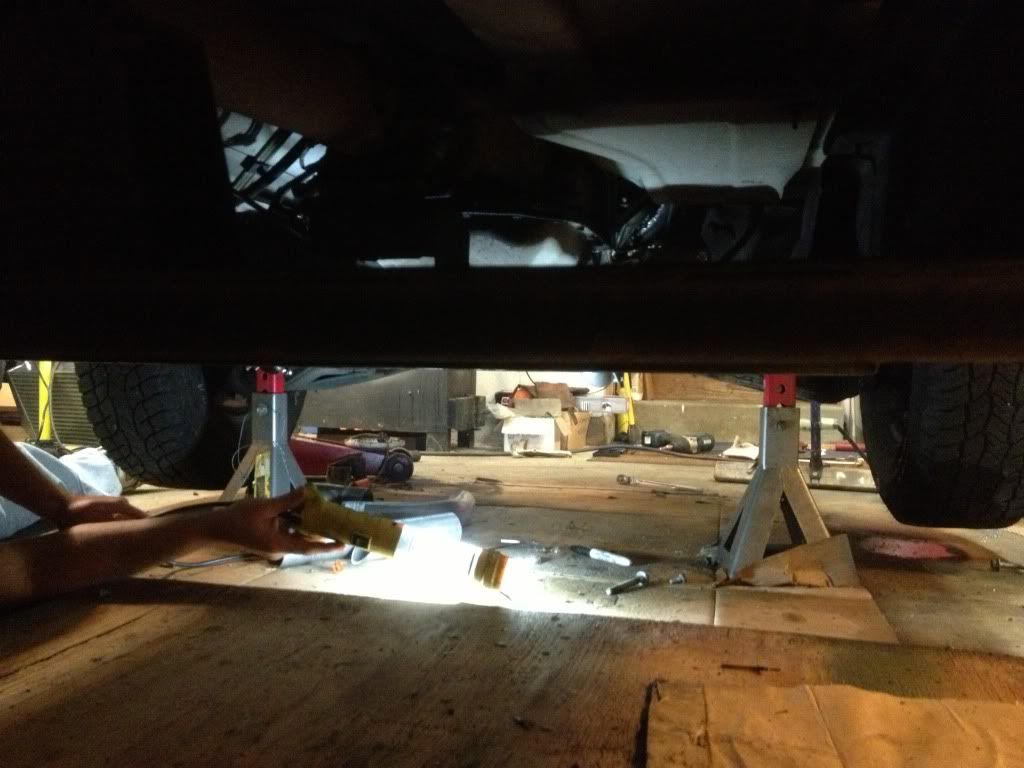

stock rear was pretty worn out and i hate 1 leggers so i pulled a junkyard unit and welded it up, slammed it in last night
