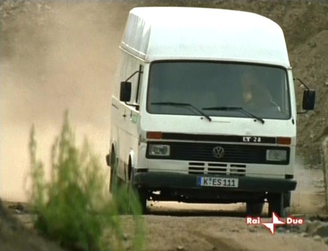

Came off this.  LT28 van, 2.4l 6cyl diesel.

This is the first time he's heard any of this.

Yeah, I know what it came off of. It came off that VW van and an 87 Volvo 400 series. but what I don't know is what the trims are. What size is the compressor? Turbine? A/R? How much horsepower is it good for? That's the info I'm having a hard time finding.
