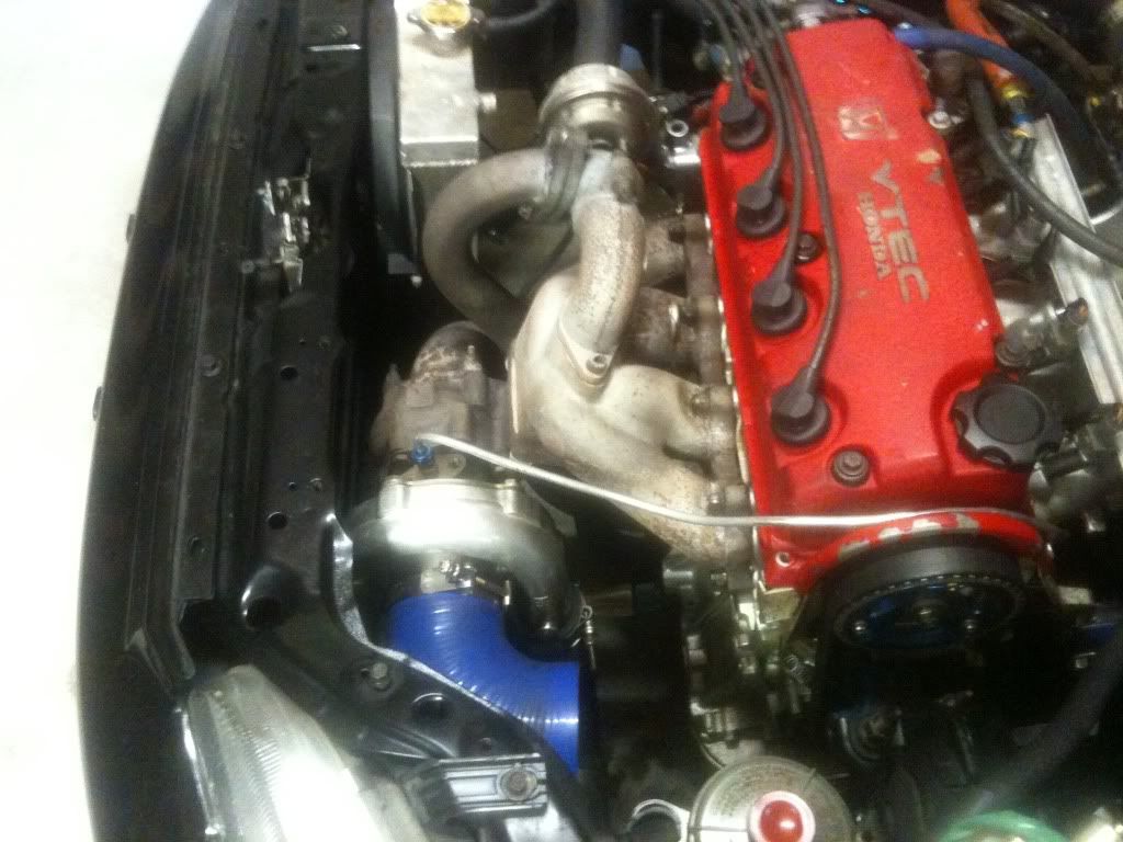

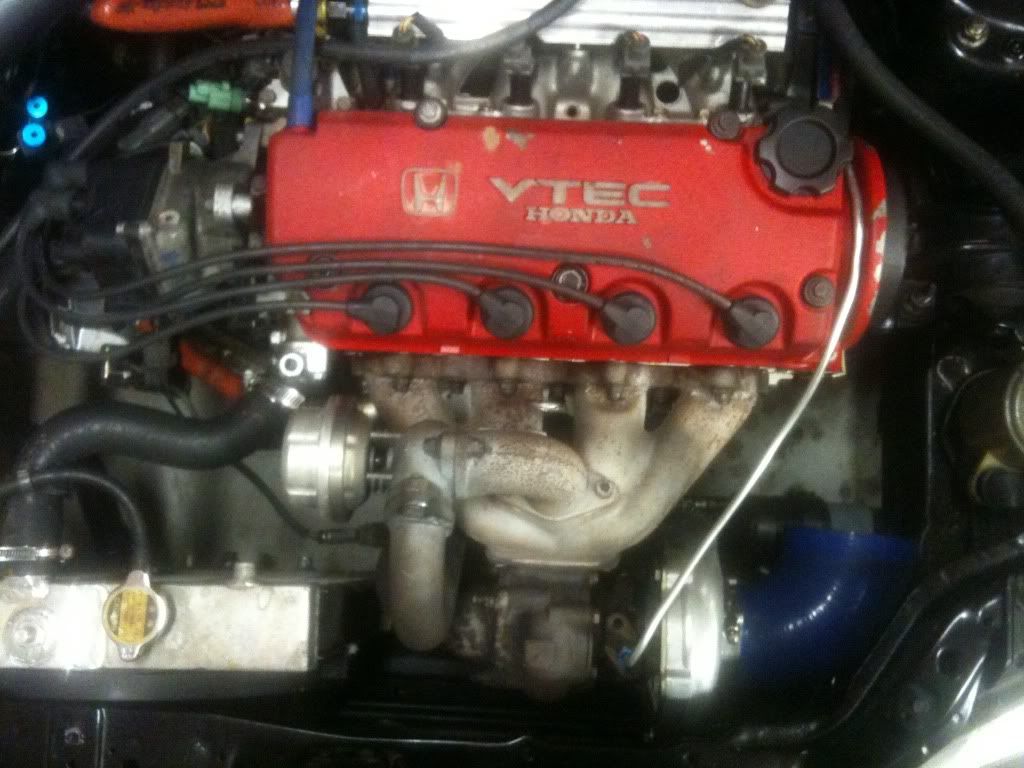

Re: does this manifold exist/other place to buy it (not gay/stupid post)
« Reply #19 on: August 02, 2010, 04:34:15 PM »
No, for the power I had planned I wasn't gonna trust one of those. Then again, if it's tuned for the boost creep then it might have worked out. Ha ha.
It should clear the condenser but routing the DP is going to be tough. I will take a good straight down pic of mine when I get home from work in about 45min.
« Reply #20 on: August 02, 2010, 10:59:22 PM »
I was slackin. Saw my neighbor in his garage drinkin on my way home and stopped by to join him. Anyway, here are the pics
No amount of grinding of the hood will stop it from doing this unless you put a hole in the hood.
« Reply #21 on: August 03, 2010, 04:27:44 AM »
that manifold fits like garbage.
« Reply #22 on: August 03, 2010, 08:11:52 AM »
The solution is a tighter radius elbow with an extension to the left... $1.50 1.5" rigid 90 from ace hardware and 50 cents of pipe plus a flange.
Horizontal wg flanges with wg dp flange facing down as much as possible.  Rotate the bitch 45 to the radiator.  Bolt pipe to wg, wg to 90 bend pipe, bent pipe to mani.
Aka whoever designed that had a quarter of a brain.
« Reply #23 on: August 03, 2010, 08:18:57 AM »
My plan is to either make a new elbow and rotate the wastegate flange to point the exit of the wastegate down, or make a whole new manifold. I'm changing my plans somewhat with this car. I want something that drives more stock. 75.5mm vitaras to keep it quiet, FJ custom length rods to help the off boost power, mild regrind on the cam and maybe an hx35. I want power steering and a/c with 400whp on 93 octane, but drive as stock as possible.
