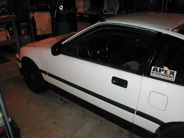

I've detuned the car to full soft on the Koni's and ST rear sway bar. On sticky street Dunlop SP Sport 8000's, slightest trail braking and the rear wants to step out, but very controllable with throttle inputs. H&R springs, dunno if they are the race ones, but fairly stiff. I'd say 350-400F, 250-300R.
Car is more capable than me right now....and thats without the sticky Hoosier A6's I have.
