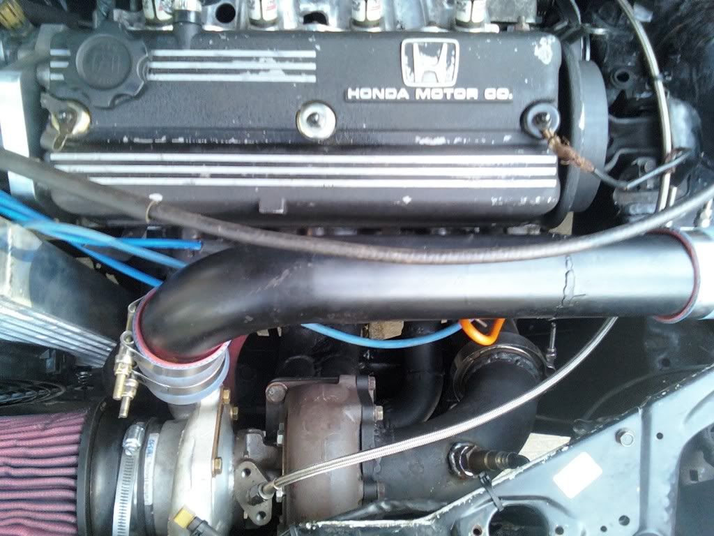

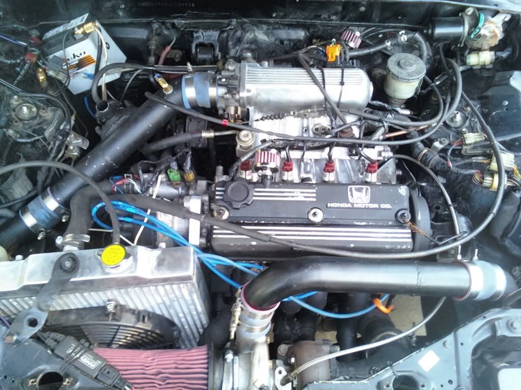

Ask and you shall recieve.   I was tracking down oil pressure problems and found out that my oil pump was bad (read to 55 ish psi and thats it) now with the new gauge i can see my oil pressure is like 85psi hot during a rev.  I was driving the car around today and suddenly the engine stumbled and died, and smelled gas so I immediatley pulled over.  The whole fuel rail popped right off the intake mani!  Gas sprayed eveywhere.  It looks like the fuel rail bolts actually pulled right out of the intake manifold.  Its not really that surprising considering ive had to basically helicoil every thread on the mani itself, like the TB bolts etc... Never mind the battery not bolted down, I built a mount for it, now its secure.
