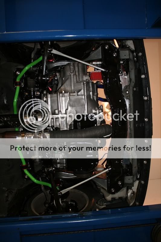

Looks like he forgot to install his vc and front cv's. But yeah, he's probably the guy I need to talk to.

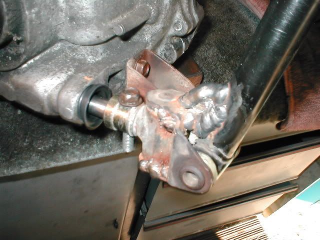

One now uses a bolt to hold the linkage on without any slop...slot the end piece :)

Wait. Twat? Slot what end piece. Ive always wondered why no one uses a bolt for this. Please, enlighten me.

Fuck, why didn't I use the zip gun? Anyway, by cutting the rod it forced me to repair the 5" play I had on the shifter...
Per CRX Lee Grimes of Koni USA.....
The linkage to the shift shaft on the tranny where the bitch pin goes through, relief slices were cut parallel with the ground. That way when you crank the bolt down it pinches onto the shift shaft.
But I have an issue with this...if you use the bolt you must remove the dust bellow or getting into 2-4-R is tricky even just bench shifting.
its RWD :)
Re: Does anyone know an easy way to?...
« Reply #28 on: October 08, 2010, 12:56:38 PM »
I was being sarcastic.  I know about Jaker's build n all of it's fat tire, fenderflared, two-tone flat black goodness...
