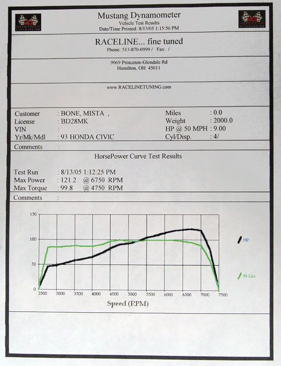

Chris i am not arguing the facts with you. I used to be an all motor guy and know how important 2hp is and how important it is to make power as high as you can rev.
I just don't understand why they would go through all the trouble to do this test and not let off the gas at the same rpm.
Are you thinking were the power dropped off BADLY????
Who is to say that isn't weak valve springs. The run order of the headers, say Bisi first, might have lead to the others dropping off sooner. Notice the fall off in power happens sooner on each test, valve springs are toast!
Also, was the engine retuned for each header? If not this test has no merit. It could have been tuned for the best header and then the others slapped on for testing.
Valve float, D15B7, OEM springs with 200k miles, Crane 251-0016 cam......
