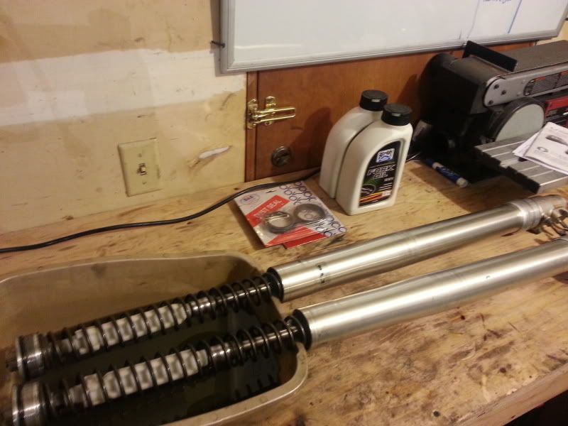

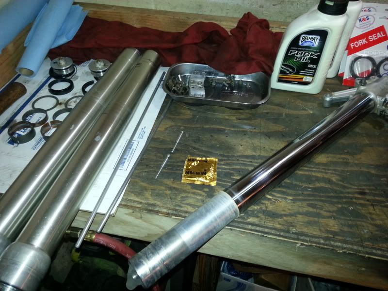

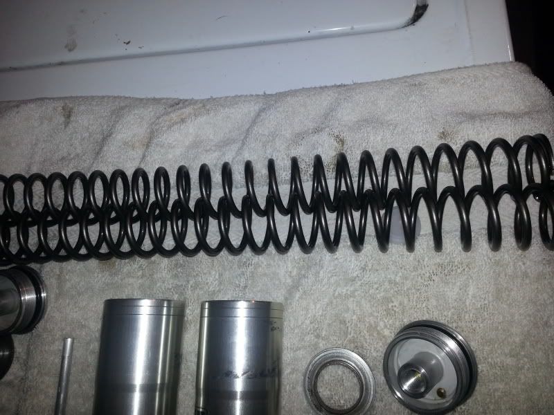

On that note... Updates... Rebuilt the forks... New bushings seals and RACE TECH .48 kg springs... Went up to a 7.5 WT fork oil too... What a difference. Needs a heavier spring in the rear. Can feel it now that the front is right.
When I took the forks apart MAYBE 750 ml of "Fluid" (and I use the term loosely) came out. Spec is around 630 cc EACH LOL... and alot of it was water :O). Seals where done, bushings were really worn. SO the rebuild was definitively due. 1st time doing it. Not that hard. What a difference.
Total into bike: 1000 +- a few bucks with all the new shit. Things fast and runs like a top. Suspension feels SHIT TONS better... Can tell the rear needs  a spring now though... Need to figure out which one to get.

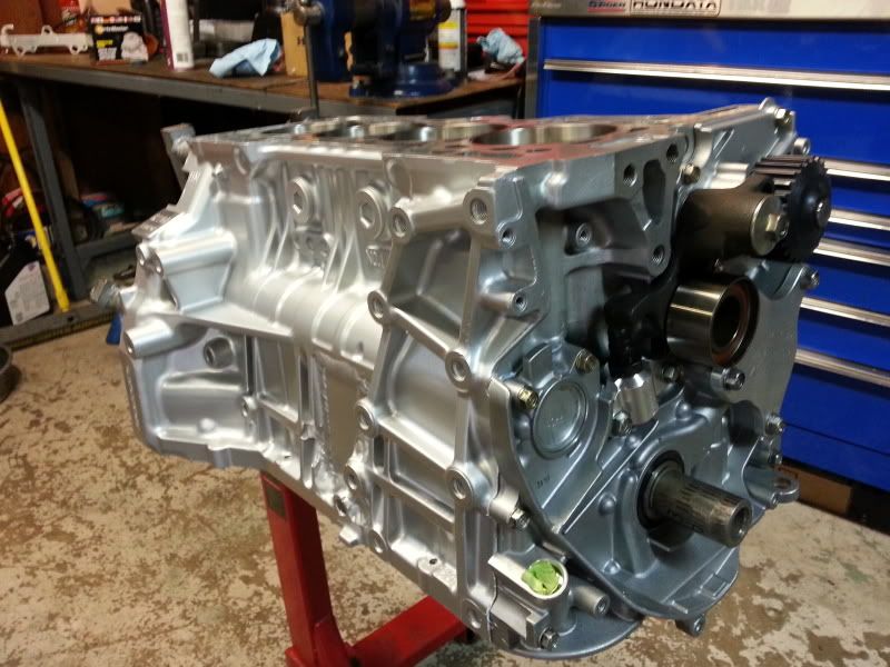

Dont want to hear shit about the motor being in pieces on the bench in the background. Got off my ass Saturday and put it together. Waiting on Comp to make my clutch, and get the head back from porting. I have EVERYTHING to put it together.
