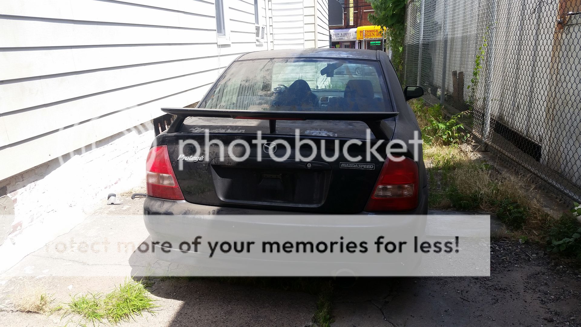

So this project has been sometime in the making. The car been in the family for the last 5 years, about 1-2 years ago the motor blew up while driving. At the time we could not find a reasonably price replacement motor. We did entertain the idea of rebuilding the motor, but upon closer inspection we noticed it had created a window in the block............

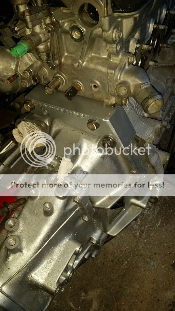

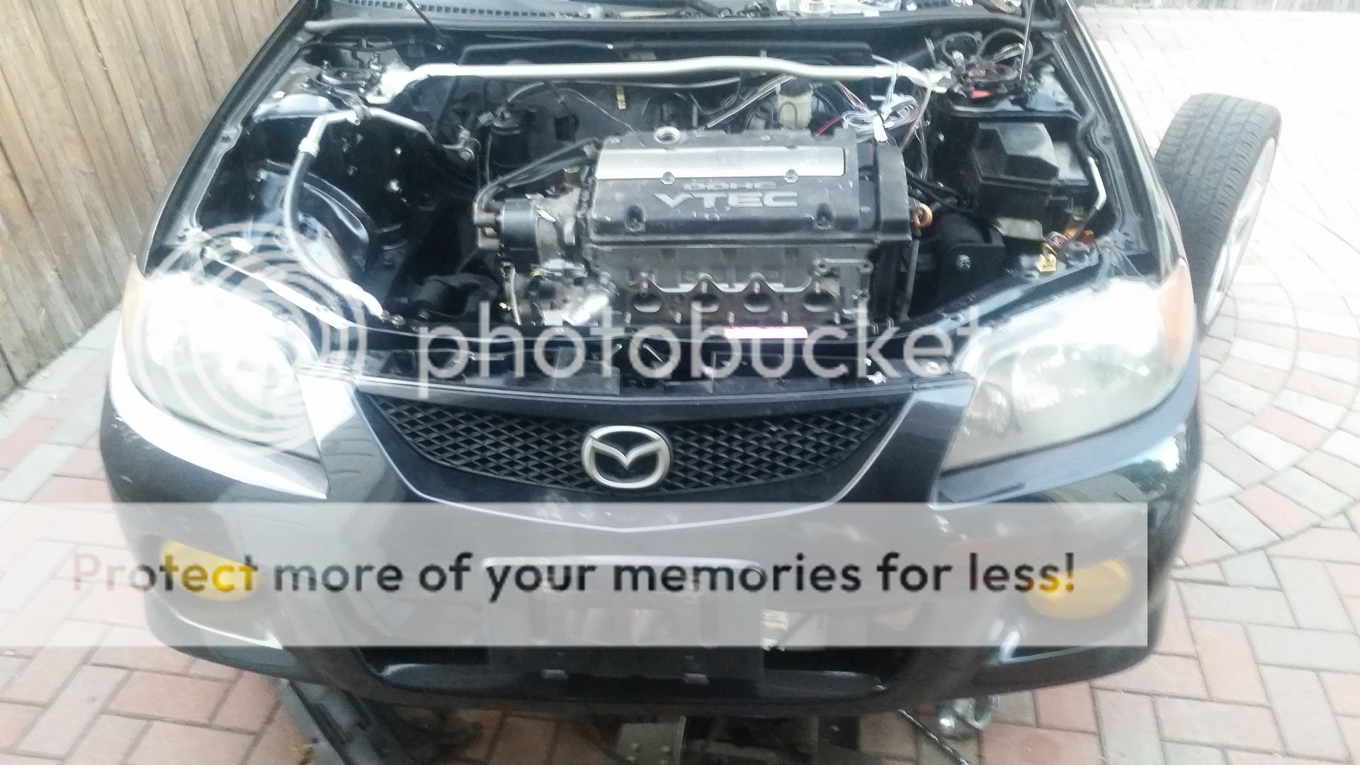

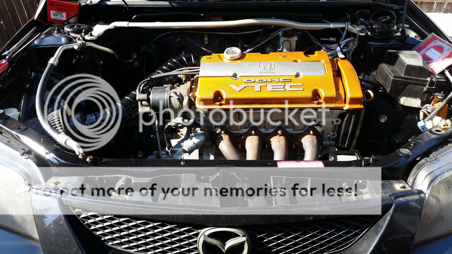

F/h2b plateless
S2k staring down another F

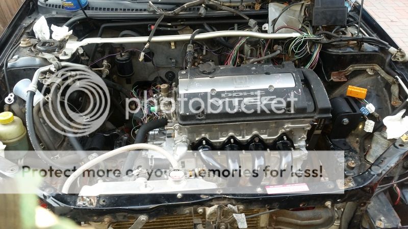

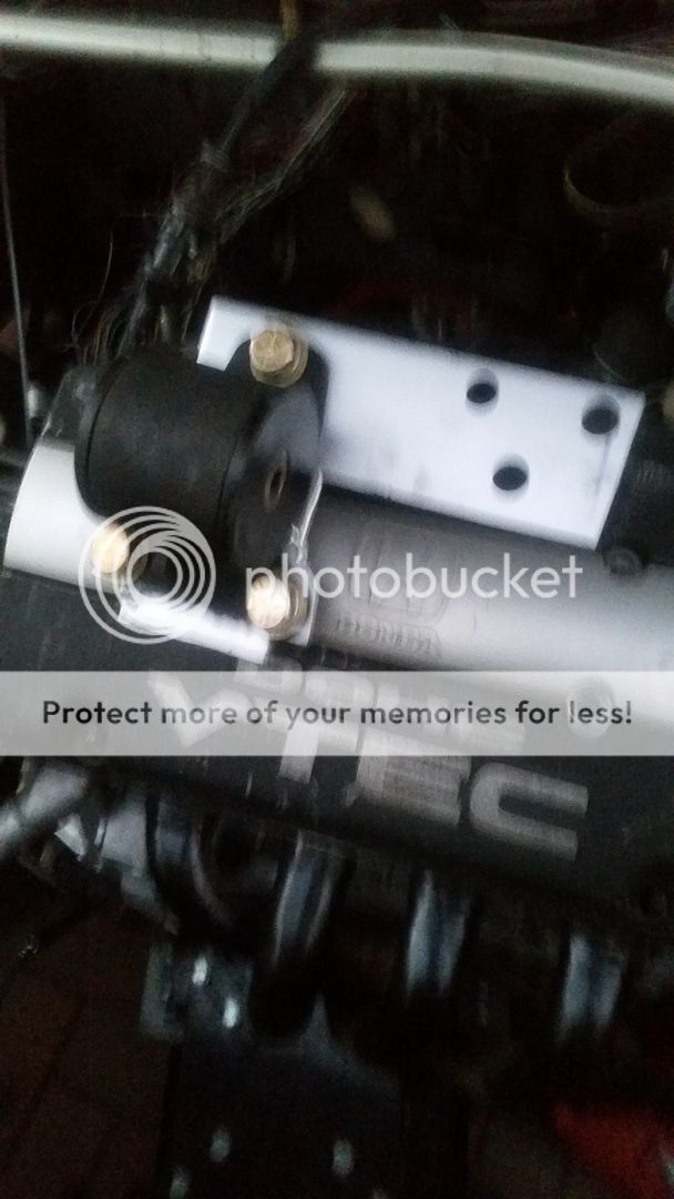

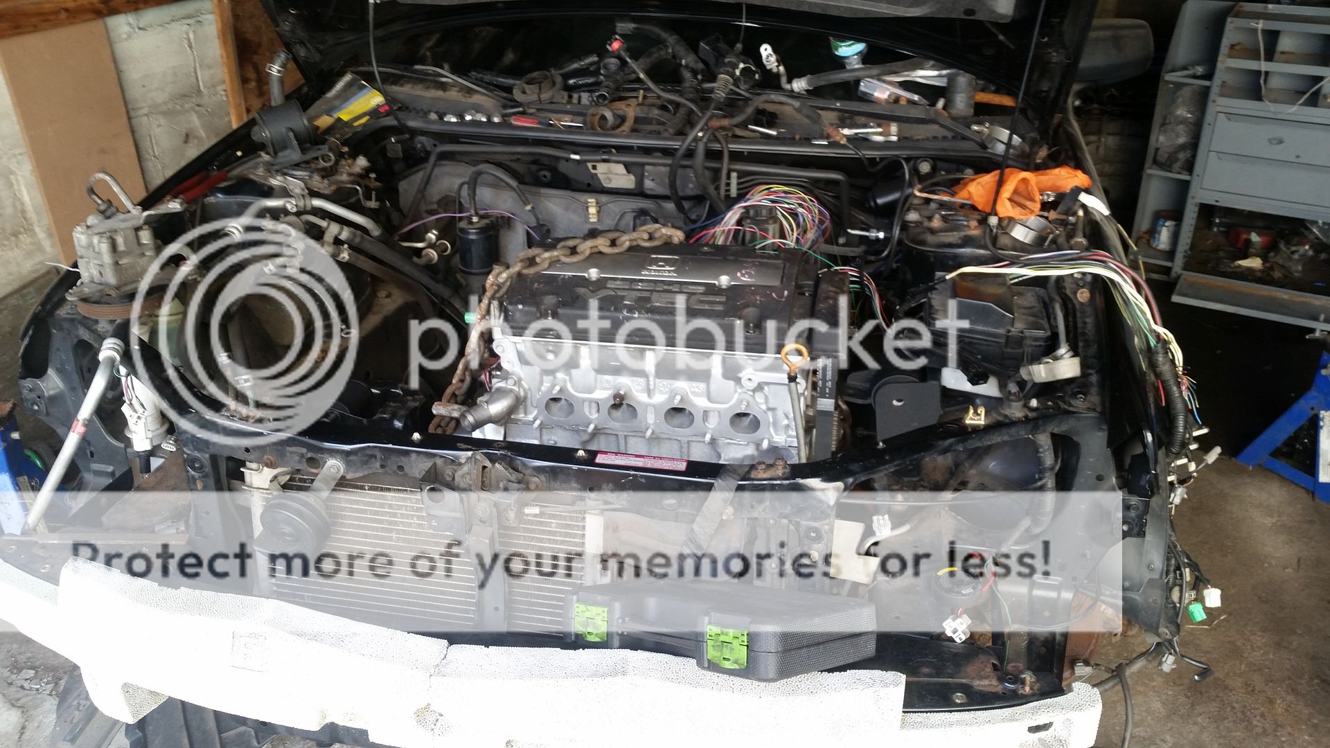

Test fitting the motor

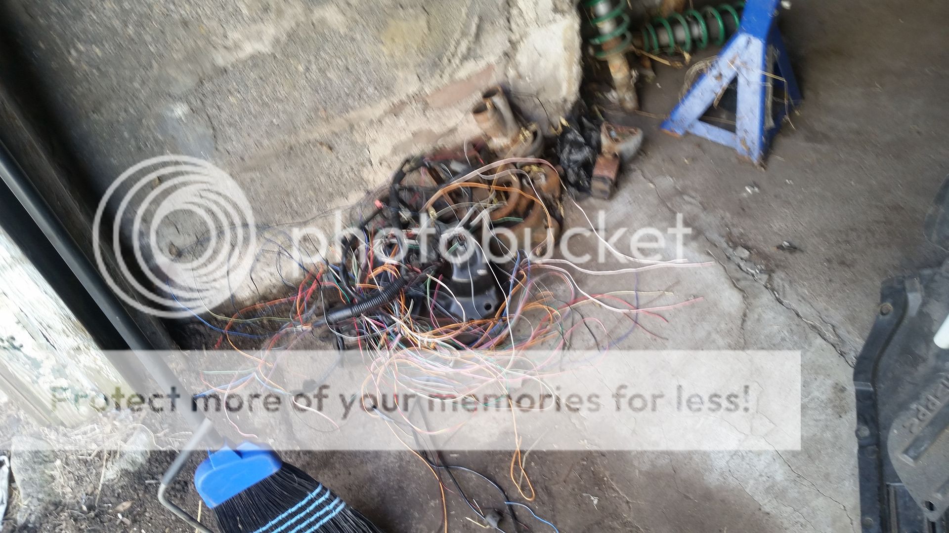

The original engine harness that got cut out.

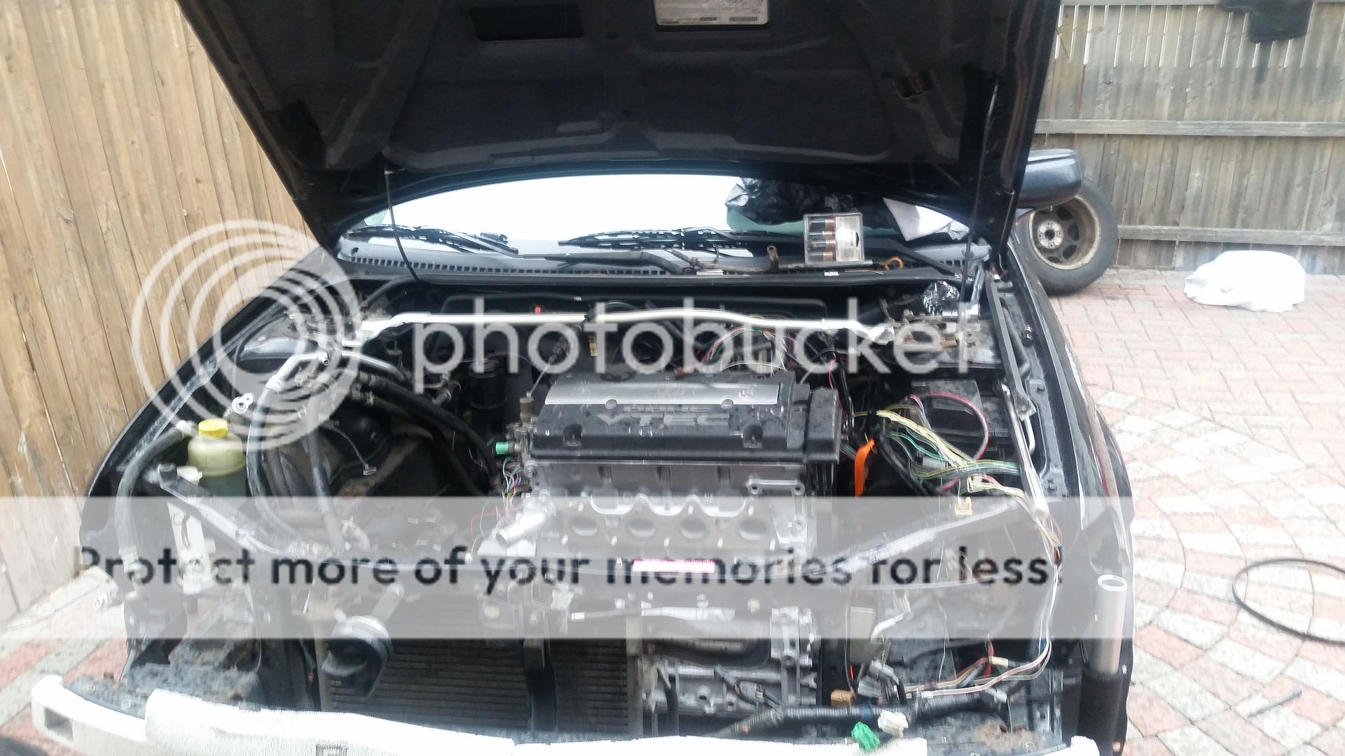

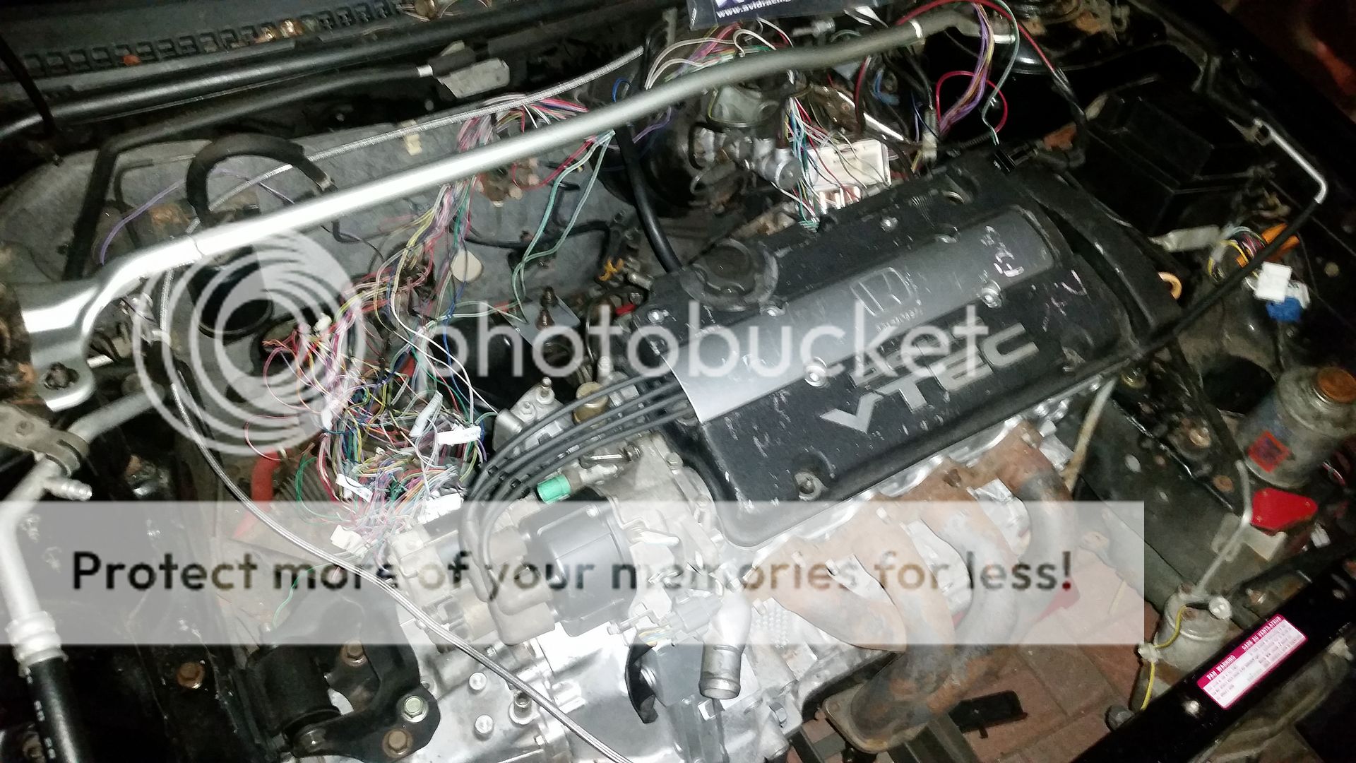

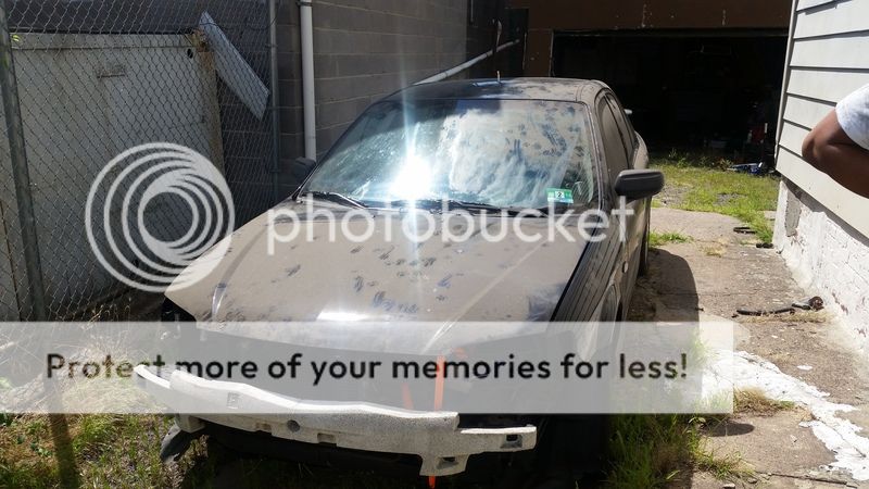

Strapping the motor down. At this point we need to move the car to my home garage for the fab work.
Dirty girl
She looks good with a quick wash after sitting for so long.

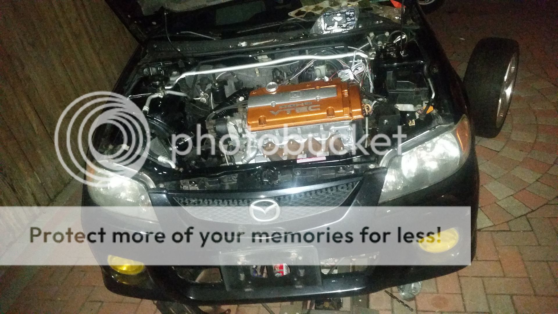

More mock up

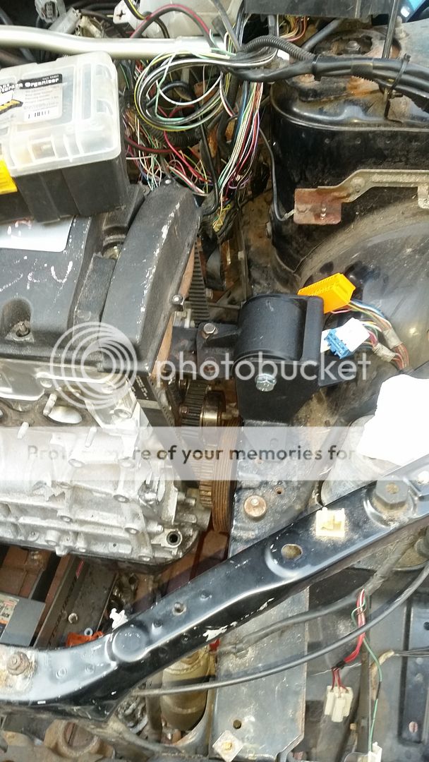

Fab up a new engine bracket.
My approach to building this car has been to treat it like a ek civic. I modified a set of avid steel mounts.

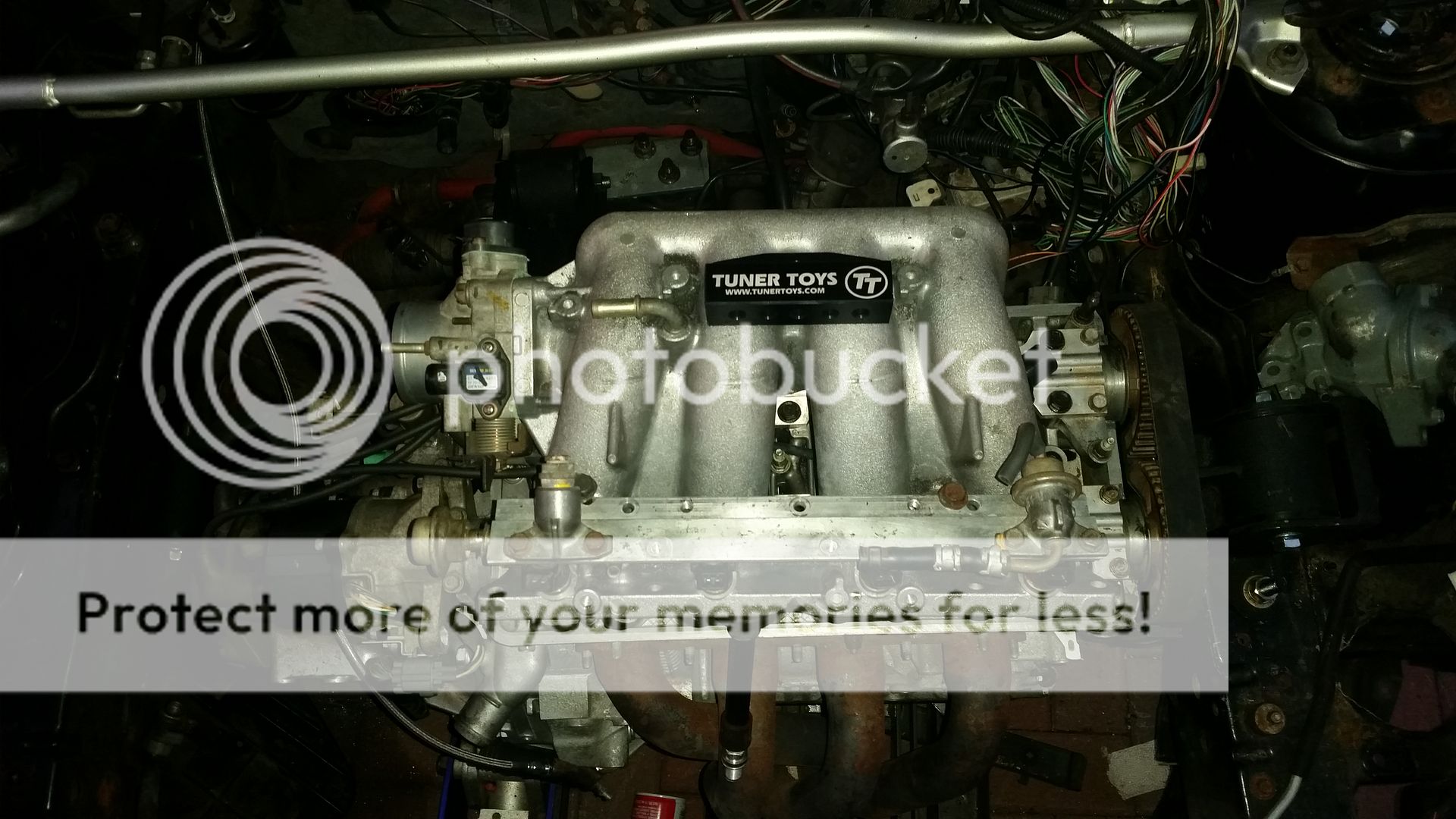

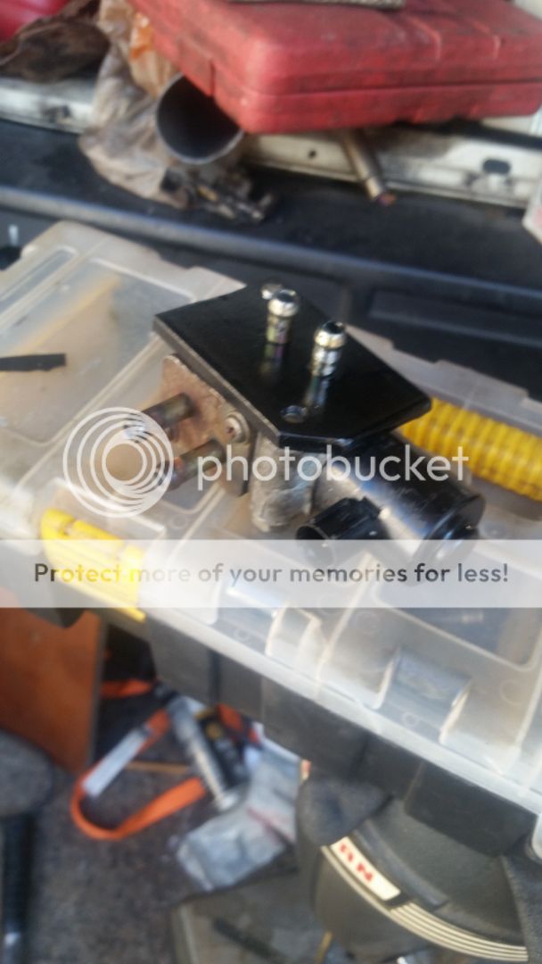

Iacv relocation

I still have a ways to go but so far so good.
