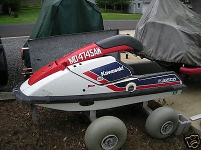

Cheap on ebay, doesn't run.  needs a lot of work  :yes:  Been so bored lately/dying for another project.
650 CC two stroke! on a standup!  Maybe turbo someday, surprising a lot of room in the engine bay.

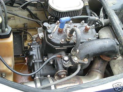

so I lied about keeping this thread updated, but now I've got the whole thing back together and running, well sort of.
Key points
-6 inches of salt water in the bottom of the hull from 1993 till now is a bitch.
-Had to rip out the impeller wear ring due to corrosion
-Used 3M window weld to glue the motor mounts back together
-Liberal application of sledgehammer on pistons to separate crankcase.
-Stockers came with 28mm carb, found out dude had upgraded the reeds, IM, and to a 44mm carb.
-rebuilt with new pistons and it started right up!
-got a new mikuni 44 super BN carb for it anyhow
Lasted for about 45 minutes, hard as shit to ride, but FUN, until my buddy bailed off on it and it drove itself into a boathouse and severed one motor mount.

It's all good, it's not fun if you have to worry about breaking it.  Actually he's a pretty good friend.  His parents have a house right on the water with a floating dock so I'm keeping the ski over there.
And last weekend when we got it started for the first time by dumping some gas down the intake (carb wasn't quite working) he went out and ordered and bought a brand new carb for it just to get it running, so he's allowed to crash it if he wants.  (new carb cost almost as much as the entire ski!) It makes for a funny story anyhow.
Anyways we got the motor back together today, just put bolts all the way through the torn rubber mounts so they can't separate this time.
Abaz how you like the superjet?  This is my first standup and they are a lot tougher to ride than I thought!  Fun though, just exhausting.
