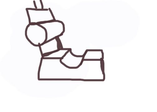

so i was thinking about making a little tubing maker.
for aluminum only.
twin50 son. get some

oh yeah forgot to add that it (the tubing) would be made from sheet metal.
figured you guys could assume that much but just in case. the tool would be made from heavy iron

you'd need a mamajama hinge and probably some hydraulic pressure behind it unless you're using aluminum foil

and also as soon as i bent it the sides would be perpendicular and hitting the handle. thus it would
have to be cut to the precise measurements before hand.
i was thinking of bending like 12 inch sections at a time. and welding the halves together.

Unless you are tying to make some ungodly large diameter tubing, I really do not see the point.
Simpler idea:
Press
Ditch the hinges and let your device become a set of dies.
An even simpler idea would be to employ the use of a set of slip rolls.  Then you could make all kinds of different radius rolls and even be able to create tapers as well without using an unnecessary amount of materials just to create the machine.

good idea. and with the latter wouldnt that eliminate one of the welds. making it a single seam tube.

The only reason you may want to do this is for oval tubing. But even then you'd need a very long "press", and cutting/welding sheet+round tube would be far easier.
