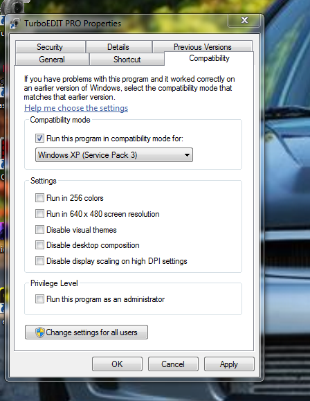

« Reply #4 on: January 02, 2010, 07:13:57 PM »
Right click on it. Go to properties go to this menu and select  windows xp (service pack 3) and click ok.

« Reply #5 on: January 05, 2010, 07:44:15 PM »
on my copy it just needed the uac turned off same as ectune, im running win 7 64 bit
