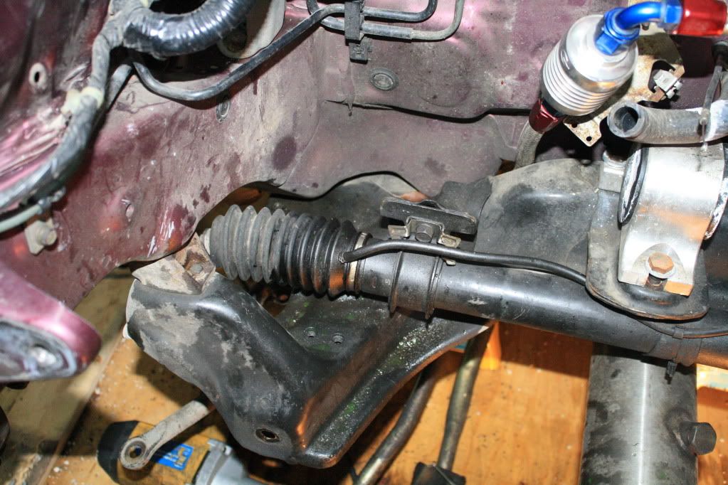

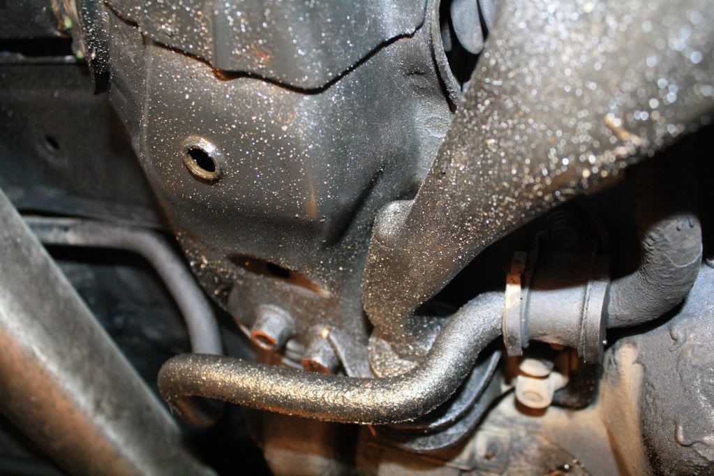

SO since I had to nigger rig my steering rack back in the day. I am fixing it. I want to know what my best options are for a lower ratio rack. Best bang for my buck.
I was thinking VX rack. Or maybe get some kinda JDM lower ratio deal. Ideas?
it used to look like this, I pulled everything out, am putting in new urethane kit. Getting some things powdercoated pretty colours. De-greased EVERYTHING

Yeah I fucked up the power steering reservoir, when we were trying to get something else out, or in. So we decided at that point to pull the power steering all together, and looping it just kept the shit out of the rack.
This was the thought process in my mind at the time.
