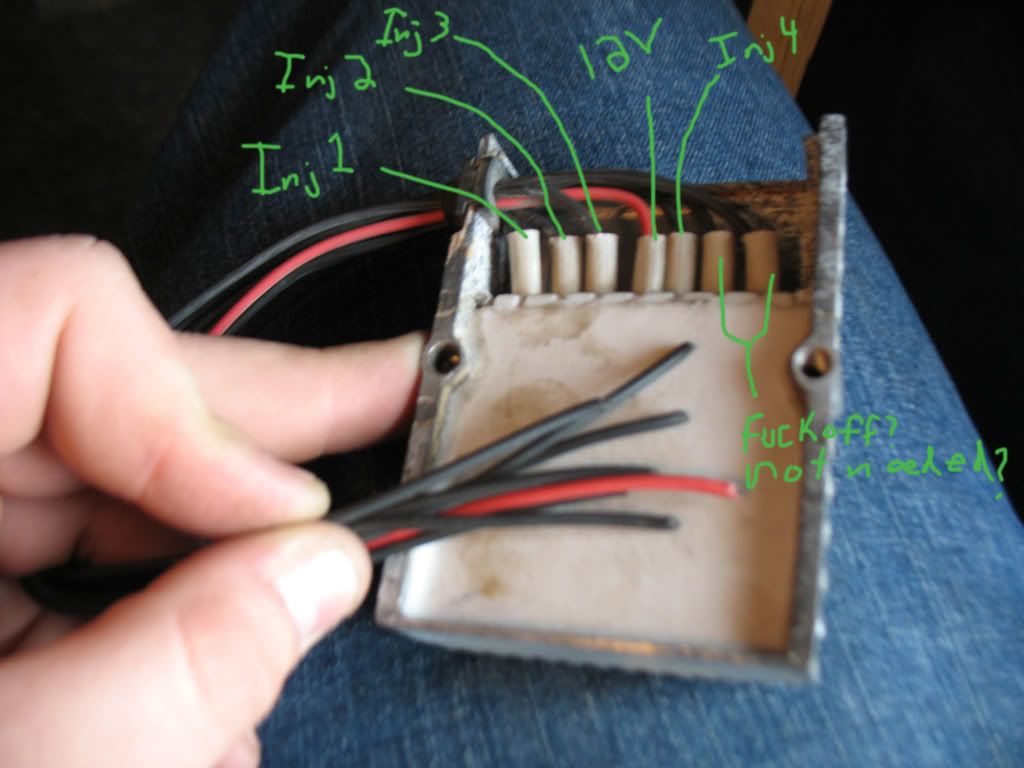

i got this resistor box out of an accord at the jy and it already had the connector snipped, im doing a mpfi swap.
i assume the red wire hooks to the wires that go back to the ecu, and you just use 'any' of the black wires to hook to the injectors?
there is 1 red and 6 black/identical wires

red wire goes to switched 12v. black goes to injector power supply
Re: resistor box wires
« Reply #2 on: March 31, 2010, 02:31:51 PM »
so the red wire goes back to the ecu, and any of the black wires goes to each injector?

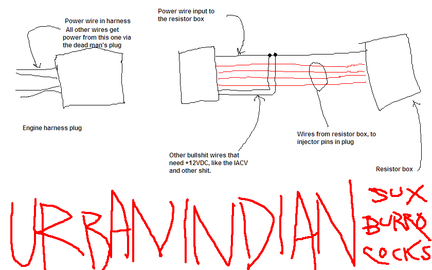

Yes.
I have my power wire hooked directly to my key ignition power.
The other black wires go directly to each wire for the injector.
let me find my diagram
found this picture?.....
current background
grand wizard diagram

UI's diagram isn't 100% accurate, but you still get the drift.
The +12V to the injectors is switched via the MFR if memory serves me correctly.

yellow black go to the main relay the grounds go back to the ecu.
so take all the 4 yellow black (+12V) wires and  twist together and run it to the red wire on the resistor box
<(looks like you have the one for an acura legend that is why is has 6 outputs)>
the run 4 of the black ones from resistor box back to injectors. and dont touch the other wires on the injectors they go straight back to the ecu.

For future reference & clairity: Injectors are constantly fed +12v switched on one side (yellow w/blk), via the main relay. The other side (multi-colored wires) run directly to the ecu, to the internal injector driver mosfets, which switch them to ground when they need to fire. It's kinda the opposite of how most electrical parts are fed, which is always grounded with a switch connected to +12v.
