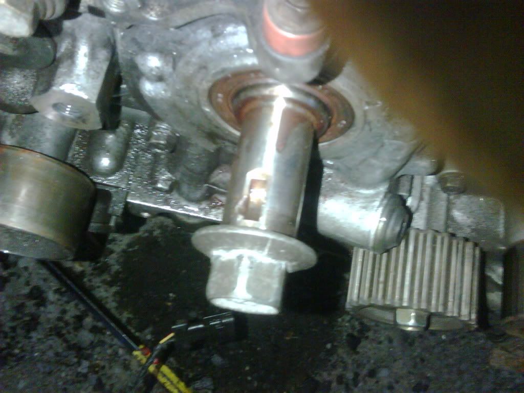

Ok so i just bought a Legacy off my parents, my dad had it tore down as soon as he noticed the wobble, its not too horrible but its still wore it out a little bit. My crank snout looks very similar to this one
Now my question is, what the fuck would you guys recommend to fix it? I was thinking of getting a new keyway, and just tack welding it in and trying to file it down so the pulley will fit back on there. Any suggestions?

Sorry need to clarify, the pulley itself is fine. Just where it wore on the crank, it lets it go back and forth about a tooth right now.

What does the nose of the crank look like.
Impact240sx
  • Posts: 173
Re: Fucking Subaru crank pulley wobble
« Reply #9 on: July 28, 2010, 10:58:02 PM »
About what the picture i posted looks like, a little more wore tho, not much but a little.
« Reply #10 on: July 28, 2010, 11:24:27 PM »
I can only see one picture, and there is a bolt in the way of seeing what the nose looks like.

Are you saying it rotates a little back and forth on the keyway, or that the pulley is not parallel to the block face? If it's the keyway, look real good at the pulley and make sure it isn't mushroomed inside. Any smearing of either will result in rotational slop. Replace the pulley if it's it, or fill and cut the crank.....or just weld the fucker. O0
Impact240sx
  • Posts: 173
« Reply #12 on: July 28, 2010, 11:42:05 PM »
Rotates a little on the keyway, back and forth (left to right) . Pully looks to be in good shape, no damage that i can tell .
« Reply #13 on: July 28, 2010, 11:46:39 PM »
How did this happen?  Was the pulley on there with no crank key, and it spun for a while?  Because keyways don't just develop slop.  The first stage of this wallows out the center of the pulley, the second part welds material to the snout so a new pulley won't fit over it.
I'd try a diff pulley before anything, but maybe I'm missing something in the picture.
Stop being a pussy, WELD THE PULLY ON!
So if it's not wobbling like a bent wheel - just flops around between timing marks - welding the keyway back up should fix it. I've seen Honda guys weld the crank keyway when their key sheered. If the crank snout is bent off it's axis, it's junk.
When I went to find a vid, I found this. I was gonna say this is the wobble you'd normally replace the crank due to, however it seems even this wobble was due to a bad key:

Usually, runout in this situation is caused from either under or over (usually over) torque on the screw which deforms the axial face (the nose). Without fixing this, you will solve nothing. Other possible causes are poor material selection (not likely) and radial surface inconsistancies (really only going to happen if you hit it with a hammer).
Everyone needs to stop thinking about the keyway. It has fuckall to do with the problem.

Im going off of NASIOC. It happens alot from what i read. Im just gonna get a new key and weld the bitch on, then torque it down to factory specs.
« Reply #21 on: July 29, 2010, 01:55:36 AM »
Its still going to wobble. In fact it may even wobble worse. The key only keeps the pulley for spinning on the crank, it has nothing to do with runout.

I've got no clue what to do then, need to get this POS back on the road ASAP tho. I just looked at the pulley, no mushrooming or anything where it came loose, its fine. They key was messed up for the keyway, and its got a lil wear to it like the pic.
