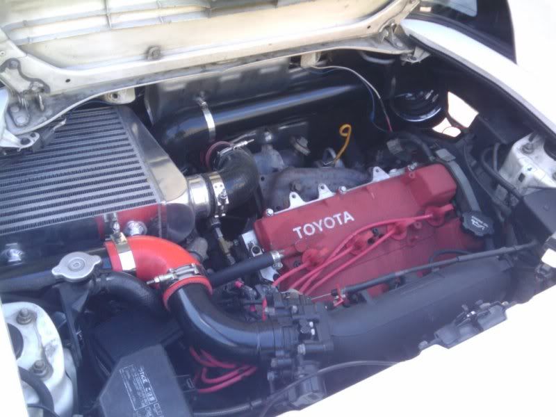

MR2 has:
powertrain
- stock cams, pistons, rods, exhaust manifold etc.
- TD06-17c turbocharger from a GMC syclone, ported to hell/ weir racing adapter plate
- 2.5" charge pipes with JB weld beads, JBwelded TB inlet.

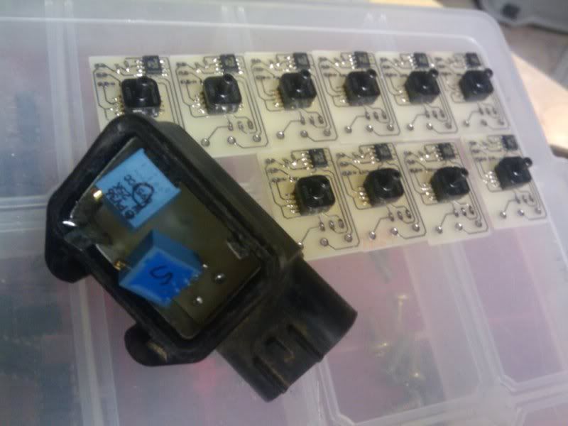

- 3" berk exhaust that i got for almost nothing by making some gen3 MAP sensors for them

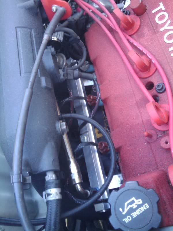

- wrx decapitated injectors/celica 3SGE top feed fuel rail/S4 fuel filter/whineboro 255/E85 fuel
- celica 3SGE side feed intake manifold
- ebay intercooler core w/1kCFM fan mounted by driver's side vent
- deleted blowoff valve
- TVIS controlled by boost pressure for spooling moar fastar.
- Accord distributor/Integra P75 ECU chipped with crome running the engine/2.5bar MAP sensor running 20psi of boost (i need to order more 3bar sensors so i can turn up the boost)

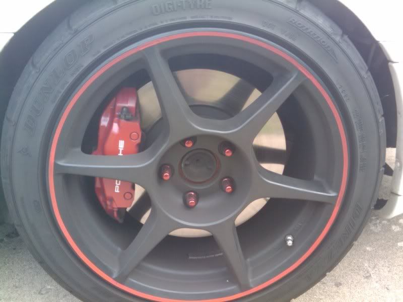

- porsche 996C4 calipers on supraTT discs up front, 88 fiero calipers on rav4 discs in back

fuel rail:

home anodized caliper and throttle cable brackets:

indeed it is. easy as fuck to tune. drives far better than it ever did on the toyota ECU. starts faster, throttle transitions are smoother, etc. even with the E85 i'm still getting 25-27mpg on the highway too and i've done a couple of road trips this summer and had no problems finding stations within the range of my gas tank. this is the ECU that should have come on these cars from the factory. plenty of kids swap over to the gen3 ECUs, which are speed density, but the MAP sensor for that ECU alone usually goes for $200+. so i figured out a way to emulate them for about $15, got a vendor on board who had parts that i wanted... ????? profit.
i've been intending for a while to get rid of the distributor and switch to coilpacks/COP too. the electronics are designed, but i haven't had a chance to test them. jaredkaragen posted over on the ectune forums that he has all the components now, but for some reason i can't post there anymore to help him out with it.
