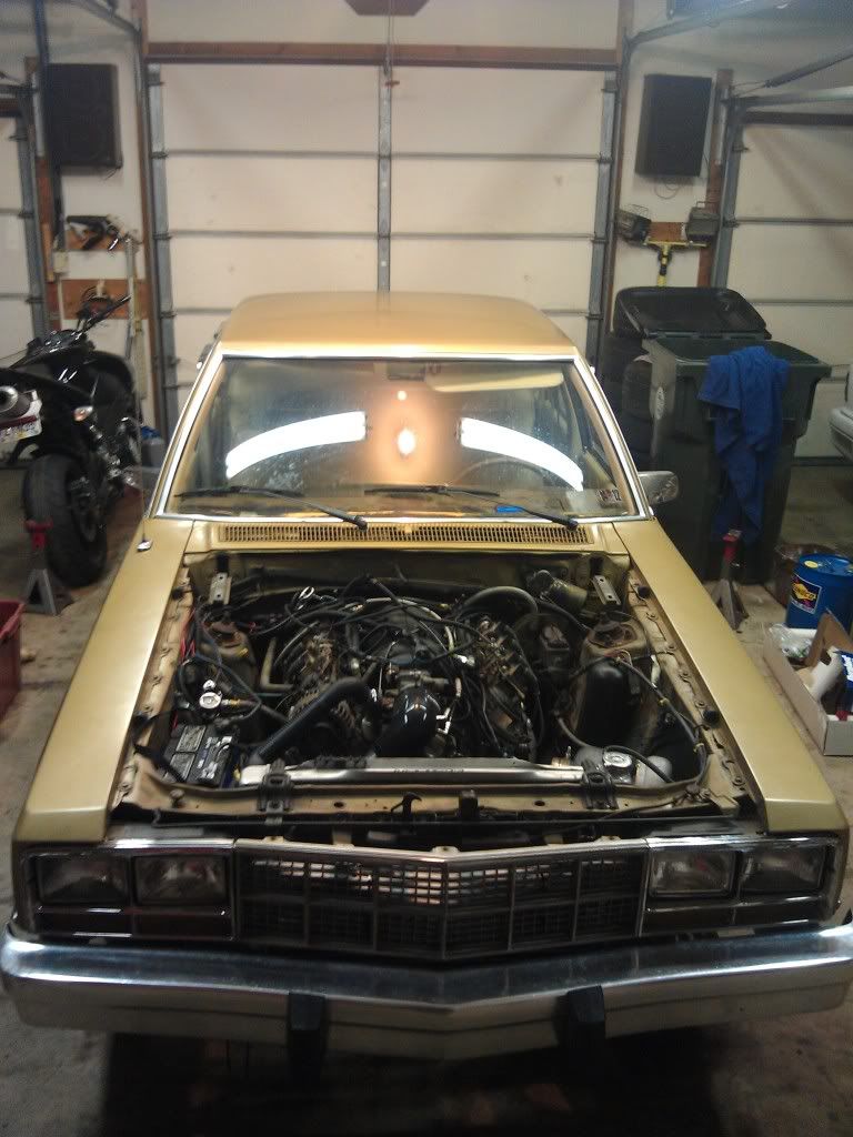

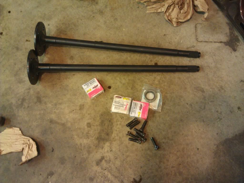

originally a 79 with a turbo 4.8, i wrecked the car after it spit an axle and i spun it out

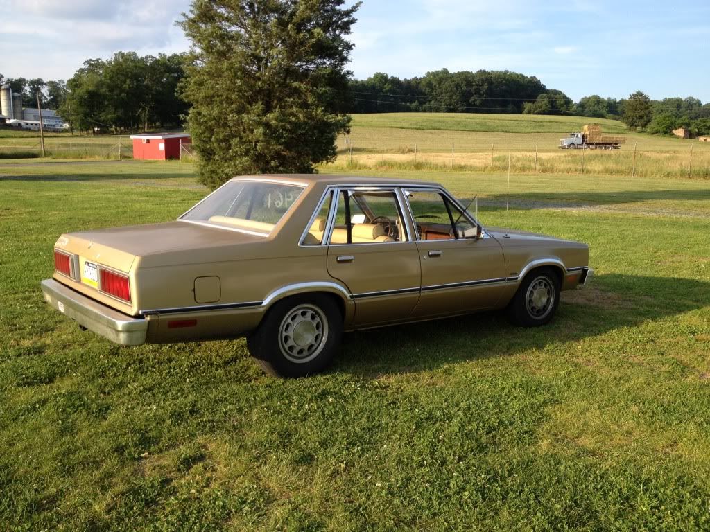

here is the 82 i built immidiately after the wreck, then i put a 5.3 and a larger turbo on, lots of changes in only a few months.
day i bought it, 68k original miles one owner
window sticker in there with all the original stuff

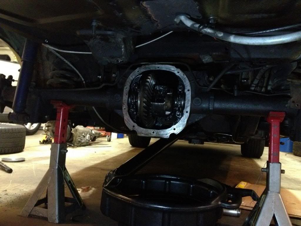

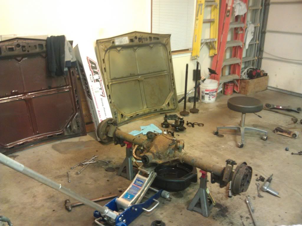

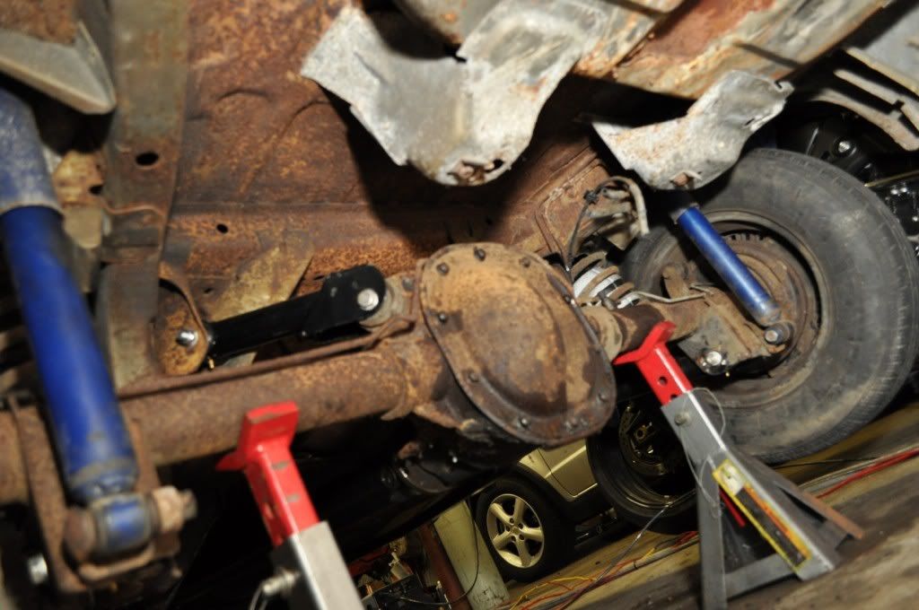

built a 8.8 rear someone had laying in their backyard

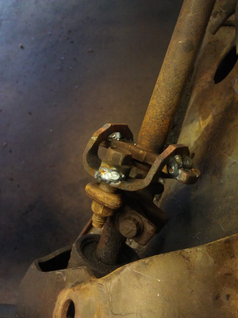

steering shaft bushing was gone! shot to shit, one at the auto parts store didnt fit so i welded mine

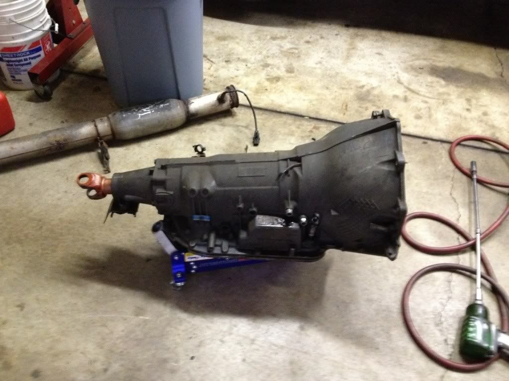

dropped in my 4.8 and th400 at the time

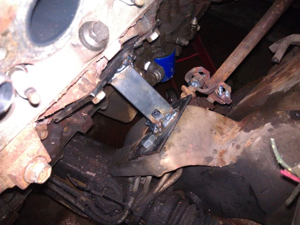

built motor mounts
fresh 8.8 with summit upper and lower control arms and stock springs, with a childrens football in the right rear spring

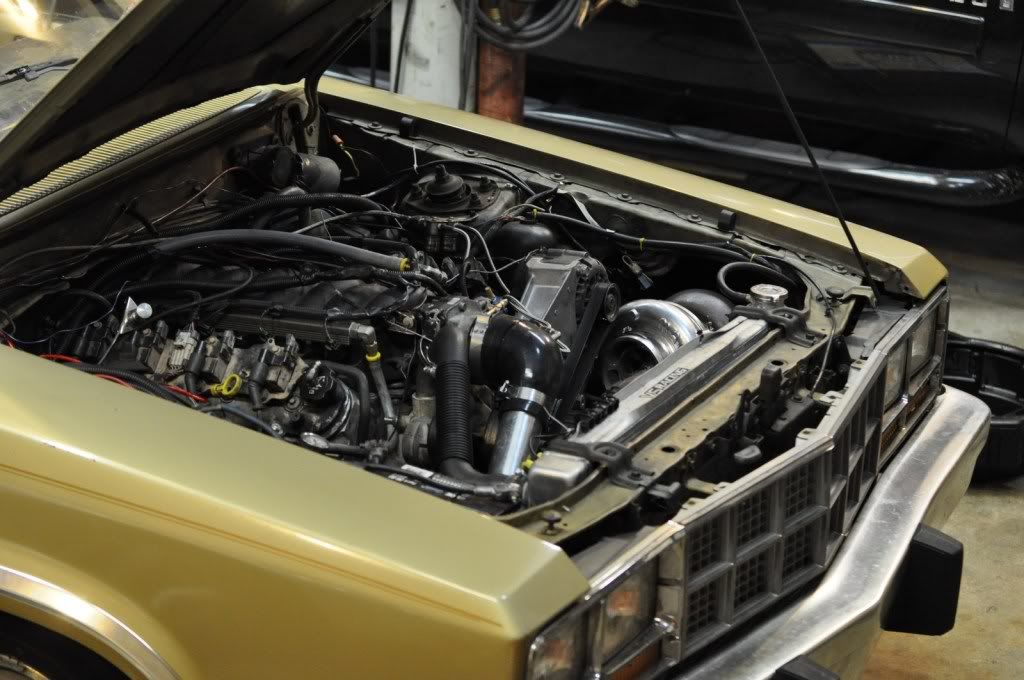

this was a 4.8 with a GT45 turbo, and th400, 2.73 rear gears and my converter had about 40% loss on high boost lol
car still went low 10s many times.
drag radial and street tires up front, drive to the track and run low 10s and drive home
i eventually installed an 80e and 5.3l and then swapped to a 80mm turbo...

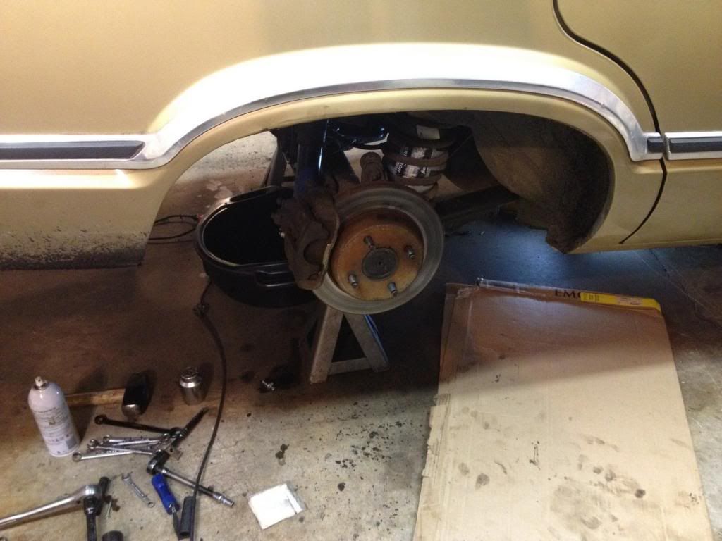

then i went 3.55s and threw disc brakes on the back

Why did ya stick with 8.8 and not a ford 9"?

I love it! I really like how it's all done on a low buck budget. What are u using for engine management?
I have a Mustang GT and thinking of converting rear disc, and I keep seeing people doing 5-lug conversion.
How come you didn't do the 4 to 5-lug conversion?  :noel:
the 8.8 drops in stock, its cheap and light.
the 9 inch is expensive and heavy and i would have to get mounts and shit to swap it in.
same thing with the 5 lug, why swap, 4 lug works great.
microsquirt2 v3
fuel and spark
reading the stock crank trigger
