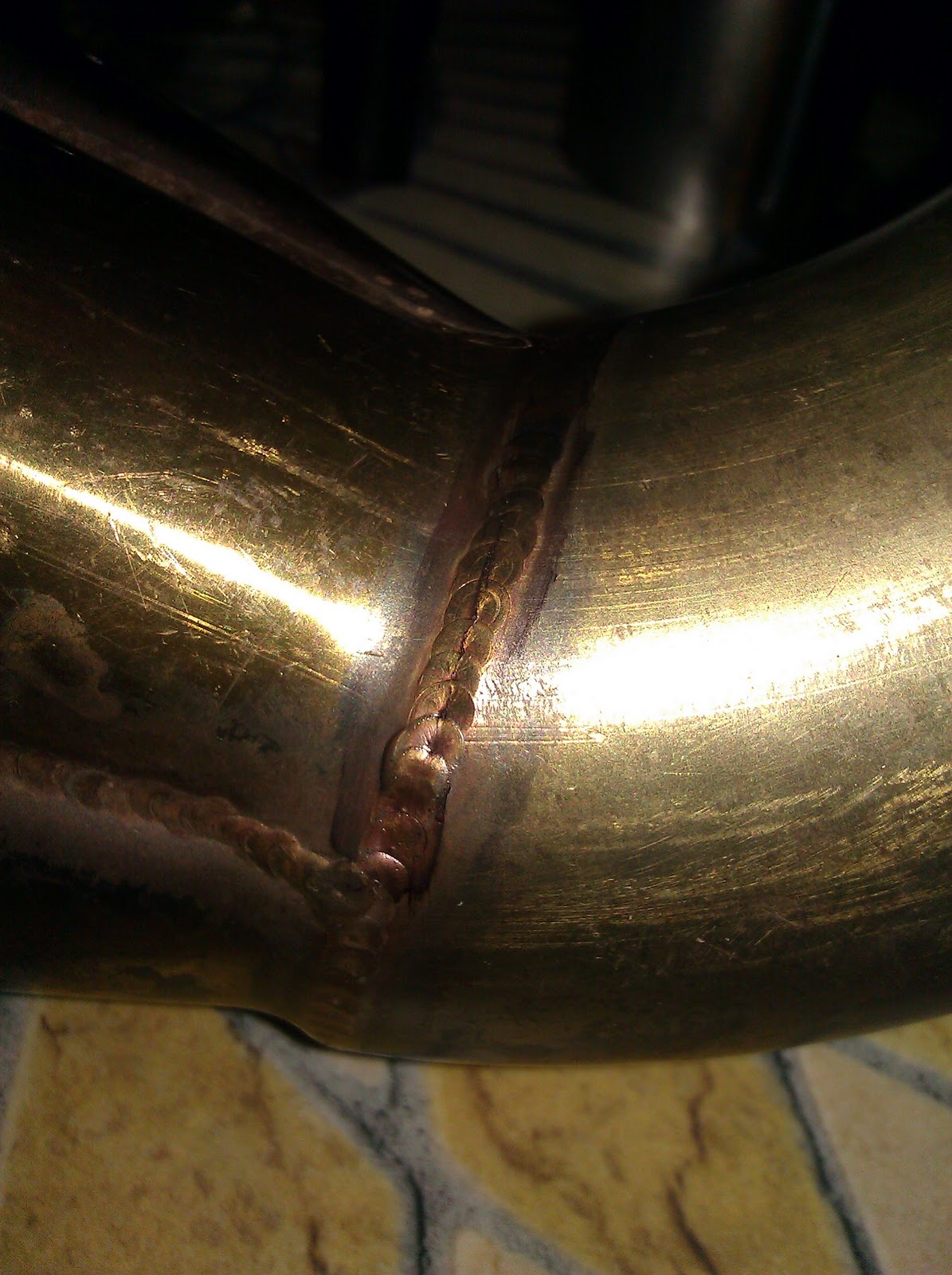

I took three cones (two low angle, long divergent cones and one high angle short convergent cone), one busted Bisi header and mashed them together by cutting the header back to the goilette point, cleaning up the inside of the collector, then pie cutting one of the cones to wrap it around the pan, and then welded the other two cones into a megaphone then sized the joint to match the larger of the two primary sizes. There are a crapton of pics on my fab blog, if you prefer to see them vs. my poor short explanation.

The other part of the downpipe just completely fell off, and this ^^^ "aesthetically pleasing" weld was next to break even if re-welded.
Justin actually wanted me to just re-re-re-weld the header, but after getting it in my hands, I refused to. I didn't want to cut the effer apart and and weld over already smoked metal. We discussed some other options but then he decided to let me modify the downpipe to try to extract some actual decent performance out of the header, which never was very impressive to him in the first place. I've been wanting to experiment with a small choke header for some time, and he agreed to be the guinea pig. However, neither of us actually expected the dramatically different tone (which sounds effing awesome, IMO) and performance gains. He has more torque everywhere and it doesn't fall off much at all, where before it would nosedive after 7K.
