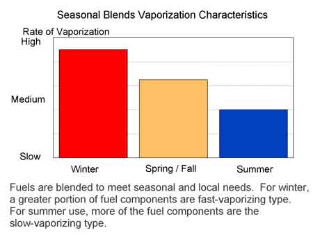

so figured I would ask if you live in the northern regions if you have had issues or notice differences when tuning turbo cars with summer blend vs the winter blend of gasoline's

Didn't know there was winter gasoline. Winter diesel yes but didn't know about gas.

I'm using Petrocanada 94 in the winter for the Teg and haven't notice a difference really. I know there's additive in the 94 but it works well for me.
The motor is a b16b (10.8:1) @8psi and no problem so far. Winter or summer.
I also didn't know there was a winter blend. That's a fact or you think there's a blend?

i have heard that it affects afr a bit but I was wondering about hp affect it might have
