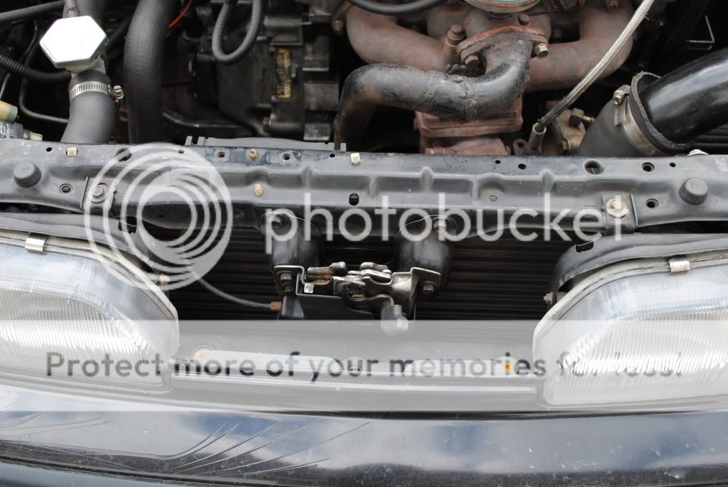

« Reply #66 on: June 10, 2012, 06:04:57 PM »
I ended up doing the samething, but aren't you worried about the lack of support now that there's no lower radiator support there?
I did a 1"x2" bar going across the front.

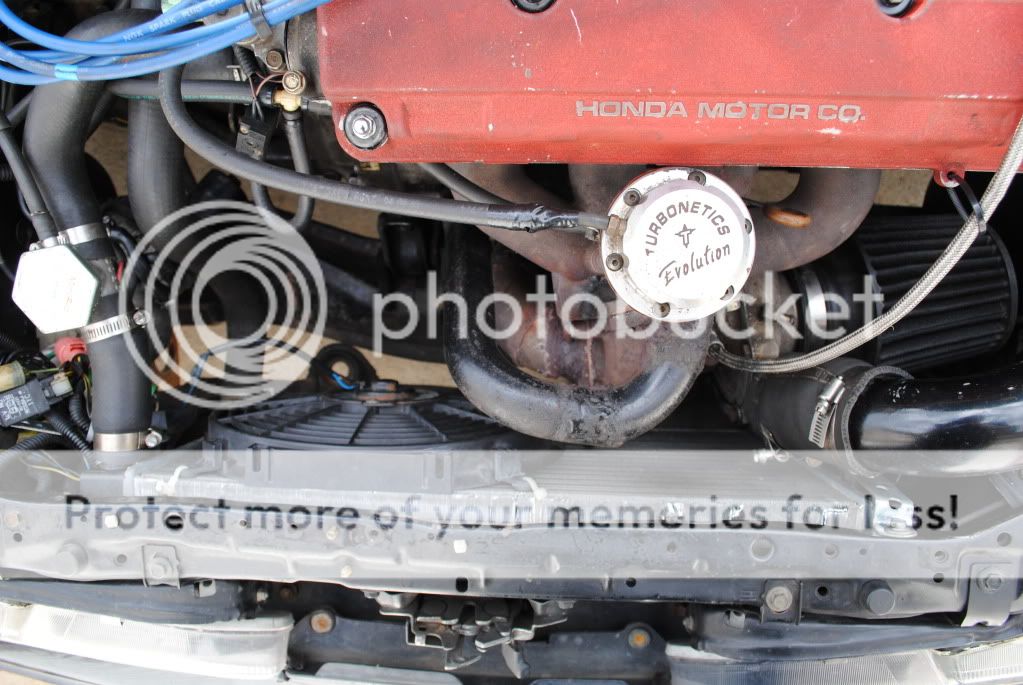

Hi! im in the point to adapt scirocco radiator, my question is about what hoses should i run because i want to use a silicone hoses.
I assume stock D series hoses will not works, does it?
One first page "I used the stock 91 teg lower radiator hose and it worked perfect. For the upper hose I used 1 91 teg upper hose, and a piece of another teg upper hose."
Also used an inline radiator filler for the upper hose.  :noel:
walter
  • Posts: 2931
mi engine is a D16z6  :-\
walter
  • Posts: 2931
nop, upper is different , inner diameter too, time to fab work.  :-\
