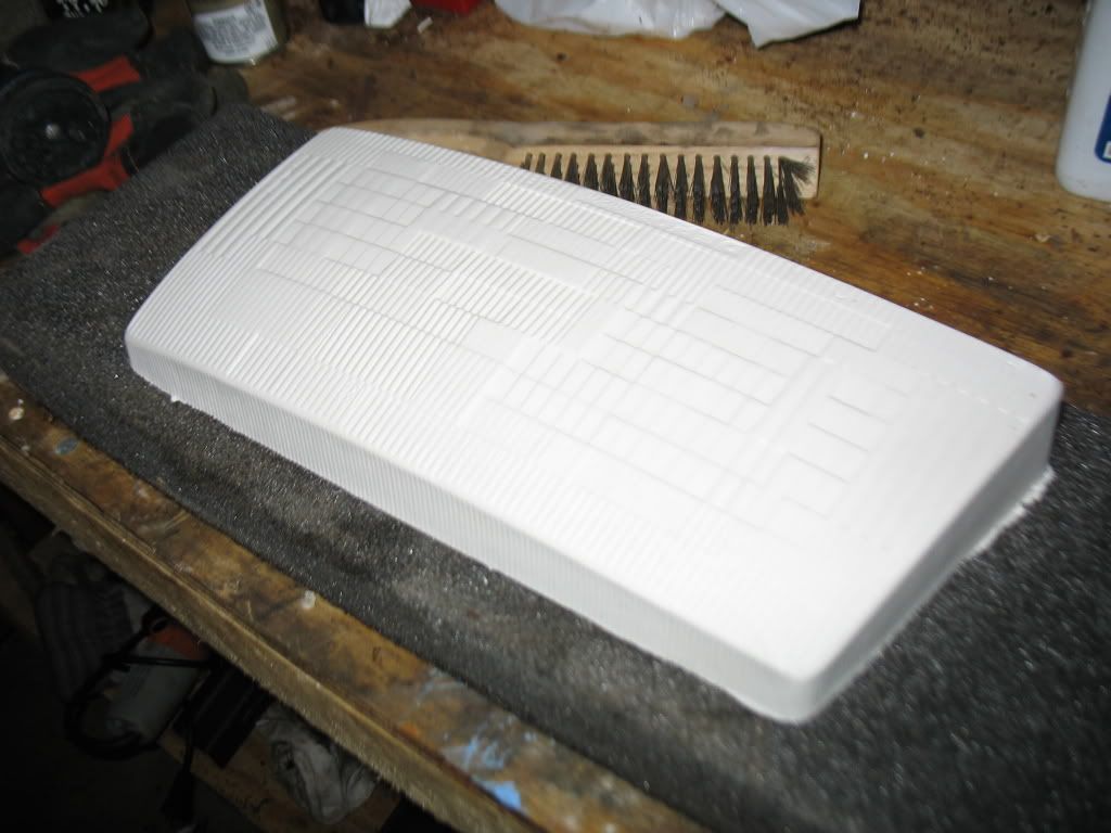

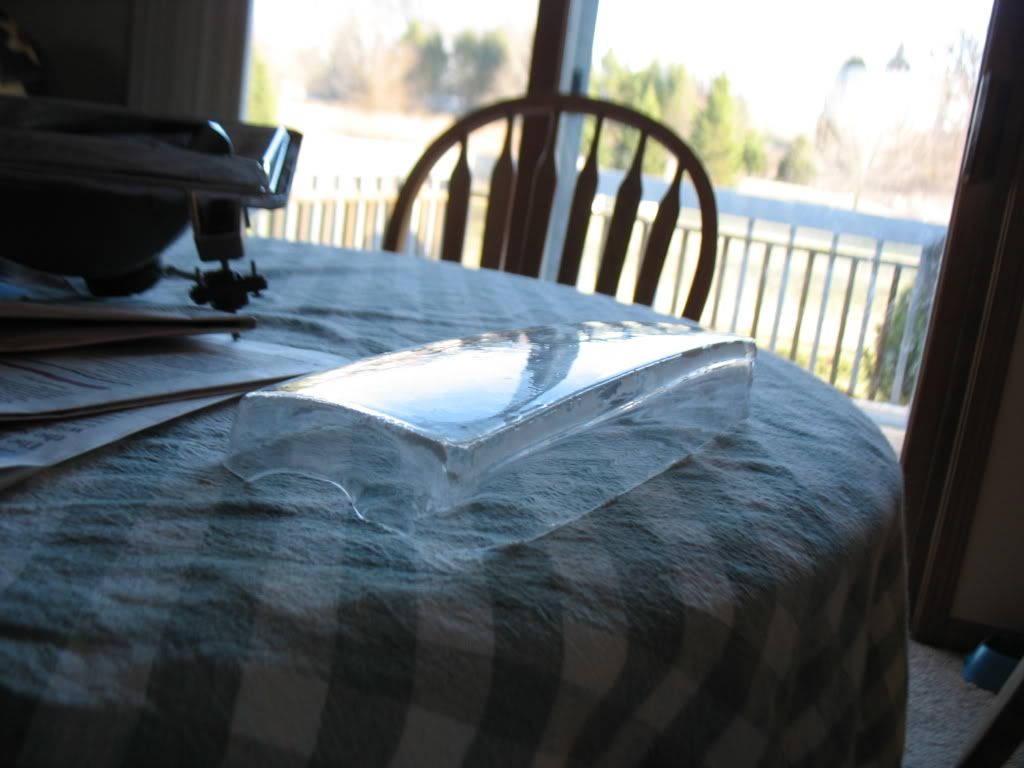

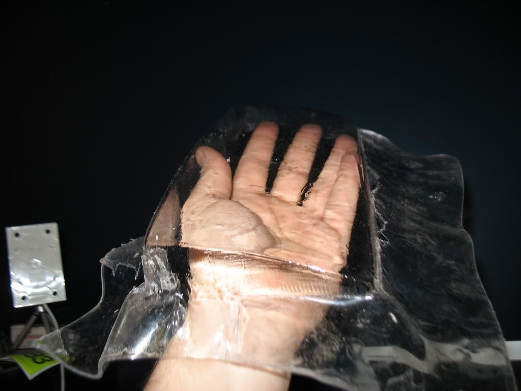

dude trust me its not worth the effort, i spend about 30 min sanding with a power sander and i didnt even make a dent in the fluted. i tried very high grit metal sandpaper >15k and some like 200 grit and it doesnt make any difference.
i am making my own lenses out of lexane using a plaster mold and a female ring
here is one that is almost 100%. the plastic is specifically meant to not yellow in the sun, check the label.
mold
some failed attempts
mold

no i made a fram out of wood, screw the plastic to the frame, heat it up in oven, pull it out and put it over the mold, push down with the female cutout.

yeah i built a vacume box but it was total fail, pressing/stretching the lenses is way easier
