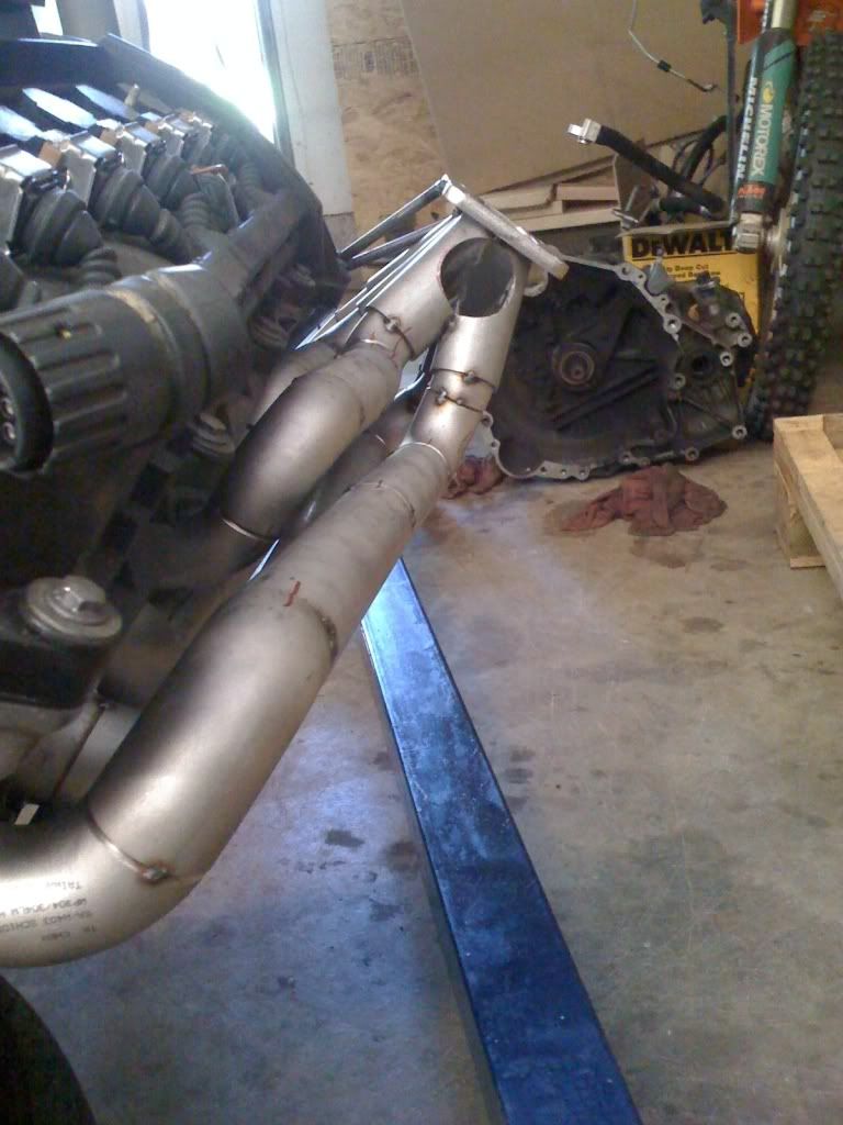

how do you  :mexi: cut large nice holes in odd shaped pieces of metal all nice like this
nice metal hole saws in a drill press or what?  ive tried some fucked ways of doing it that ended up me cleaning and rounding the hole for a fuckin half an hour.  and these "bi-metal"  hole saw deals are all they seem to sell at stores and they look like they have way to large/few teeth to work for shit
i need to cut some 1-2" ones and a couple 3.5" ones
