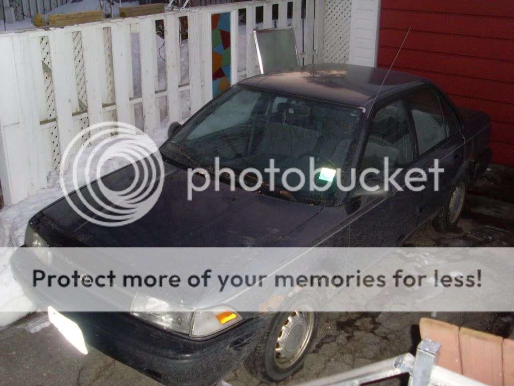

#1 1991 Toyota Corolla NAVEX/Rallycross car.
I got this car for free a few weeks ago, and hadnt really decided what to do with it. Originally I was just going to make a turbo kit ... rip it for a bit, the nsell the kita and scrap the car. Then I decided to do the kit and use it for Rally Cross instead. Now, after doing the Maple Leaf winter Rally, Im going ta make it a RallyX / NAVEX car. The only REAL difference is that the turbo setup needs to be a little more reliable and it needs to be certified/etested. Other than that, everythign else will be more of less the same.
The car is a 1991 Toyota Corolla DX 5spd. Rear qt's are kinda rough, but overall its a mechanically decent car, so aside from patching some holes, the cert should be a breeze.

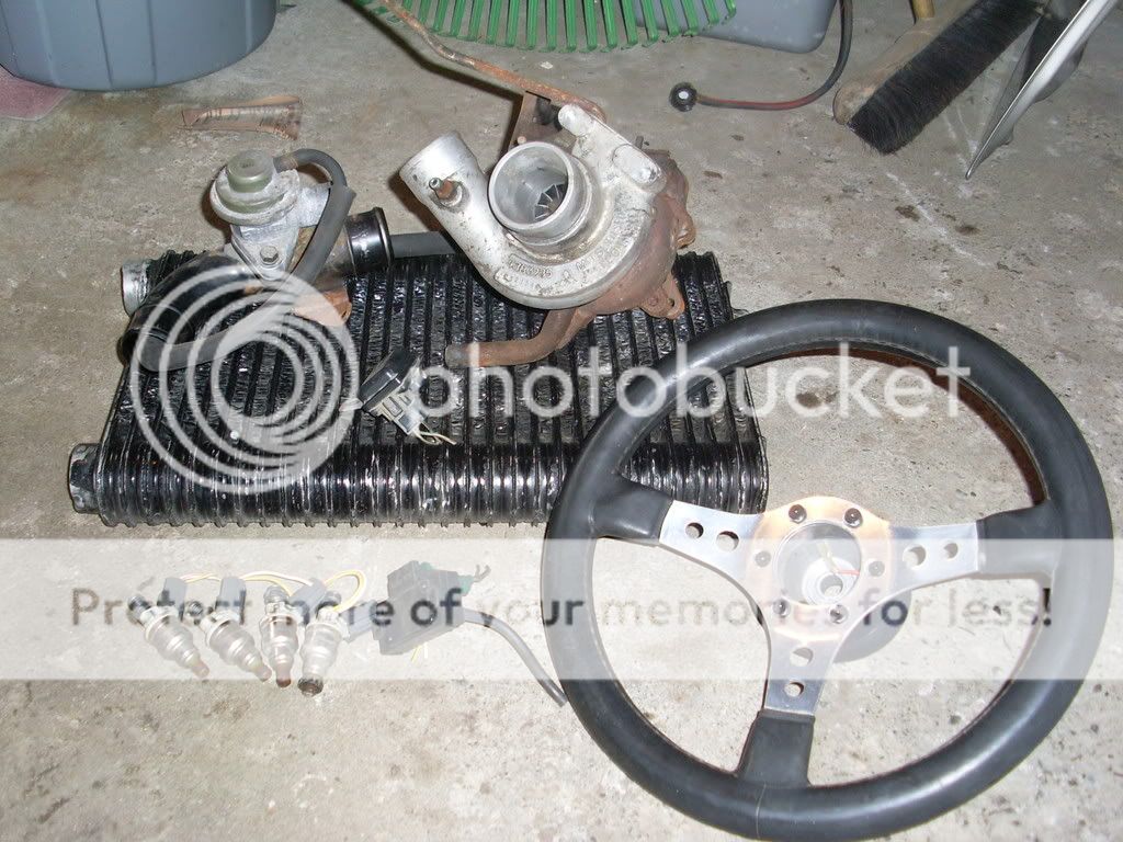

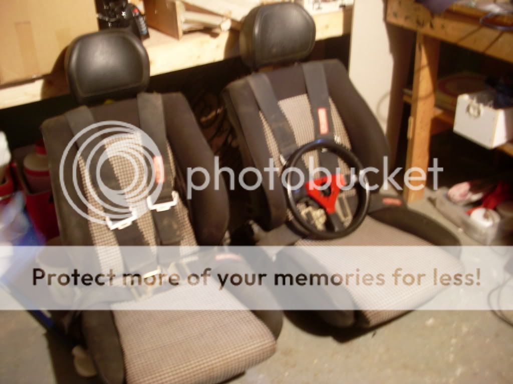

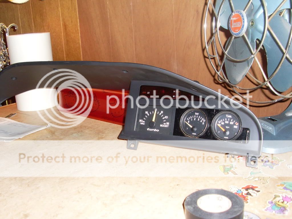

I just finished up all the interior stuff (except the "night pannel"), so Im going to start in on the manifold hopefully tomorow afternoon. I know it seems silly to start with the stuff inside the car, but it was cold and I was able to do it inside. For a change I decided to make it look as clean and OE as possible .... at least inside the car.
I got some 2" els from Weir on thursday so now Ive not got an excuse anymore. Im just going to make a braket for it that makes the "sinklog" bolt to the block, so all the load isnt on the pipes themselves, or the exhaust studs.
Oil lines will be brake lines, with exhaust pipe charge pipes.
The GM map sensor should look after most of the fuel curve (up to 15psi anyways) but I still need an AFC to pull a bit of fuel at the bottom end.
200 whp should be fairly easily attainable, and should be lots to move that thing around.
Cant wait to see the cb7 get hooked up...

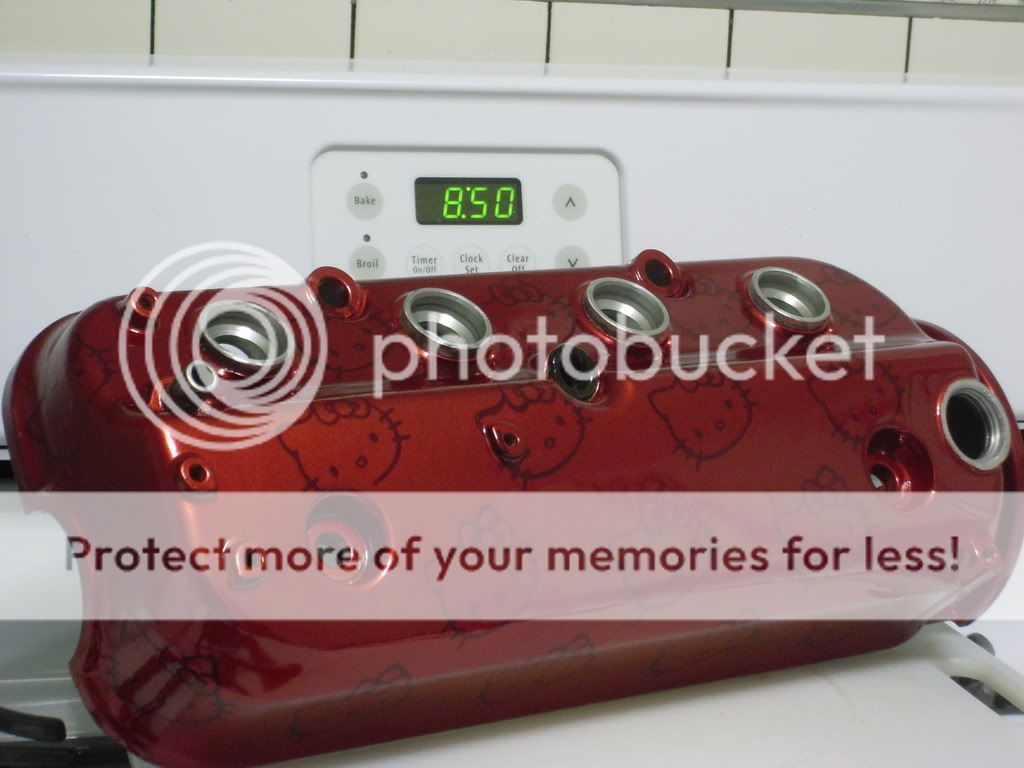

....oh...... and this
te04h for the loss... up-grayyy-deee that shit  :-*
AstroVannin
  • Posts: 625
I thought it should be fine for the Corolla ... its only a 1.6. I used the Garrett version of the Daytona turbo on my Tercel and it seemed to work pretty well.
What do you see as the issue?
  • Posts: 6862
What is up with the valve cover?
Why the kittie thing?
AstroVannin
  • Posts: 625
I dunno, I just picked it because it was totally random.
Ive got a bit better layout for the next one.
