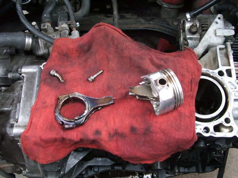

long story short, My brother bought a rex (police impound) it had a built engine, whoever built it didnt do a good job, It spun a bearing and blew a rod through the block during the break in period.
THe damage, hole through block, hole in oil galley. broken eagle rod, and shattered arias piston, chewed up crank.
The sleeves are still good minus 1 that has a few scratches, hoping to have all the sleeves bored over to 84mm (currently 83mm). They look like they are darton sleeves.
I just fabricated a tool to extract the sleeves and i tapped them out myself. My question now is besides a small nick at the base on #1, the sleeves are still good. Can they be transfered into a new block? or would there be issues? Keep in mind its getting bored out 1mm.

you shouldnt have a problem. make sure you have the sleeves pressure checked though you might no see anything but it may have stress damage.
