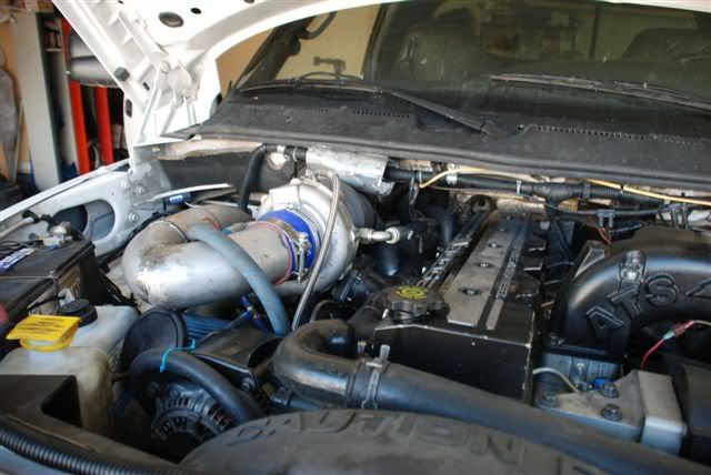

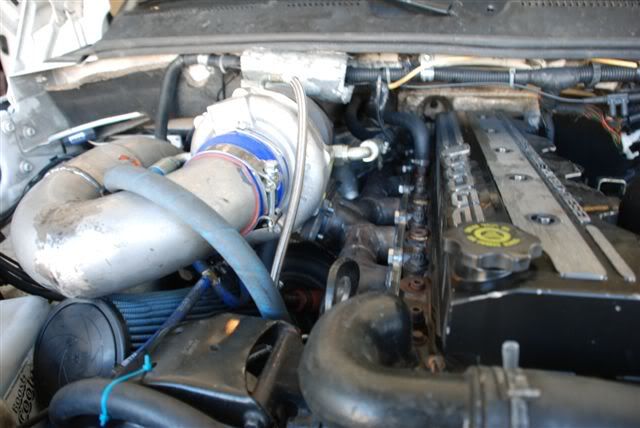

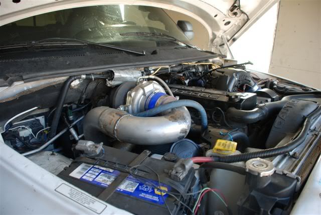

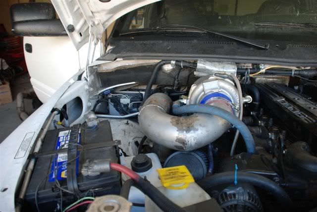

Here it is on the truck, twins installed. Got it started up today, but didn't make it to the dyno event in Red Deer, we fought an oil leak off the primary all morning. The truck is supposed to attend another dyno event in Oct. While I am away.
*** Note I did not fabricate the cold pipe, or take this set of pics, the owner of the truck did.****
The turbo's used in this setup are a GT3788R T3 (with an internal gate, that we will be replacing for an external one) Over an S474 T6.
The owner is shooting for 700whp+ on #2. He made 680, on a slightly smaller slightly less efficient setup.

Why?
Because I was asked / paid to.
I figured that much, is it just because he needed t4 flange?
Re: I had 3 beers and tacked a splog, Then I drank Whiskey and finished it.
« Reply #36 on: September 26, 2009, 11:18:57 PM »
Nope it was a T3 flange. He just wanted to try something else. The owner has a stock 24v mani, and an ats mani. I think the biggest reason is that we will be adding an external gate to this, and he really didn't like the idea of that spacer deal that E.D does, especially not for $1000.

I see, adding external gates to cast manifolds isn't favorable.
Your fab has gotten especially O0 ish there buddy. :yes:
