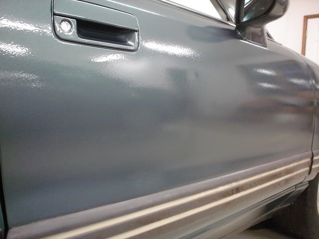

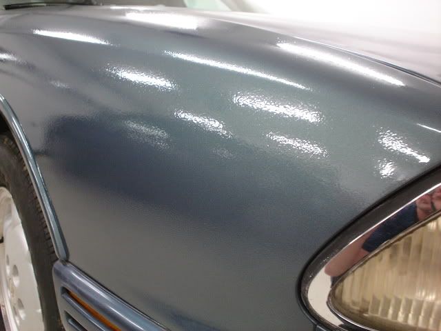

Painted the car in the driveway.  Now what am I supposed to do after the clear coat to finish it off?  Sanding? what grit? Buffing? what buffer, pads and polish?  Its a base coat clear coat using Sherman williams paint.
Paint in all its orange peel glory:
At least its better then Before:

defanitley time to wet sand. is that all in the clear or in the base coat also? if the base was liek that before you shot the clear then you might need to do alot more then wet sand.

That looks like a Reducer issue. But nonetheless, wetsand with 1000 grit using a sanding block, and then compound it with a lambswool pad or a foam pad. After that, you will need polish with a foam pad. Then wax is the final step.

I hope youve got ALOT of clear on there, thats gonna take alot to make that smooth

It hard to tell by the pics but it dosnet look like u got enouf clear on it. Thats pretty bad, start by wet sanding it with 1000 grit and see how it looks. ur not going to get all that out but u might make it look somewhat better :?:

  It's "clear" to see (big pun?) that the clear didn't atomize out of the gun correctly. I think you'd be good to machine sand with a light grit to get the surface more flat, hopefully without getting into the color coat. Play with the gun settings, and spray clear again.

I go to my local Auto Paint Supply and pick their brain. Find a good store and show them your gun, paint and reducer.
Temp and humidity are important factors in the final product, so, when choosing a reducer, tell them what climate you are spraying it in.
Re: Painted my car, now how to get rid of orange peel / after paint what to do
« Reply #20 on: December 05, 2009, 12:45:30 AM »
Jesus christ.  :o
+1.
Find a piece of scrap to test the gun settings on before you spray again.

1000 grit, 2000 grit, 3000 grit. wetsand. polish and then was using foam pads.
other than stripping the car, only way to get it decent.
New cars come with some orange chicken peel, moms Buick is getting a new hood thanks to Bambi and it is a PITA to TRY to match the OEM orange peel!

some serous orange peel could be a mixture of things.... reducer, gun pressure, gun, elapsed flash time, and such.... but fuck  for what it is the color matches looks great  :noel: I wouldnt put the time into cutting and buffing just my personal opinion because when u get half way through and pissed and quit it looks even worse cause its half done...... just get it a little dirty she will look like new :yes:
