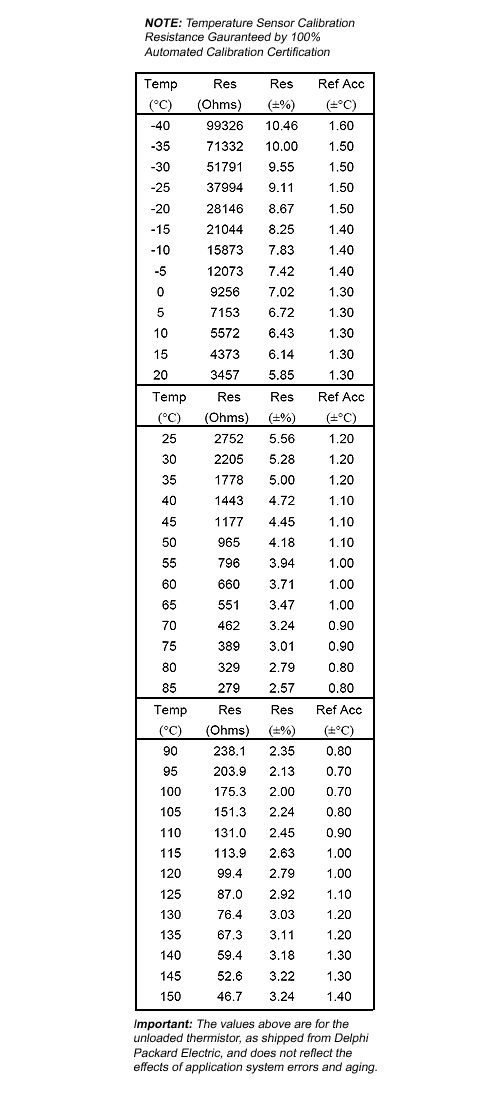

What is a good cheap linear temp sensor i can use to measure the changes in my IATs, something with a data sheet would be stellar.

GM AIT sensor.

radioshack used to have thermistors, not sure if they still do.  Weren't real linear, but they did have a conversion table on the back of the package.  Adequate range for IAT temperatures.  Could get em from digikey or newark.

GM IAT Sensor #25036751
GM IAT Sensor Pigtail #12102620
now wheres the tech sheet.
