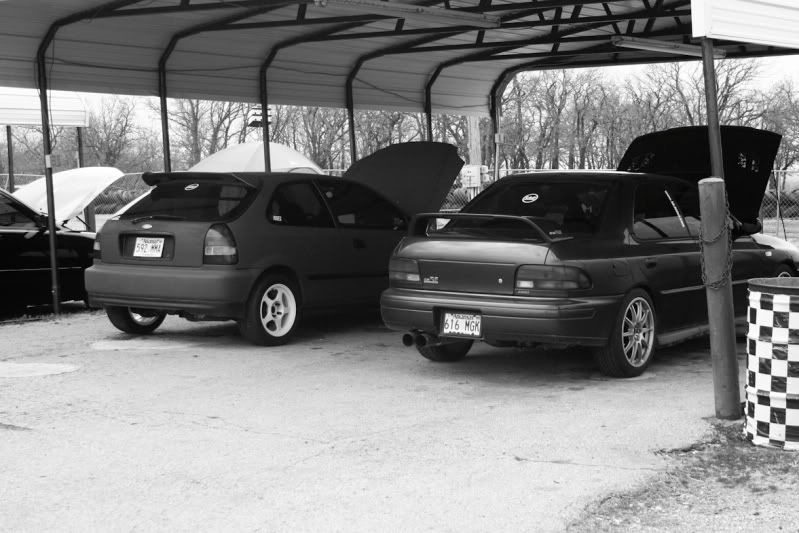

Just a couple from this weekend...
I had an absolute blast this weekend.  The ecsta v710s are grippy as hell with some temperature in them.  I desperately needed more power for the straightaways..I was pulling away from a new GTR in the turns, but then the straights came up and it was game over.  The only problem I had was I smoked the hell out of my brakes.  I need to figure out some way to keep from doing that, that doesn't involve not using the brakes.
