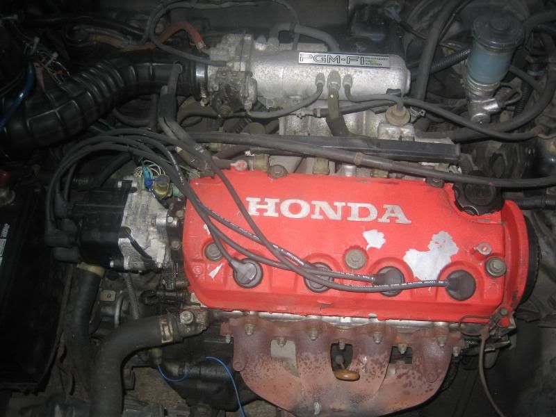

Remember my old 3 + year build?  found out the car has a junk title.  parted it for this bad boy
here is a link to the old thread
http://www.realhomemadeturbo.com/forum/index.php?topic=2785.0
There is how the car looked when I took it home.

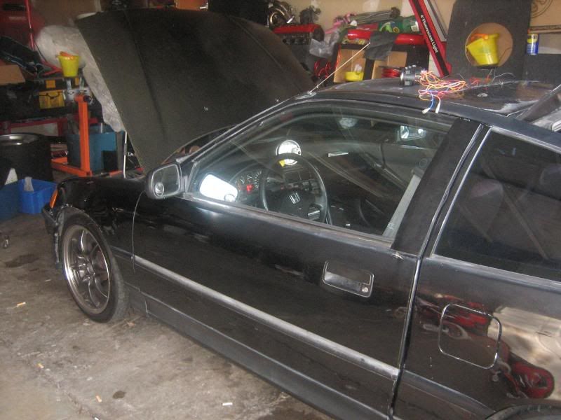

91 black crx si
THE GOODS-------
GC and Tokico blues
Carbon hood
15"c8s
stock a6 block with y8 head ( i did the swap on this car 3+years ago)
Vtak is activated thru a relay and off of the shift light for in the cabin adjustability
ACT full face disc with HD pressure plate.

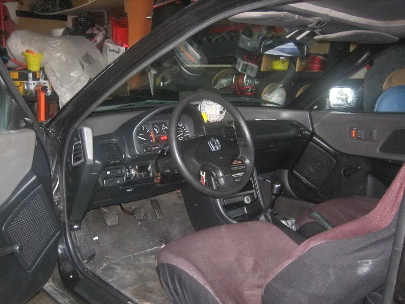

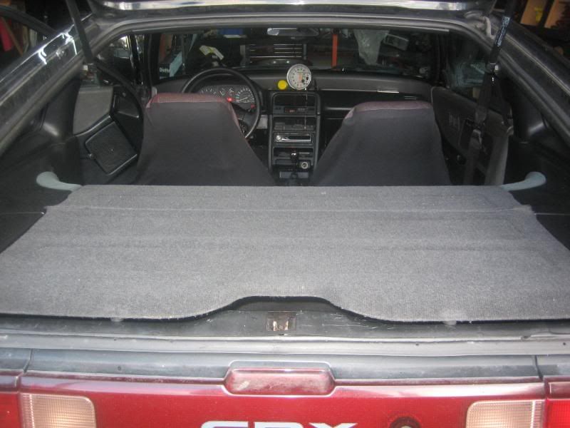

Sunroof still works, clean interior.  Even the rear cargo cover isnt even broken.
BADS-----
Paint is faded, pass door has hella dings, front crank seal is starting to leak.
This setup will consist of the same motor, trans, and clutch
CDM cast manifold
CDM wastegate
CDM 2.5 outlet GAY DEE EMM interfooler.  tube and fin
FIC 850CC injectors
walbro 255
b&m fpr
Real Fucking Loud BOV
2"hot side, 2.5 Cold side ic piping

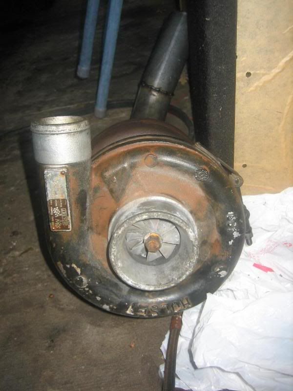

Big Holset h1c 18cm2 housing
PBT 74mm TB, Spacer, ported z6 intake manifold
Stevemode oil lines
my Tuner Toys water port adaptor, map adaptor, vacuum manifold.  (limited edition shit)
will be converted to OBD1 after I smog and before I boost it.
This setup will not have my up-pipes with it.  Have to make it look somewhat streetable.  Going for 220 to the wheels with this setup.  When it does blow, I will be going with a stock b20 and high boost.

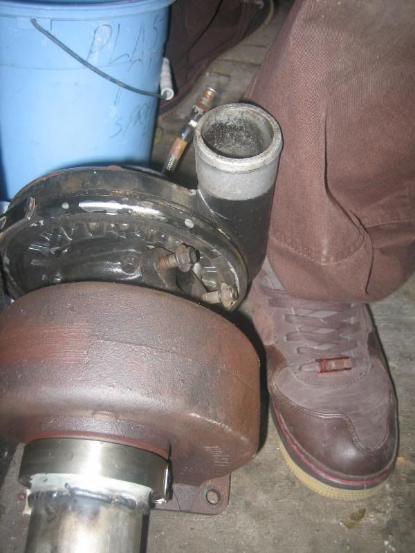

REMEMBER..  My Wifey approves Holset turbos.  Here is a pic of the small h1c for comparison purposes

So when you figure out what size oil feed fitting that turbo has will you let me know So I can pick up one for my buddies holset?
CRX looks good nig!
Re: Jays 91 CRX si build-- Big h1c HOLSET POWERED--Another a6/y8 setup
« Reply #8 on: February 10, 2010, 08:20:25 PM »
CRX looks good nig!
i use a metric 12x1.5 to 1/8npt fitting and then use a 1/8npt to -3an
moar pics added on the first post
« Last Edit: February 10, 2010, 08:23:49 PM by ApexSilver06MR »
Any reason you went away from the smaller holset?
i like the jay dee emm hottness wiff a bigg holsex
« Reply #11 on: February 10, 2010, 11:14:33 PM »
CRX looks good nig!
Word, but the shit is copper, make sure you dont tighten it down tight, only snug. Ive broke 3 of those.

what's the size of that turbine housing? 12cm^2 is the smallest I'd go, and if it's 21cm I would swap it with an HX35W housing. I had an 18cm H1C before, and it's just too laggy.
btw, I ended up getting a minty HY35 that I might use instead of that small h1c (I think it really is the HX30). hopefully i'll show it off in a few days  :)
alright.  fucker just passed smog for change of owner ship.  burned pretty damn clean.  i will boost this one in steps.  first to go on is the ported z6 im tb and spacer.  oh yeah.  i just put the racing seats back in.

Fmic is on.
Mani is on
Turbo is on
Oil lines, charge piping and wiring for tomorrow. Pics to follow.
