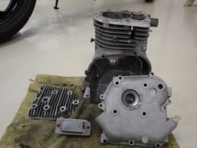

I use the same abrasive ass media as I use for steel, I just turn the pressure down and it turns out alright.  Here's 40 year old cast aluminum I did:
After some steel wool and clear:
If you care about the exact media I used, I'll let you know tomorrow

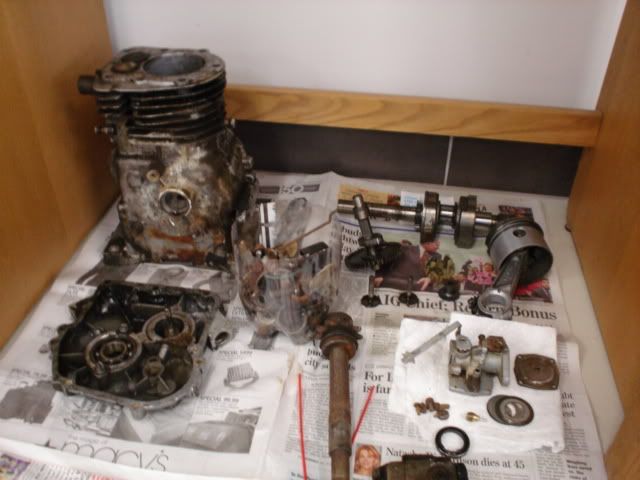

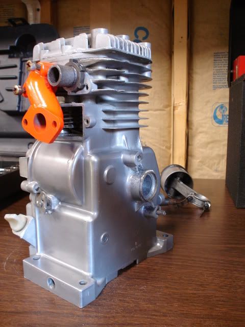

http://www.realhomemadeturbo.com/forum/index.php?topic=1529.0
Before:
After:
