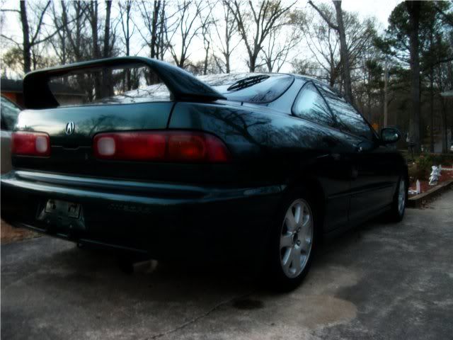

Local guy has some DR16s with new tires he would trade for the Si's as he has a EM1 he is trying to sell. Not sure I feel the red, and I sure as hell don't want to be painting rims anytime soon. Thoughts?
Photochopied
Re: Doug's 99 GSR Failure
« Reply #130 on: April 06, 2010, 04:45:05 PM »
The wheels in the top pic look great, what's wrong with them?
Wrong size tires. They have 195/50's which are too small for the teg. It needs either a 195/55 or 205/50. The red ones have the correct 205/50's
Fuck it. I would just keep what you have. Those wheels would make your car say "steal me"
yeah, 1cm wider tires would make all the difference.
« Reply #134 on: April 06, 2010, 05:55:06 PM »
Umm apparently you don't know how to read tires. The circumference would be 1.26" bigger for 205/50 vs the 195/50.

i do. And I ran those two sizes through some online calculator and got 22.67" and 23.07", or 1/2" taller, which is just over 1cm taller for the 1cm gained.
