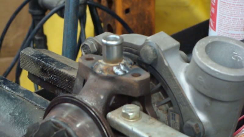

I couldn't see spending 25 dollars for a damn return feed on my turbo so I got creative. Heater hose nipple cost three dollars.
P.S. I'm open for criticism.
BTW, it doesn't leak.

Why hasnt this been done before? I think its a great  O0 idea.

I figured this was an "easy way to save" 25 dollars. Also, I used the same fitting on the oil pan side and put 5/8 hose to butt them together. It turned out well.

look at you all high tech n shit with that real welding.  true  O0 use jb weld on their drain fittings

The opening on that feed may be a little large and give you more flow than you'll need, but it could only mean another 3 cent fix I'm sure.

was wondering why it wasn't jb welded either.  the only concern I'd have, and it probably wouldn't ever happen, is damaging the bearing in the chra if the arc jumped across it.  unlikely for sure, but i've talked to industral gear box manufacturers who warned of the same thing

Eh, it isn't a baller bearing CHRA, and if the ground clamp is close to the weld area with little resistance, then i doubt the chances of arcing across the bearings is much to worry about.

Since when did turbos "return" oil? Drain back is hard enough, let alone pushing it back.

I love it, in fact alot of those retarded 25 dollar fittings (even though I never paid for them, thanks craig) leak. I don't know what the deal is. Sometimes they would chase the threads, sometimes its the flange gasket.

I guess I didn't notice at first, but this is a "test mule", right?
Cause nobody in their right mind here would rock a 50trim t3 anymore. HX40 or go home.
