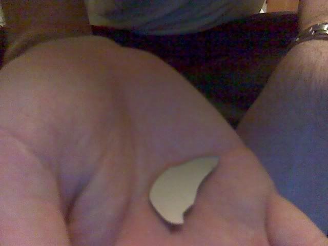

So I had some shit in the trunk that I forgot about, and went for a drive over a winding road near my house.  Of course, things shifted around, and hit one of my subs, making a nice hole all the way through the dust cover and the cone.
There was an entire piece missing, which I had to shake out of it:

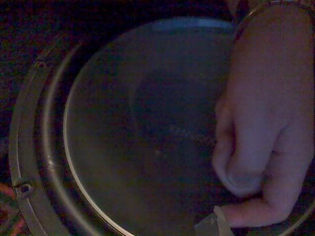

I kinda had to pry up the cracked parts to get them to all go back on top of each other so the cracks could line up.

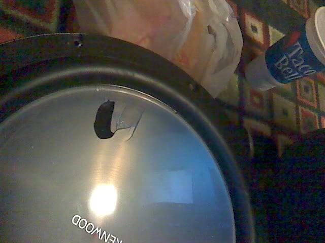

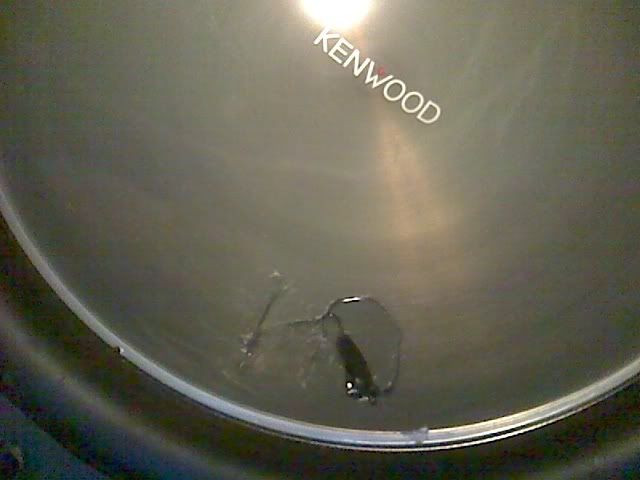

After using a shitload of superglue, and making patches with electrical tape on the inside of the cracks (to hold the glue up in there), I got the piece that broke out that I recovered wedged/half taped into place, and glued that in.  At this point I found out there was another shard missing, so I just said fuck it, and wadded up some electrical tape and glued it in.  If this fails, a new piece will be made out of JB weld.  O0
I figure, worst case, the thing is slightly messed up, but not leaking anymore, and I can use it until I buy another one to replace it for $50.  I just got sick of hearing the thing bottoming out even at lower volumes.  I guess I'll find out tomorrow.

If I had the cash to just replace these now, I would.  But this seems to work.  The tape/JB weld/tape was plan B, if this didn't work.  These subs also aren't bad at all for only costing $45 a pop.  I think I might have to add some epoxy to the repair, to make it just a little more solid with the rest of the cone.  But it doesnt leak anymore. They'd sound a whole lot better if I gave them all the power they wanted.  I'll eventually downsize to a single 10 or 12 running 4 or 500rms.  Its not a bad first system though.  Factory bose system from a nissan maxima, nigged to interface with my pioneer deck (including relays to turn on individual amplifiers, DIY RCA connections, etc), a profile mono amp for the subs, and the two kenwoods.

seems to be holding up pretty well so far, and I've cranked it as loud as I ever have with some Pendulum.  And I still have my JB Weld for other things, which is pretty nice.
