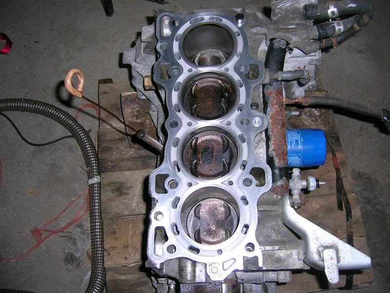

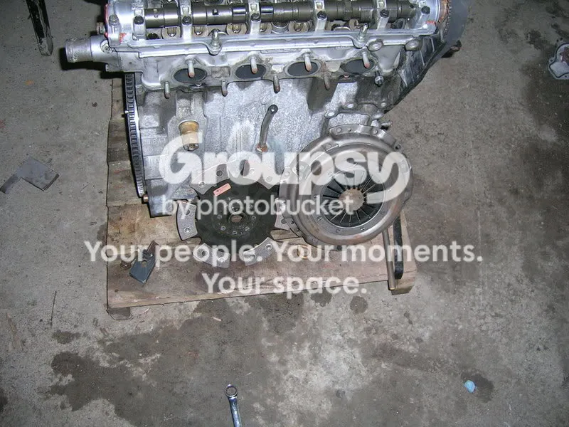

This is the story up to now...  Bringing it back from other forum.
1992 Acura integra sedan.
Manifold
downpipe
Exhaust pipe
Setup
A few hundred kilometers then ...Ouch!!!!...
Either head cracked or headgasket pinched, anyways white smoke, bubbles in radiator.

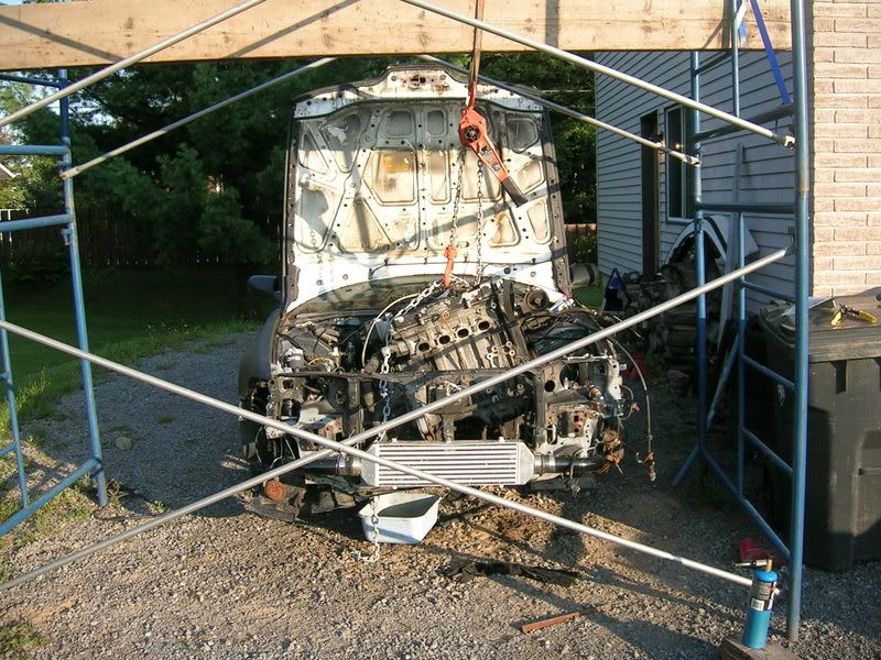

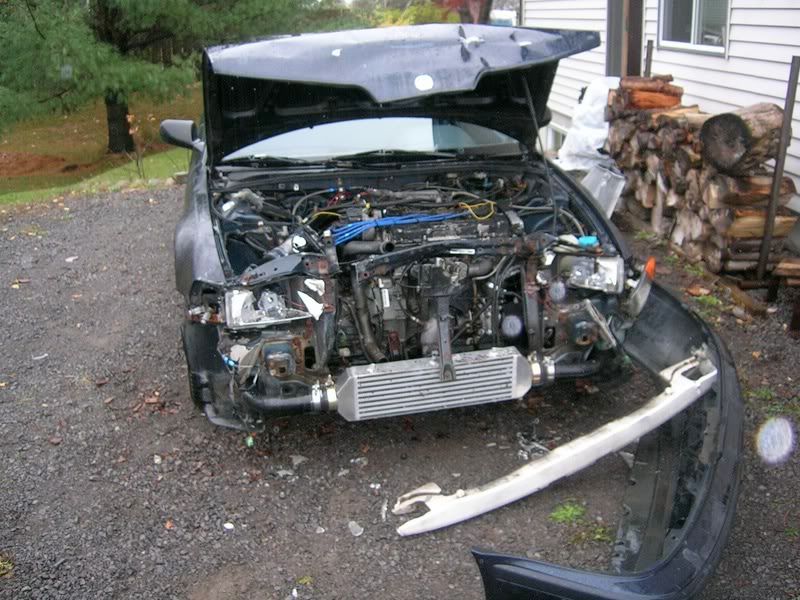

Bought an LS head (B18a), had to remove the engine, intake bracket was too rusted, everything was seized.  Bought an engine hoist after that...
While in there, why not fill the block, it cured a while at room then finished cooking with hot prestone while car idling.

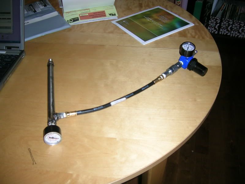

Homemade leakdown tester. All is well with the engine, except valve seals so a little smoke at start up.

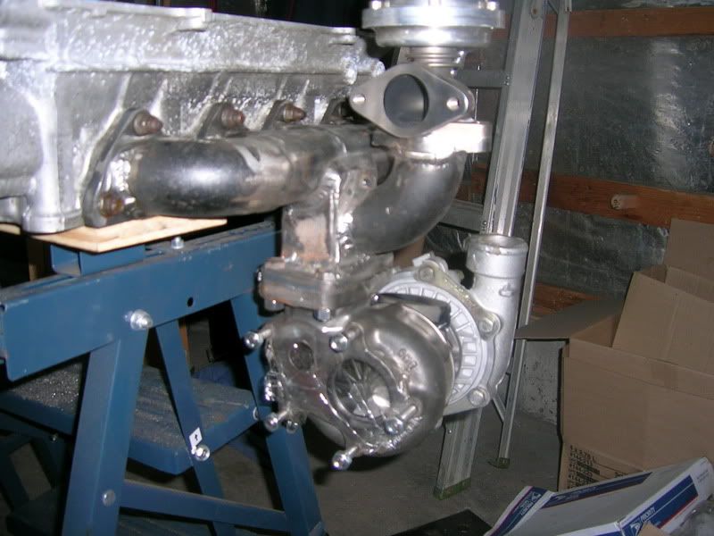

Some goodies bought from Weir, while he was financing his insane F20 RWD CRX, getting out of B's

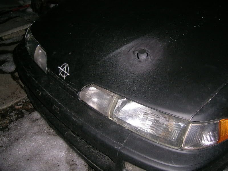

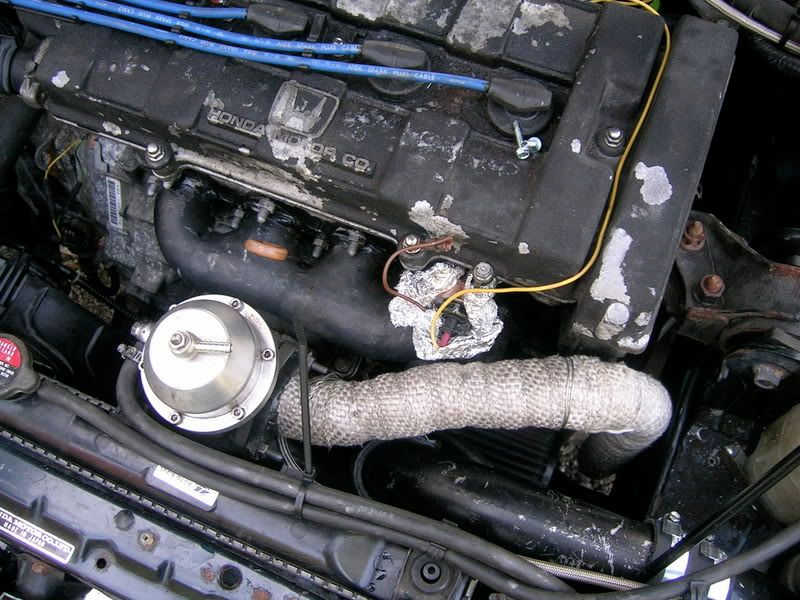

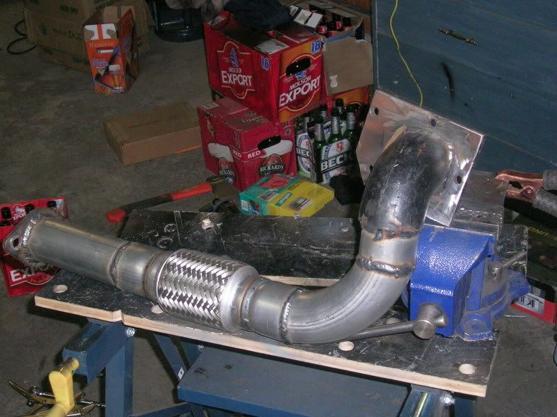

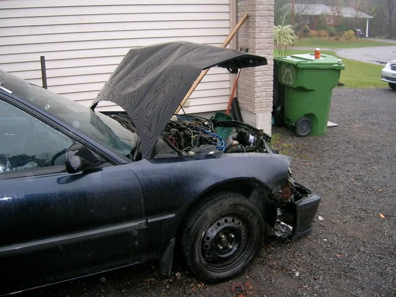

New WG dumptube routing...  I'll just cover it with a poser hood scoop soon.  Funny, when raining, it looks like a whale blowhole.
Now, needs some tuning with ECtune boost controller, traction bars (weir, PM me, I left you a message in the other site, and was wondering why I didn't get any answer, I'm a bit slow), PU bushings, decent tires, and some rust healing.
No Dyno sheet, but front wheels break loose in second gear.
To sum up
Custom engraved acura emblem
2 tones custom roller paint job

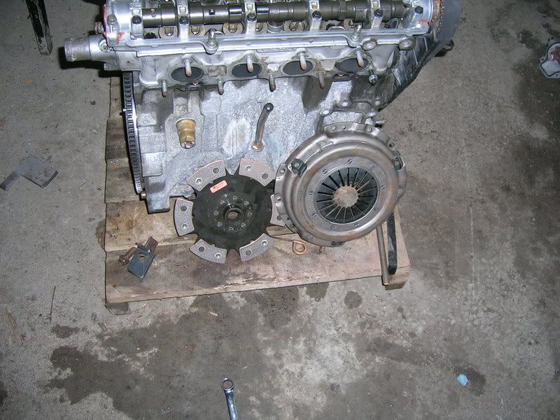

B18A 5 speed

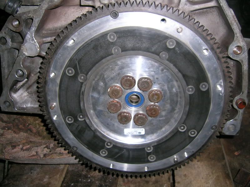

Lghtened flywheel, 6 puck unsprung
CDM wastegate (10 psi but does not go above 9), quite divorced
CDM HKS knock off SSQV BOV
Chipped ECU, needs to be fine tuned, Ostrich EMU
Homemade log manifold
Ebay intercooler, 2.25" piping

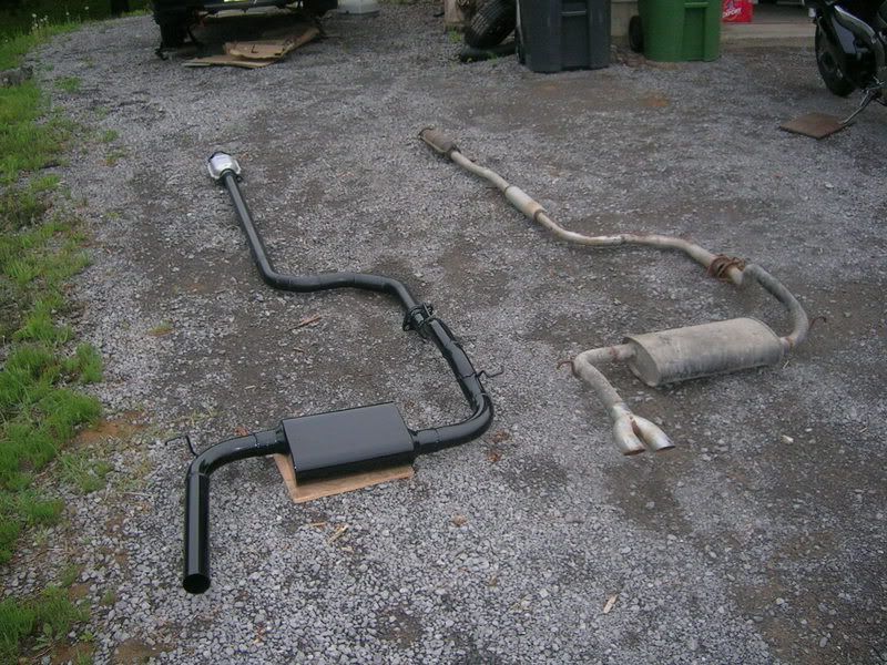

2.5" homemade exhaust
EVO fuel pump
Some nice pics of nice ladies in the appropriate forum soon to come.

Anyway i had to figure out a way not to melt the poser plastic hood scoop, which has only 1 function: Cop keeper awayer.

what diam pipe is the wg dump? i'll make you a flapper on the cheap (if i don't have one here) and pack it the next day
then take 3 months to ship it because i forgot about it
I'd just put a tiny baby hole at the base. Maybe 1/16" if its mild steel so it doesn't rust up. Or you could grind a shallow slot down the bottom of the flange, although that might eat away at the CDM WG metal.

I think hes trying to say he wants to put a hole in the dump tube below the surface of the hood to let water drain out of it, it was somewhat difficult to comprehend, lol  :somb:
Sorry, it was late apparently. Flapper would be dandy, but that would look goofy. Well more goofy than an exhaust pipe exiting the hood.
