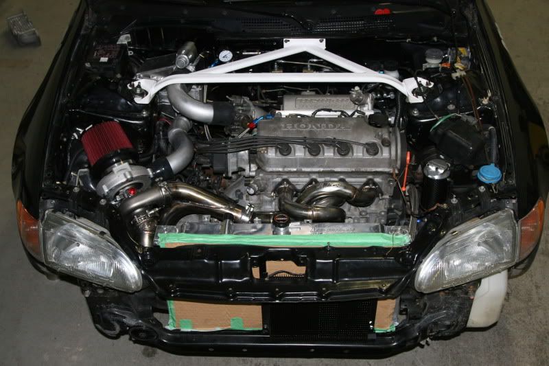

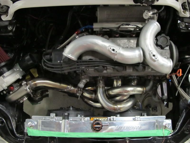

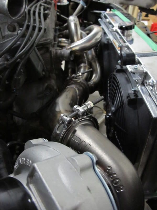

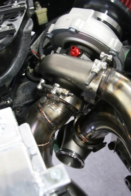

Nice attentino to detail, Aaron what are you going to use to brace the turbo? It's sitting so far away, you would think the leverage its creating might cause problems at the head.
Re: twin charged d redline time attack car
« Reply #7 on: April 05, 2010, 07:36:33 AM »
It looks like he has a brace to support the weight of the turbo, going from the tranny to maybe the compressor housing...  you're right though, two v-bands alone ain't gonna hold the weight of a turbo w/o it moving around.

yes, the "y" pipe is braced to the tranny.  originally he didn't want anything, i had to talk him into adding something.  there is also a brace on the downpipe in the factory spot after the oilpan before the flex.  will post more pics, just about to pull it out now.

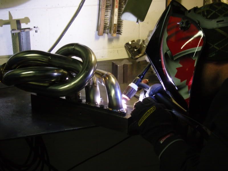

as for the torch, the one in the pic is a #8 cup, i use that for the head flange and other joints like that.  for butt joints, i use a #12.  for tight spots though, i have a smaller gas lense and use a long #8 cup.  i'll have to get pics up.

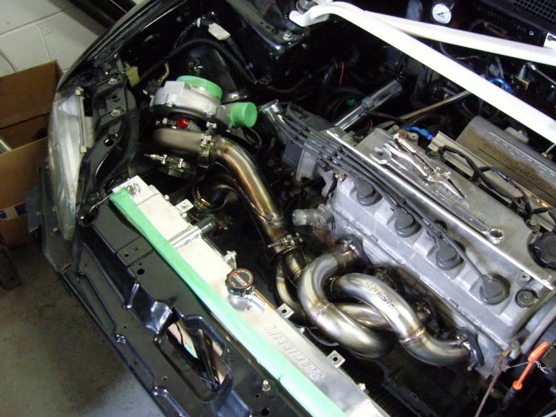

I don't know if its just the pictures but that turbo looks to be at a pretty good angle.  Your generally not supposed to go above a 15 deg angle before it starts having oil draining issues.  I ran into that problem on my Twin turbo kit

the turbo is on an angle, but that is what he wanted in order to run a filter.  i think it should be ok.  i don't think it is more than 10-12 degrees.

Is that all 16ga?

Looks good aaron. How do you think this will hold up with it being thin wall?

yes, it is all 16g.  i'm confident it will hold up, although i'd like to see a better support brace on the turbo end.  i guess the one lap event will be a good test.
