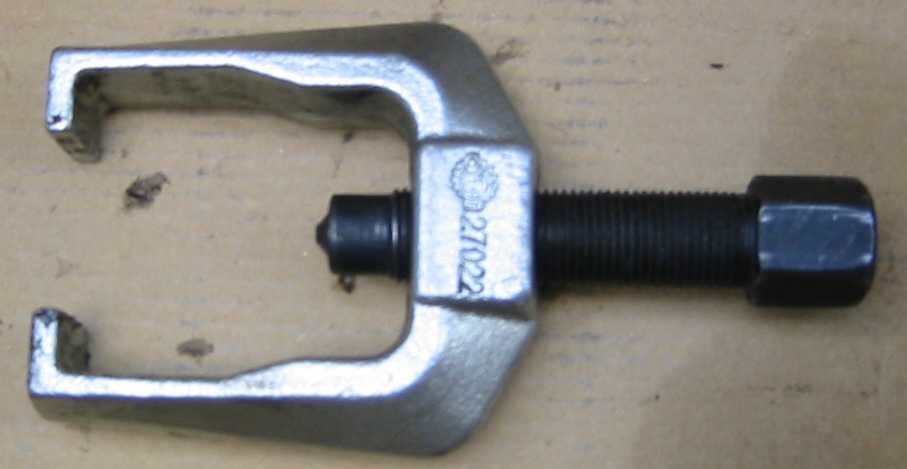

well, i was doing a clutch the other day and popped out the ball joint, and started to think if there was a better way.
i use one of these but make sure the nut is over the cotter pin hole.  and ive tried the pickle fork thing but that tears up boots, so fuck that.  any other good way?
grind that center point flat and you'll be fine.
that was just a pic of it that i found online...  mine is flat...
