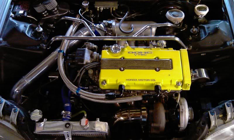

lets see some pics of you engine bay. and the front of the car.
Intercooler is a backdoor, 11" eGay monstrosity, custom end tank, 2.5" piping, wastegate is REALLY close to the back of the I/C could have something to do with iat's?

your radiator is blocked by the front bumper innercooler and hood. I'd drill some holes in the bumper in the little area between the actual bumper area and the hood. like I did on my crx. after I did that my ects are at a steady 175. Radiators have a hard time working if they don't get fresh air running through them.

Re: How hot is too hot? ECT/IAT/Oil Temp etc...
« Reply #18 on: April 25, 2010, 07:29:02 PM »
Ebay Radiator/fan
Problem identified.
Ebay fans push 1/10th of what they claim. Go to hater-tech and look up that big fan thread for the high-speed SPAL fan vid, it sounds and flows like a turbo prop airplane. I still have the stock 1-core rad and stock fan, and I've never seen it go above 200F. In fact, it only went to 185F on the dyno between runs, and DOWN to 175F during the pulls. It also helps my entire topmount's DP is wrapped, along with the upwards section and part of the runners.
Cruising IAT's aren't something you should worry about if you're using the stock sensor in the manifold. I recall seeing 130F+ IAT's on my d15 with a z6 IM after it was idling for 10 mins.
As for oil, oil will break down at extended periods above 260F. 240F is about the right operating temp for most Hondas w/o stock oil coolers.
