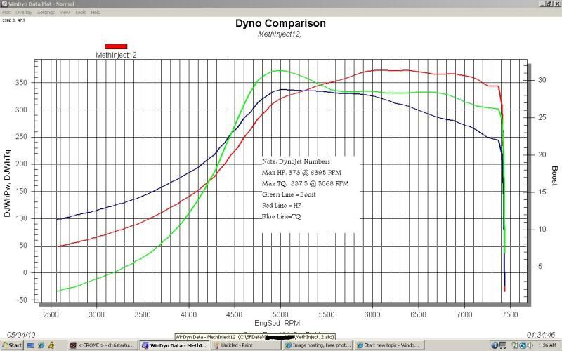

After fucking around forever at sub 15psi, I finally got to the dyno and made some power.
Setup is a run of the mill vitara setup, the reason for the dyno time in the first place was to test out a water injection controller some electrical engineer friends made for a senior design project. My base street tune at 15psi made about 250whp, I eased up the boost and my power peaked at 373whp 337tq (kinda high tq for the power is it not?) here is the graph.
For some reason I couldnt make any more power, even with more boost. I pulled 2deg. out of my cam gear and the boost curve looked exactly the same except it started ramping and peaked about 200rpm faster. It seems like its making alot of tq for the hp, and I was really hoping to make 400whp but for now I guess its close enough.
Here's a picture of the setup
I'll try and get some ripper vids up soon.

Did you try feeding timing back into it at higher boost? and also why not didn't you crank on the boost controller alittle more pressure is fading back down to an avergae 25psi. But in all seriousness that graph looks great I'd be more then happy with it. The torque is unbeleavable.

Yeah, that was my leading theory when I went to hit post 22.5 hours ago only to find the site had gone tits up.
Basically, it appears that the compressor is being sucked dry.  Peak power is happening abnormally early AND boost is falling off up top, which means it's more than just a matter of cam adjustment.  Some people like those china turbos but what it's advertised as and what you get are completely different.
Put a real turbo on there, and next time start off by tuning wastegate and THEN do more than one cam adjustment.  Spin it both forward and back, see how the engine behaves and if you get gains try another degree in that direction until you find the sweet spot.  Then start cranking on the boost controller, power will come.

Shouldnt he be putting timing back in, to keep the torque level, instead of it dropping off so much???? (I dont know shit about tuning, so that is a genuine question).
And those eBay turbos are actually advertised @ 350 (and I dunno if thats supposed to be whp). So 370 is pretty good for a ching chong. I myself made 340, but was limited by my wastegate spring, so I will be going back for more this year.
Numbers look good though man. Is that a SPA manifold or whatever that cast top mount nonsense is?
Thanks for the advice. I had a garrett on it with a slightly larger compressor, but had a tiny stg.1 turbine on it that couldnt support itself at anything past 15psi. I'll probably send it back to that french canadian fuck to get a bigger turnine wheel on it. I was more than happy to keep playing with it but the pull right after this I added in only a small amount of timing and lost 30whp. So I pulled it back out and lost another 30whp or so. So that was that for the day of tuning, I have to do a leak down on it and see whats up, i'll probably just put a real set of pistons in it right away, i'm running a .0085 piston/wall clearance.
Ching Chong turbo?
You cant really complain for $140, I should have bought 2 for when this one shits the bed.
Honestly I was a little upset  at the power, I was really hoping to see a 400whp pull. I also really wish dyno time wasnt so expensive I'd be on it more often.

I bet that shit is fun as hell on the street. Awesome tq curve.

Yeah it is a blast, it blows away 2nd and still catches 3rd most of the time, 3rd gear feels like a spaceship. I'll try and get some ripper vids up before I have to take off the W/I this weekend, the unit has to go back to the group that created it for a seed show.

That's actually pretty damn good power for a China snail. I've seen more than one lose steam before 400hp

Yeah but I've also seen a bunch making well over 400whp so thats whats kinda dissapointing, I think with some more dyno time I could probably pick up another 10 or 15 whp at that same boost.
