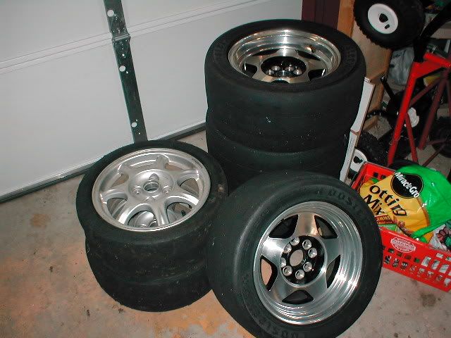

you mean like 225/45/13 Ho-Ho A6's?????
My rubber is covered, only has two events on them.
Toledo and Nats.
