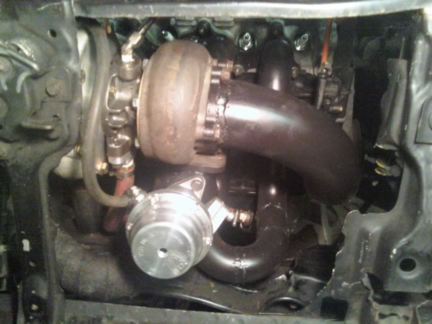

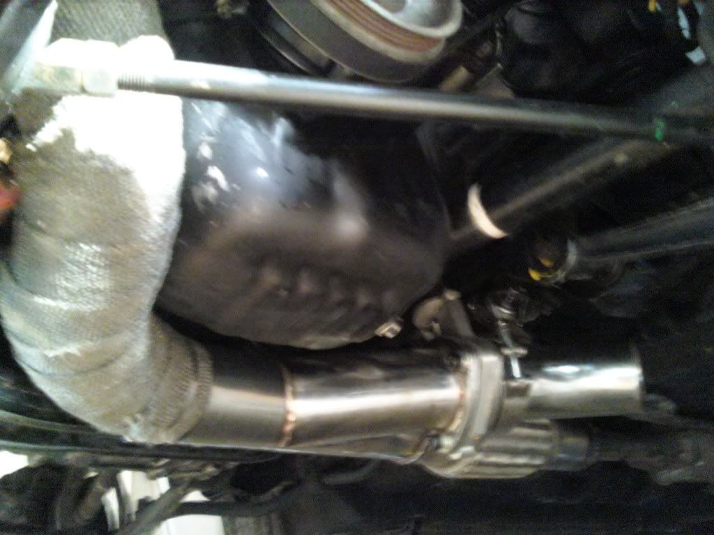

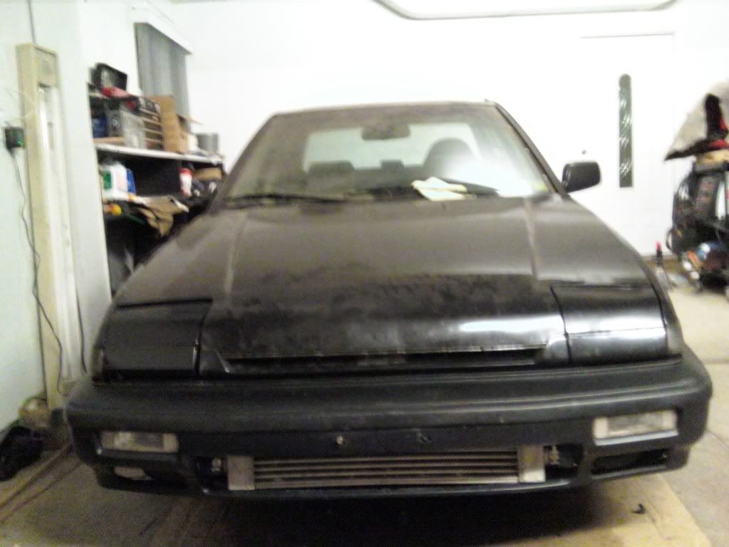

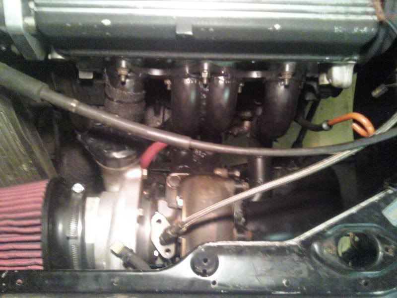

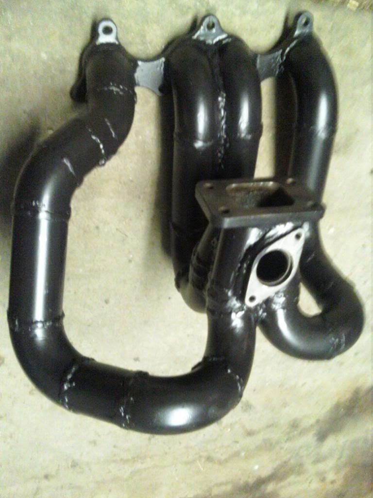

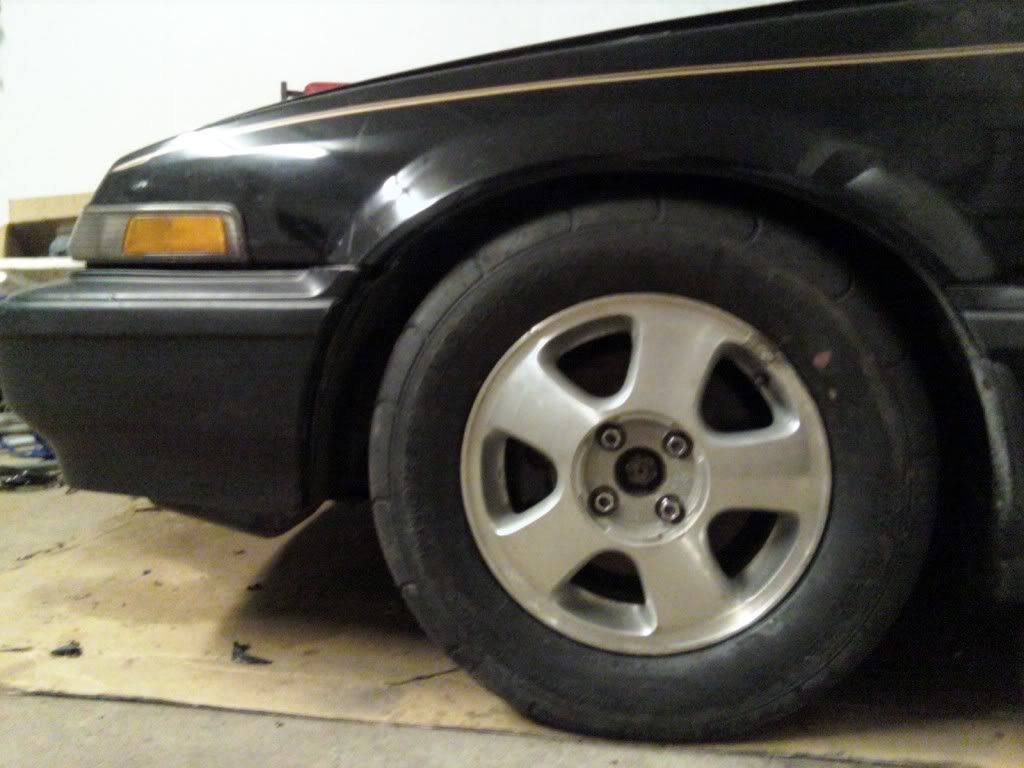

The car is still really dusty but here are some pics:

good looking build.  really like the work on the cut out.
Re: Car wants to stall when slowing down for a stop sign etc
« Reply #9 on: May 24, 2010, 03:20:11 PM »
That is a great build you got there. :yes: ;D
