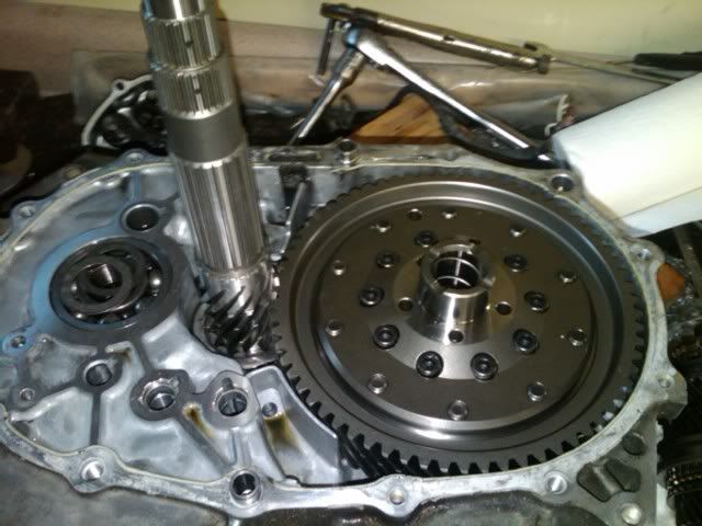

the countershaft took a little bit of maneuvering along with the diff in order to get it to fit.  the 5.15 gear is HUGE.
mmmmmmmmmmmmm
really glad i decided to do the syncro's.  The old ones are decent but definitely showing wear.

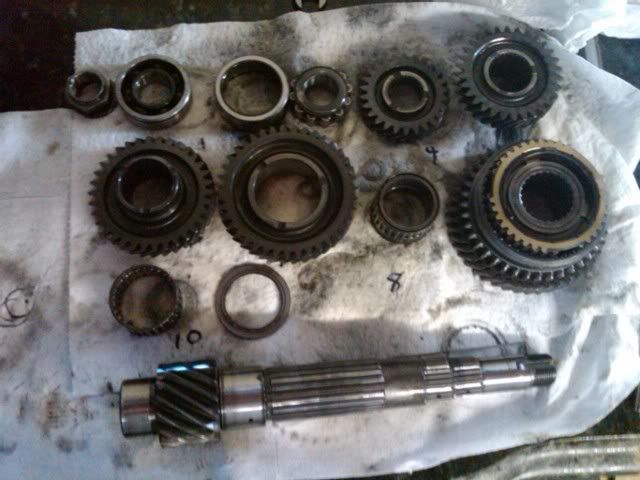

I found it cute you had it all layed out numbered   :-*... After a few or ten, youll remember in your sleep.... SO in that pic looks like ya had carbons in there???
yea, it really does appear to be all that bad, but i know im just newbie just slapping it together praying it works  :P JK
no, that pic was when i first tore the mainshaft down.  I got the nut loose from the countershaft today when i got to the shop this morning so i'll have it broken down later tonight.

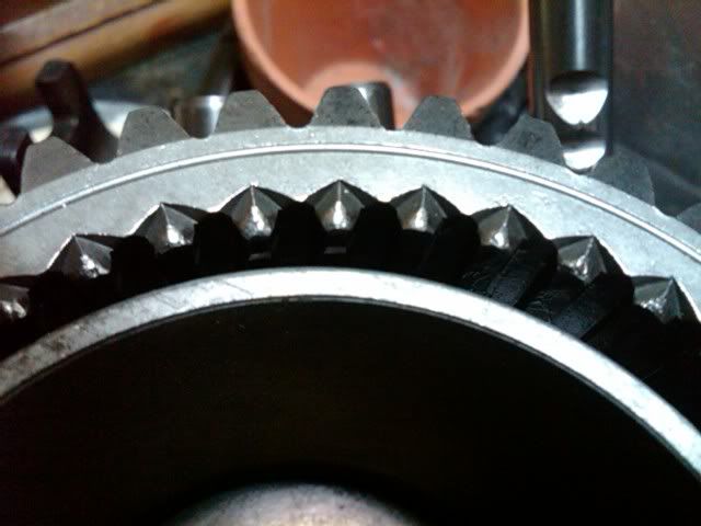

Im seeing some heat in what appears to be 4th  (MAYBE third)in yor pic above??? Not really bad, just sayin.
Id run that biotch again fo sho.
the one before i put the scotch brite pad on?  I noticed that but i didnt see anything abnormal with the syncro so.... :?:
fuck it.   :)

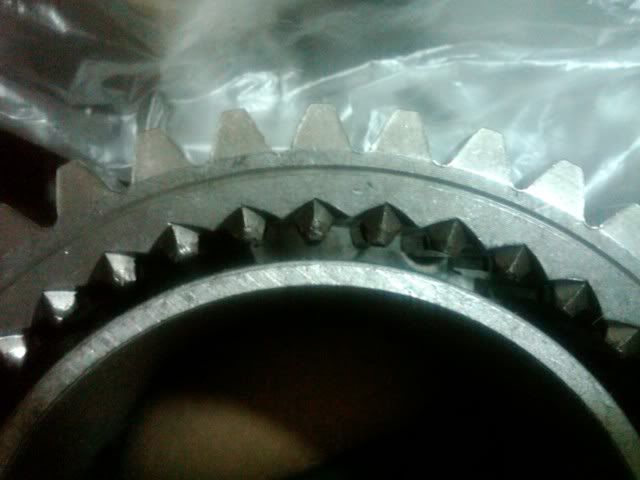

i got a question.  My reverse gear (1/2 selector) looks like it has had better days.  It was hard to get a good picture of it:
what do you think?
I'm going to take apart the other countershaft tomorrow and see if the gears/hubs/sliders are any better.
Also, what torque spec are you guys using on the diff bolts?  Honda spec?  I dunno if i lost the papers or not, but i didnt see anything in my box as far as torque specs go.

Has it ever given you any trouble?  It isn't like you're ever slamming it into reverse either.  If it were me i'd just stay focused on the forward gears unless it's been giving you trouble.
Re: tools needed to rebuild tranny?
« Reply #46 on: June 15, 2010, 01:07:23 AM »
nah, it hadn't given me any problems before but i might as well pick the better of the two while i have it torn apart.  Need to do the same thing with the rest of the gears, but i would like to be able to see a brand new gear so i know exactly what i should be looking for as far as picking one over another.

get a fresh 1-2 slider...........
« Reply #48 on: June 15, 2010, 03:39:08 AM »
i concur. I might have a nice 1-2 ill look/ That ones beat
