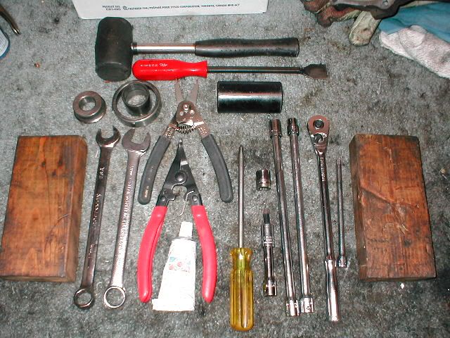

press snap ring pliers feeler gauge to name a few

Bones got woods... Important thing some forget....  So fagbait if you have any ?s give me a pm with your moms number and illcall you at 3 am your time and we can discuss....l
LOL
JK
 H trannys are super straightforward.
Youll need a 1/2 drive ratchet to take off the plug for the snap ring as well, didnt see it in bones pic,
Sockets:
32mm socket for countershaft nut
12mm - case bolts, detent ball assys and shifter assy
10mm - shifter box and reverse  fork assy
14mm - reverse idler shaft and the two long case bolts located adjacent to the shifter box
feeler gauges
extension
snap ring pliers
prybar
scotchbrite
couple pieces of wood to support the tranny up so that the input shft isnt getting hammered on sitting on its face
Brake clean
Hondabond (I use ulta gray ts 1/5th as expensive and just about the same shit)
lube of choice (but not the stuff you use with your boy toy)
If changing the bearings on the diff... The list gets a bit more in depth, if not... It doesnt change

Spiker likes my woods :)
I don't do H bitches or GSR/ITR tapered faggot bearings. I've done two Scion trannys with tapered diff bearings, a huge PITA.
I've no need for Scotchbrite pads, unless you mean for the air grinder.  The key is to load the fresh pads up with gunk so they don't cut too fast on cases you are doing for customers.
An old shift shaft rod is soft steel, useful for tapping in shims or hitting the center of the MS to knock the bearing and 5th gear off.
I is a redneck, I use left over parts that would be scrape to assist on building other items, it is the hot rodding way.

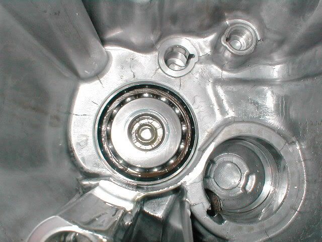

Do you have the races sitting on the diff bearings??? or WTF tranny code is that
yea, the race was sitting there when i pulled the case off.  That trans is a M2A4.  JDM non-LSD.
Re: tools needed to rebuild tranny?
« Reply #27 on: June 02, 2010, 04:12:18 PM »
That's odd that it came out that easily... none of mine have ever just "fell" out of the case.  Send that tranny to me and ill put it in my car and test it for you free of charge.

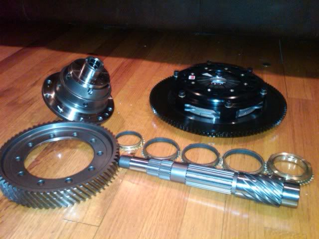

syncro's came in.  I was kind of upset they didnt come with new springs.  In regards to reusing those from the two sets of gear sets i have, what do i need to look for to figure out which ones are in the best shape?
