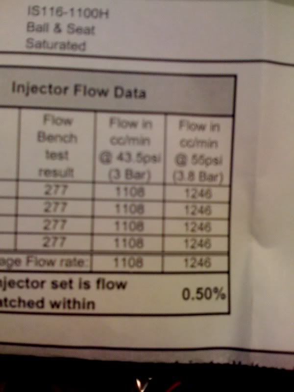

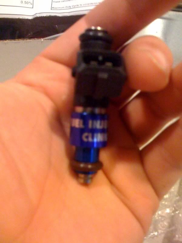

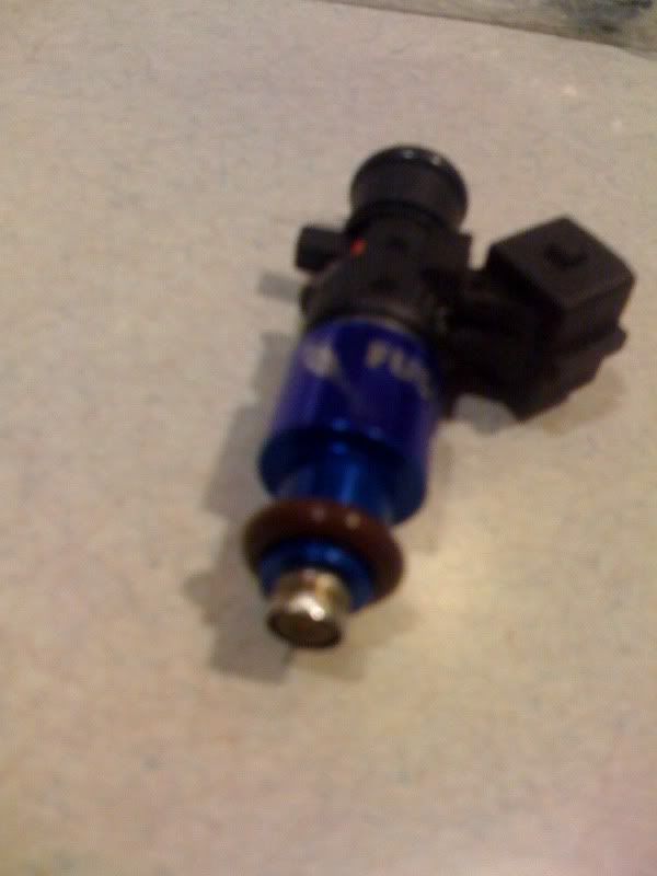

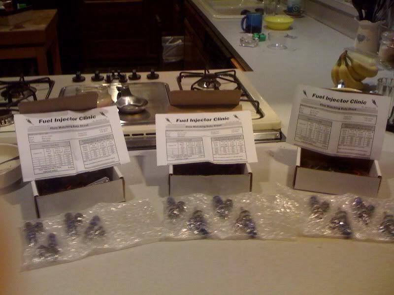

Flat Black, ScorpioMK and myself took Sewell up on a deal he proposed on som FIC 1100s while he was in the PNW. Im waiting on a 4 BAR from JD and a couple TB gaskets and the slut will be back onthe dyno in a week or so. Once I get ahold of leednog.
The numbers are awesome...  at 55 PSI looking at 1250 CC...  Up around 35 pounds of boost it should be Palenty to get where I want to go.
 I saw them idling on Alexs pile of sht at 15:1-16:1 with no lean popping and heard his part throttle was int the 16s as well... That is a NO GO on the Precisionn 1000s.
Now I will have PLENTY of fuel to max the T04ZR   :noel:  Not sure that will happen, but the plan is to get out of the 6's

Them there squirters be purdy.....
