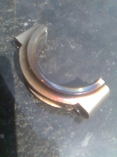

alright I accidently installed my end cap backwards and it scorched the end cap (see pic) my question is, is it safe to use?

Uh... What's that go on? Cam bearing cap, rod bearing cap? If it did that, you probably have other problems.

as long as you didn't spin any bearings, or have damaged it physically outside of heat cycle, and your bearing tolerance is in spec, i don't see why not  ???
I dont see why either, yeah the bearing wasnt spun yet, I guess I'll just have to measure clearances once I get my rod bearings in...lol I feel like a idiot for doing that, but I didnt know which way the fucking notches were supposed to go :\
Re: Scorched End cap
« Reply #3 on: April 04, 2009, 01:30:50 PM »
It about had to of spun a bearing to do that.  ???

well if it did then thats what I was asking, if the end cap will be okay?

well I think what happened here was that the end cap was facing the other way... like the end cap was facing towards the exhaust and the rod was facing towards the IM or vice versa.

I almost did the same thing on my rods... When you put the rod cap backwards you wont get a perfect circle. If you take the rod out and put the rod cap on backwards you can feel the edge right where the rod and rod cap meets. Before the rods leaves the factory they are assembled and linehoned to get the right clearance and a perfect circle.

there is a notch on each side of the bearing AND block/retainer.  these need to face opposite, the tabs that is.  they keep the bearing from spinning, and afiak the notch points in the direction the crank rotates.
Those notches are for alligning the bearing for installation, but they don't actually keep the bearing from spinning. Friction from crushing the bearing is what keeps them from spinning. It takes TIME to spec out a bottom end properly.

heres the thing. I installed 1 rod backwards (notch towards intake) but, I installed the end cap the same way. As far as I can tell its fine, if it would of spun it, it definatly woulda done it within the few miles I drove it right? so, the question is, is it okay to leave that one backwards long as the end cap is installed the same way? Kinda like what widebody was saying, is there actual way to go?

well heres what Im thining, as long as the notches matches up the both are getting oil and wont spin the bearing, but with the notches opposite it'll resist the oil and just burn the fuck outta the bearing and end cap/rod. Reason behind saying that is that it should have spun the bearing almost instantally...or at least wouldnt of been getting oil to it and burned it the same way. So Im just gonna wing it and put it back in there with the rod backwards.

The rod backwards or the rod cap opposite.  Same cap or the burned one? Now sit there and think about it. its got hot, colored which means hot and brittle, and warped, and your going to re use, I suggest a new cap or whole rod assembly. is the rod side is also colored
