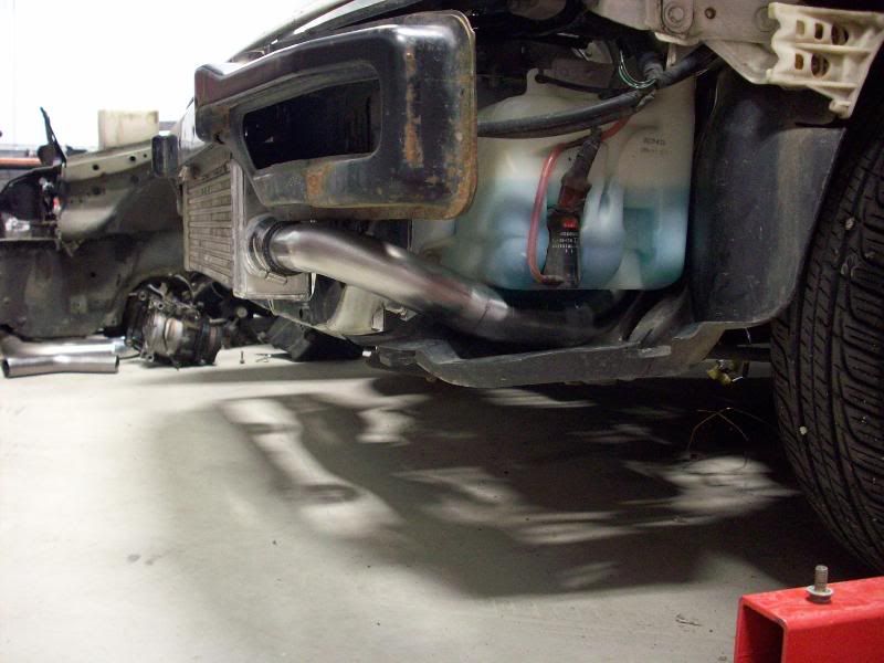

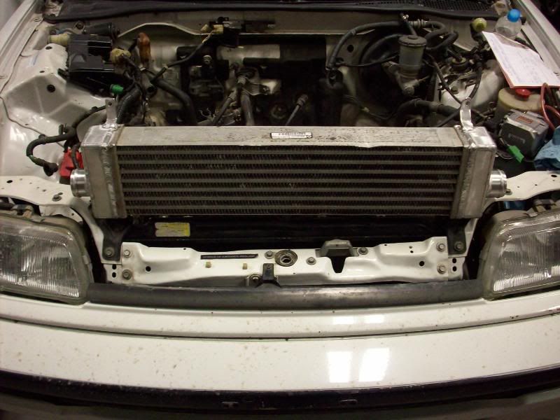

here is my modded srt4 intercooler. It has 2" outlets on there.
Here is the intercooler mounted with the 1.75" hot side piping tucked under the washer res.
I have mounted my full a/c system minus the condenser( this i new wouldn't fit without a aftermarket p/s cooler, if theres no p/s it could have stayed) and it all fits. You just need to be creative with routing the charge piping. These aren't eg/ek/dc's the normal stuff goes out the window.

Heh.  The hotside is all I was worried about to be honest, and it looks like it is totally doable.
Maybe I can mod this Starion IC that I originally bought for this car.
Thanks for the pics man.  That helps a ton.
EDIT:  I see you this is of your sedan.  If I recvall correctly, they have a little extra room up front.

I was ablt to stuff a JRC 6" fmic in the front of my sedan with AC but PS removed. I can't see a hatch having an inch or greater difference, but 1" or under would be fine. The JRC core was 2.75" max thickness, which included the endtank thickness. It came exactly to where the lower paint line was for that grille/mesh section.
If you don't get the huge as fuck option, a 2"x8" would fit fine with some bumper support trimming. Also, the thinner the core the faster air will end up flowing through. It will help cool the engine bay too, which really helps with a ganster lean on the rad.
