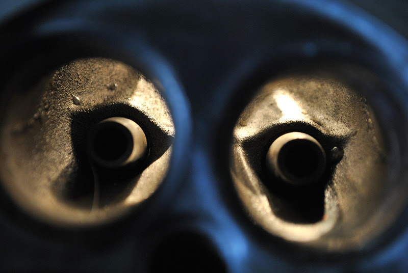

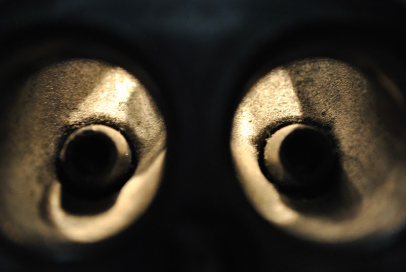

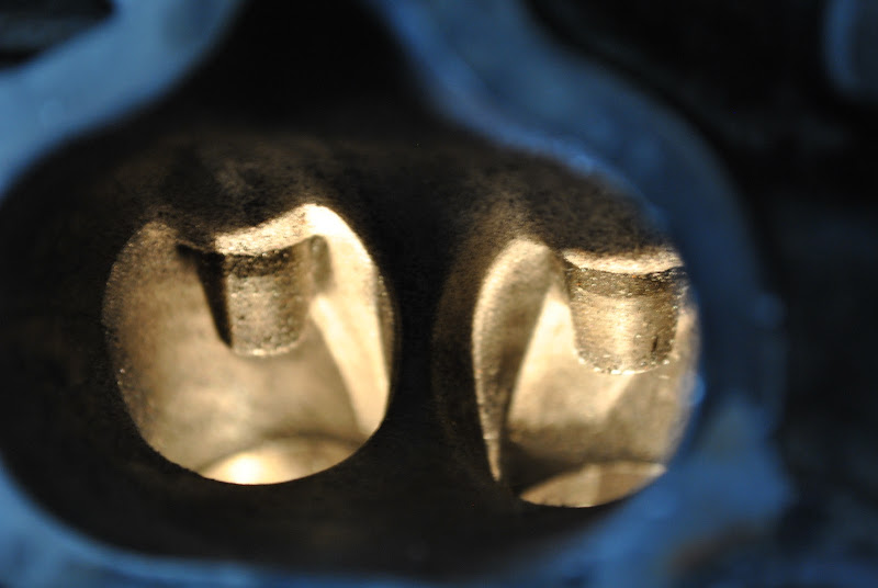

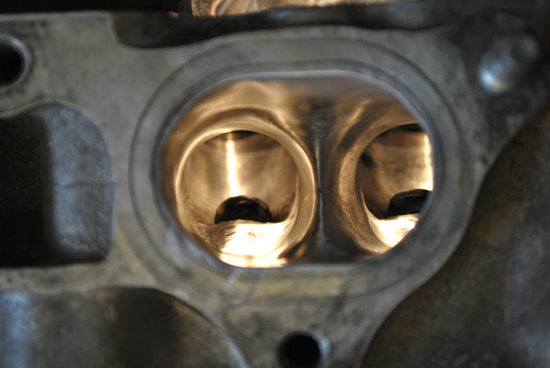

Here are some pics of PR4 vs P75 head I took yesterday:
PR4 intake port
P75 intake port
Pr4 intake port
P75
PR4 exhaust port
P75 exhaust port

In my unprofessional opinion, I'd say the PR4's greater cross-section area and narrower divider would lead to more flow. Given that guy tested both, it appears that is correct (dotted lines in link below).
http://www.flickr.com/photos/45424931@N05/4229804309/#sizes/o/in/set-72157623070162488/
Speaking of that, I'd have to say JD's constant ranting of non-v heads flowing around the rate of vtec heads is correct. They just need a bit of work to do so. If you cut down the spots around the valve guides to what the p75 head is like, you'd probably be better off with less work anyways. Just use the p75 cams, although it seems they don't add noticable power in his case.
