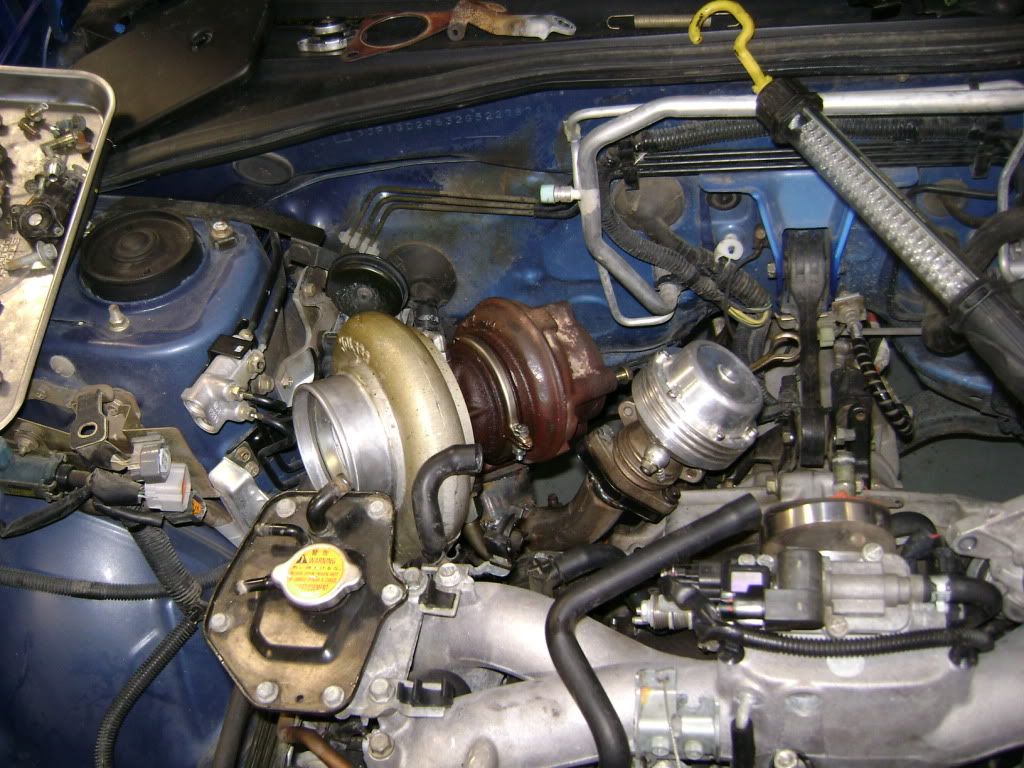

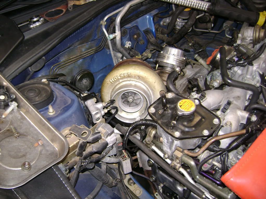

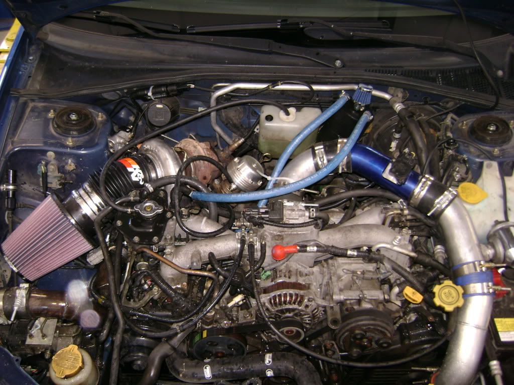

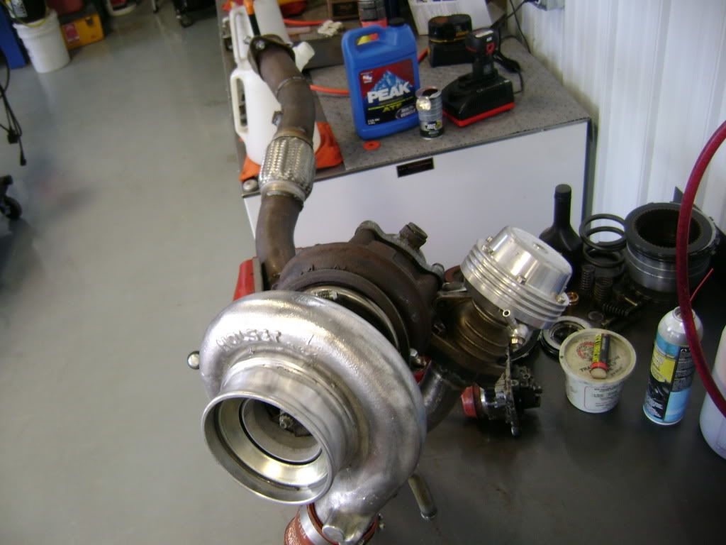

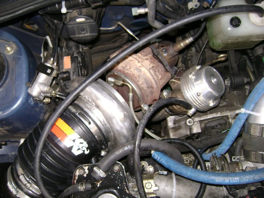

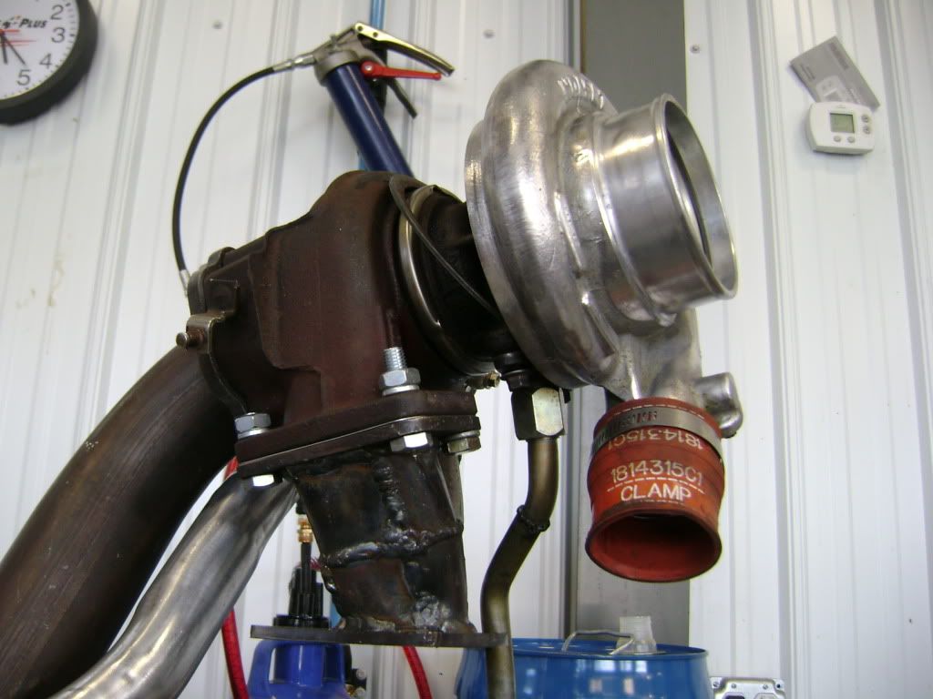

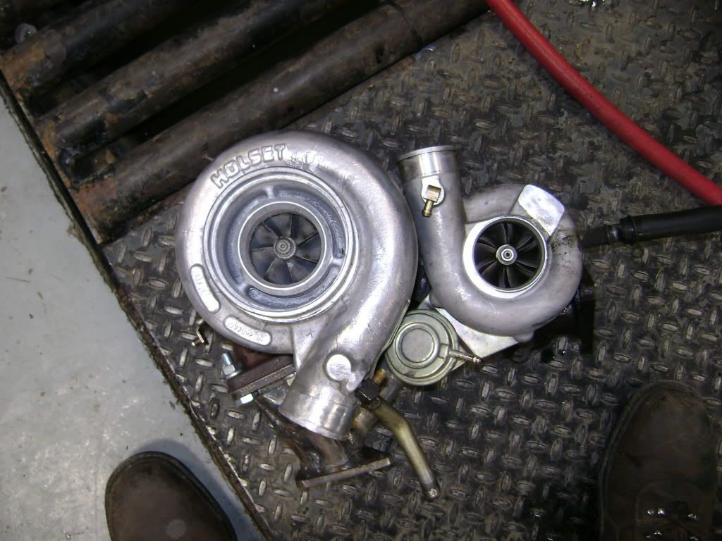

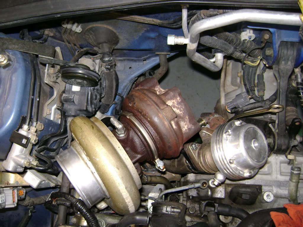

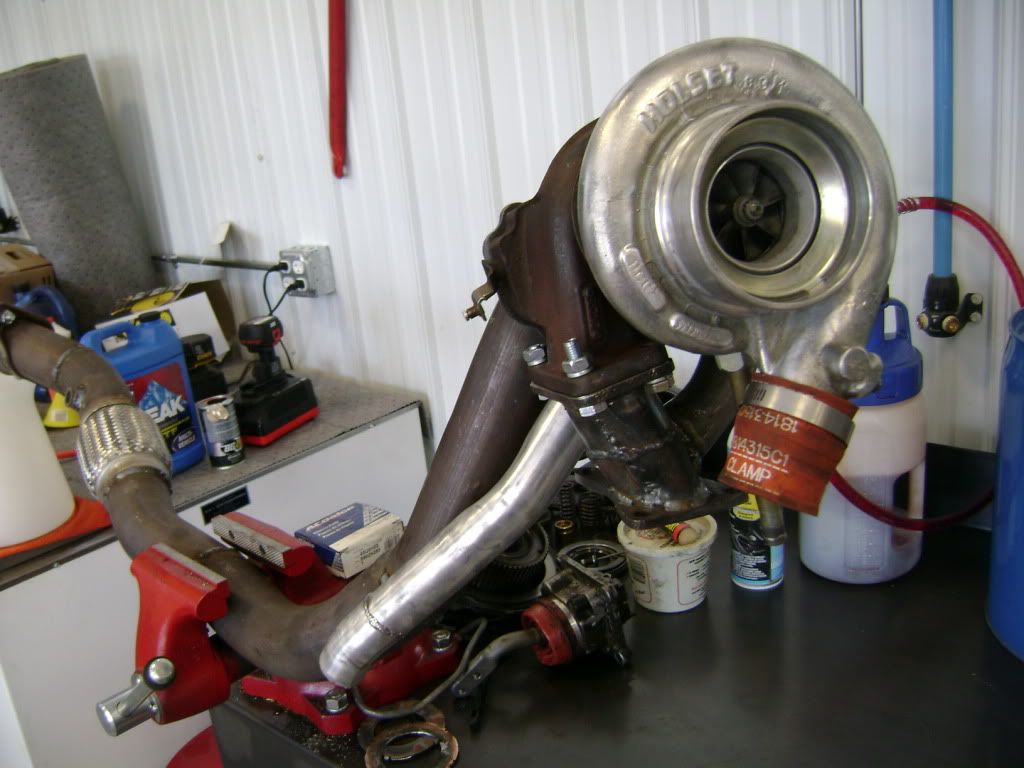

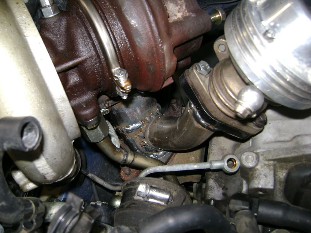

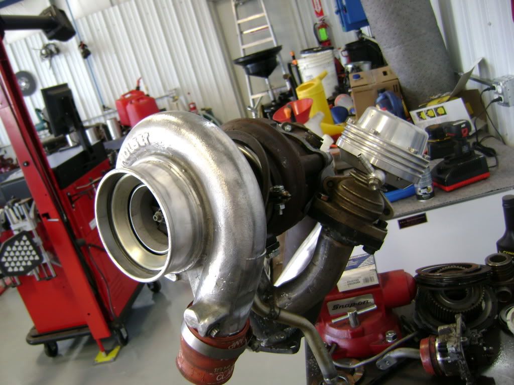

I bought the WRX over Thanksgiving last year. It has a built engine,PPG gearset, walbro 255, 750cc injectors, catless header, 3" catless exhaust, Greddy FMIC, and what I now think is a CDM 16G turbo. I decided to change some things. Got ahold of a nice HY-35.
Off the car pics. I'm getting alot of hate on a local forunm that I frequent. Mostly because the up pipe adapter is migged together with some shit I had laying around instead of sch40 SS. I can assure you all though that the inside is very smooth thanks to my die grinder and carbide bits. It looks like fuck, but it works well.
comparison from the turbo that was on before(chinese 16G?)

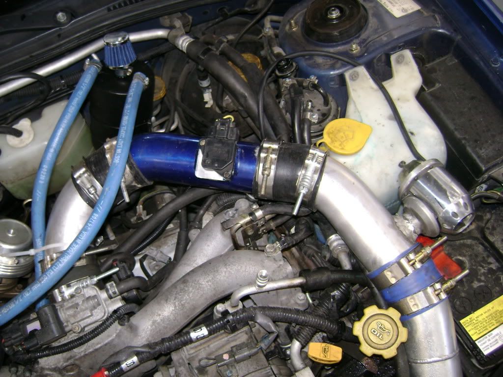

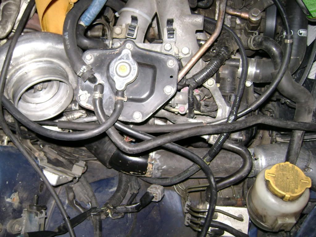

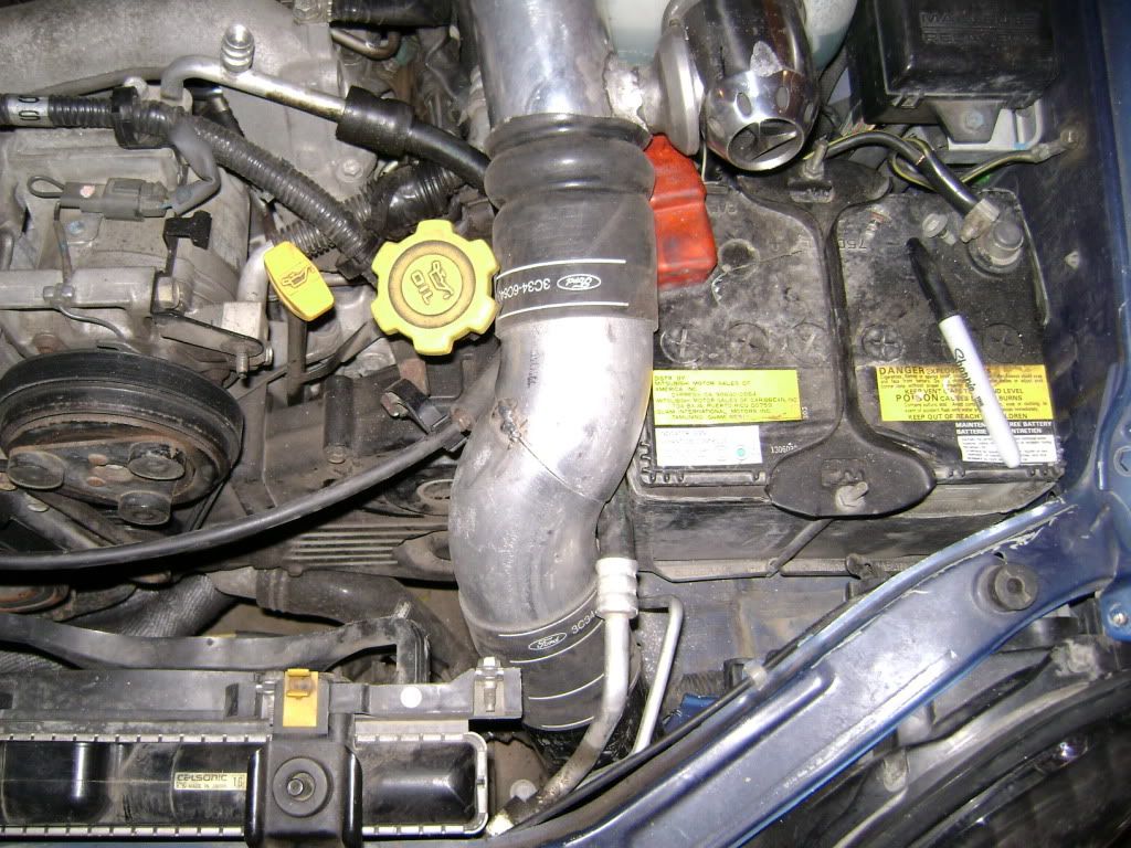

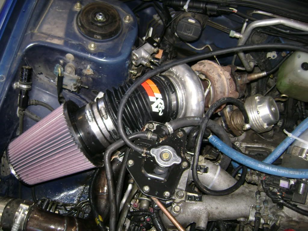

Blow through MAF. No longer venting metered air woohooo! I'm gonna clean up the piping when we get a spool gun for aluminum MIG welding.

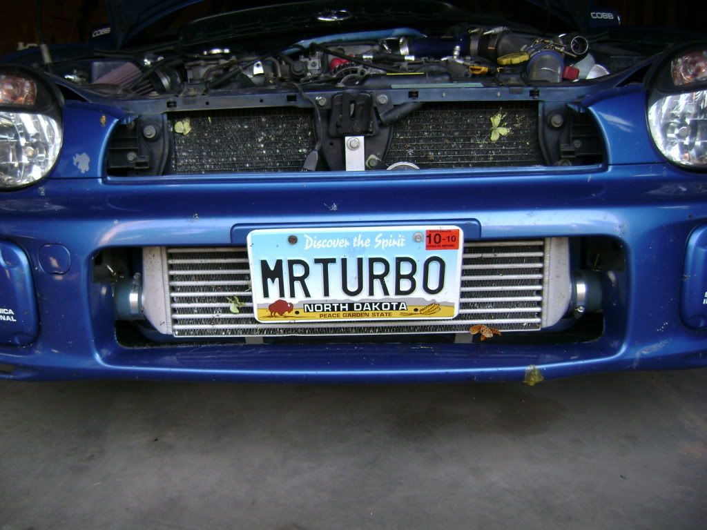

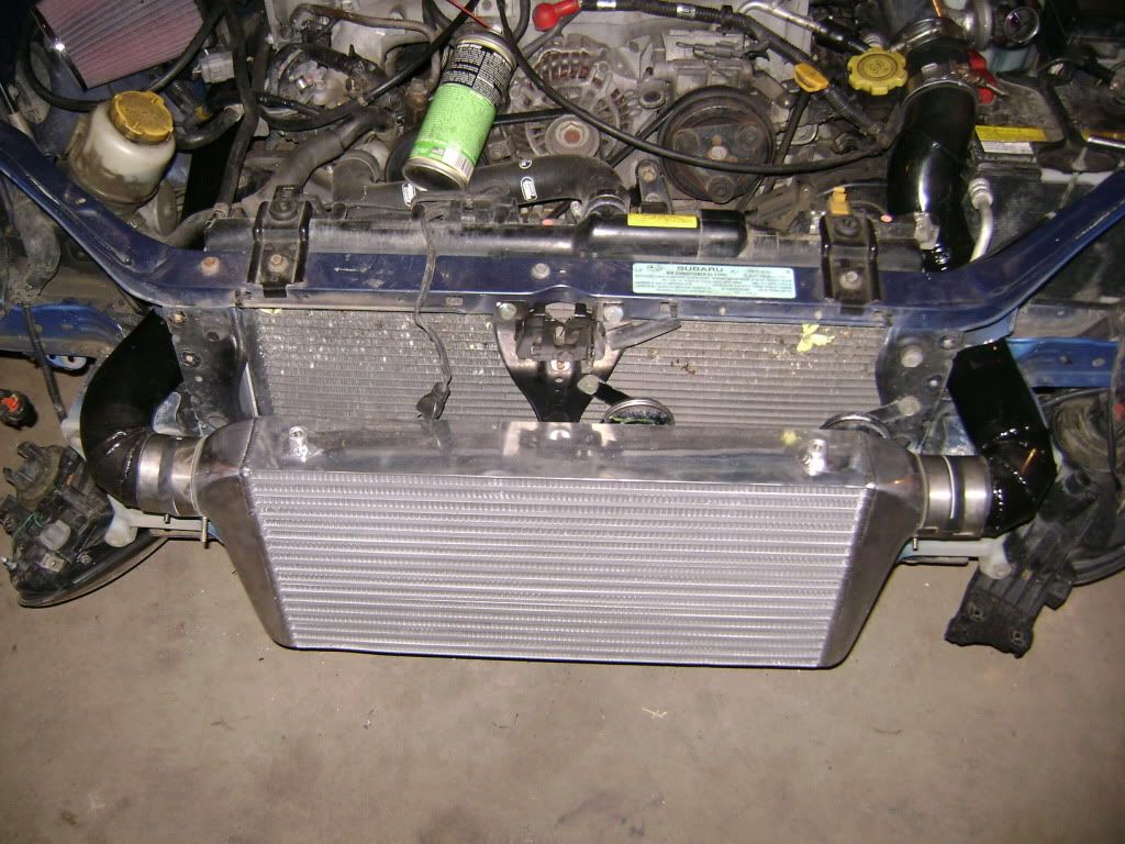

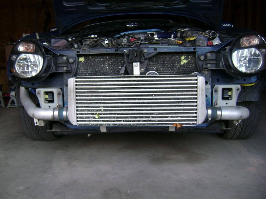

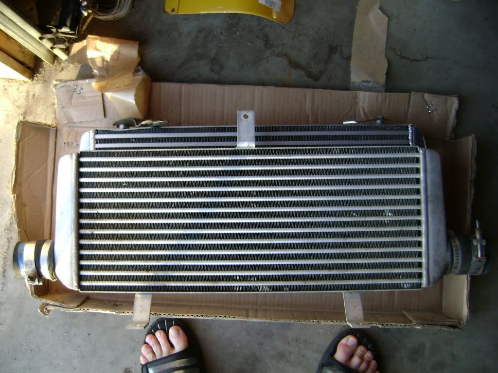

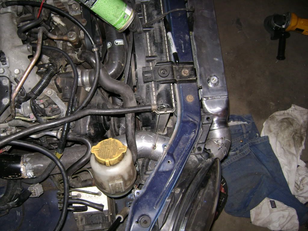

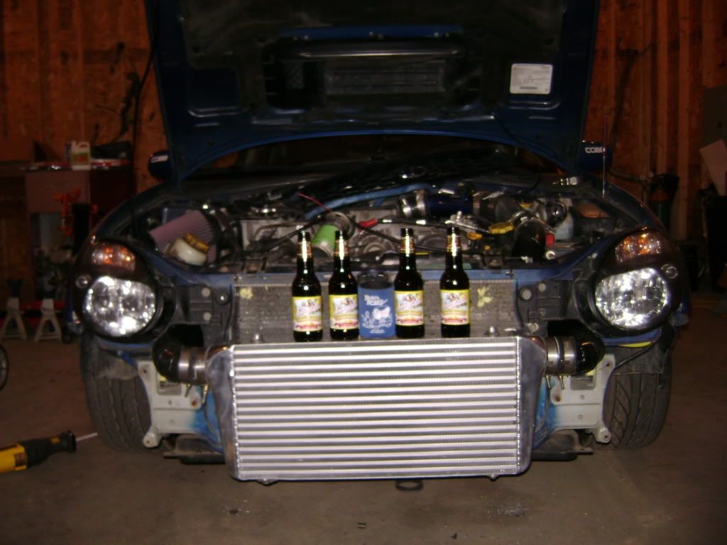

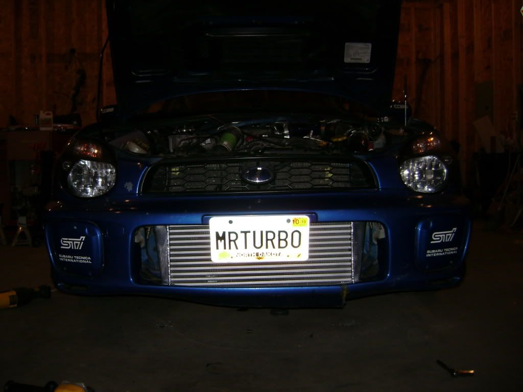

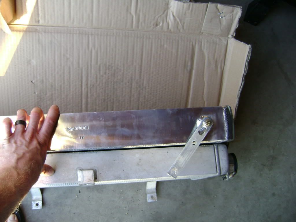

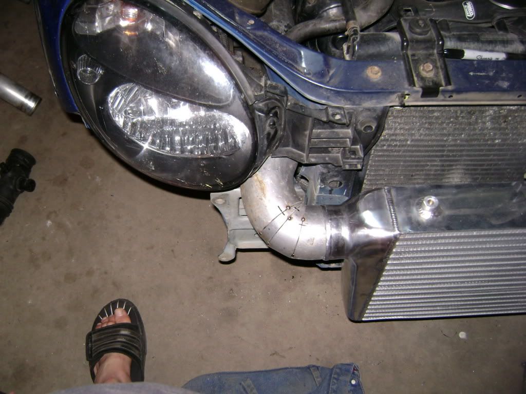

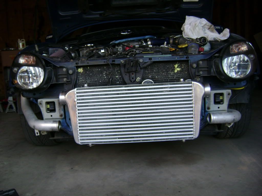

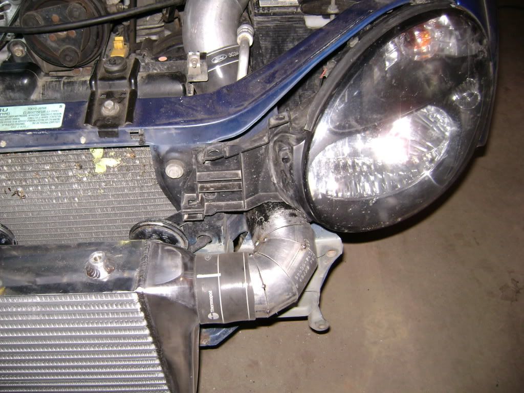

PIcked up this nicer intercooler from a buddy for super cheap and decided to re-route the airflow a bit. It is supposed to be a Spearco core but who knows.
Before
Comparison
Mounted
cold side
hot side
done
this project was brought to you by Leinengkugels Summer Shandy and Robis Repair

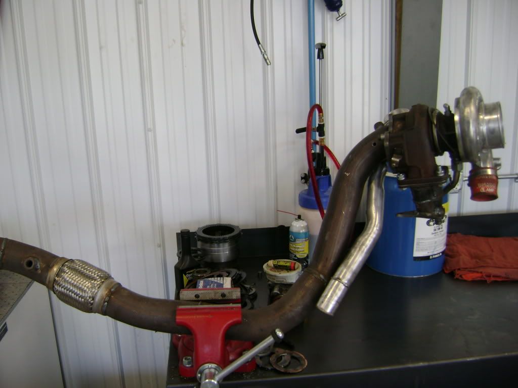

I'm getting alot of hate for the whitey bends, but still noone can expain why they are not going to work well

I'm running 17 psi right now which is pushing 300 cfm..the limits of the stock MAF on my car. I'm still working on that. Running Cobb Accessport and I think the solution is just to lie to the computer about your target A/F ratio above the 300cfm limit. Maybe someone more familiar with subaru tuning can chime in on that.

As far as the IC goes, once again, as far as I know it is supposed to bea spearco core.
...It's not.
SiFlyBy
  • Posts: 329
Re: 02 WRX HY-35
« Reply #16 on: July 18, 2010, 06:37:13 PM »
And how does one tell?
Re: 02 WRX HY-35
« Reply #17 on: July 18, 2010, 09:29:11 PM »
All the Spearco units I have seen have textured cast end tanks.
Re: 02 WRX HY-35
« Reply #18 on: July 18, 2010, 09:48:21 PM »
Your Greddy IC positioning was way better IMHO. The majority of your air takes the shortest route possible(inlet straight to outlet), and that part of your new IC is blocked by your bumper which will inhibit cooling a bit. But it looks pretty sweet how it sits, lol
SiFlyBy
  • Posts: 329
Re: 02 WRX HY-35
« Reply #19 on: July 18, 2010, 10:45:01 PM »
Like I said, spearco core. custom endtanks for the applications they were intended to be used for. My buddy bough a bunch of these from a Nissan dealer that had some aftermarket intentions for them.
The bumper really doesnt block anything because it is cut to shit after the front fascia on the top. If you see a WRX with bumper intact, take away all the black plastic and that is whats missing. Its a straight shot to the top of the IC. According to Corky Bell, your IC airflow opening only needs to be 1/4 of the area of the core you are using. A good point you have, but I think Im golden. ..Plus it looks much cleaner without the gap between the bottom of the IC and the bumper. I have since tied the bumper up so the bottom of the bumper is more uniform and the bottom of the IC is inside the bumper.

thats an ebay intercooler homes.   tell your friend that lied to you he better have been lied to himself or your going to beat whatever more you paid him then they cost out of him

Ho;eslut, birdshit welds whitey bends......   Top shelf son  Top shelf   :noel:   :yes:

Unless its a Spearco core with CDM end tanks welded to it, thats an eBay intercooler boss. They sure as fuck arent "custom end tanks" or anything. And anyone who would buy a Spearco core, wouldnt use chinese end tanks.
I have the same one on my car. You can tell by the lines of the end tanks.
Although, I would take the bar n plate over the tube n fin any day. So fuck what them fags are tellin ya. Plus, GReddy? Fuck GReddy. Show me one product that is up to par with today's advances. For fucks sake, I had to cut a hole in my "GReddy" catch can, because it was a closed set up, so I could wedge a filter on it. Bet those fan boys on your local forum would love that one.
Sell the Accessport and buy a Tactrix cable.  Download the freeware software you need (ECUFlash and ROM Raider).
You have a couple of solutions, I'm going to list them by order of preference... keep in mind I've only done AEM on built engines and ECUFlash/ROM Raider on stock ones.  I can give you very good advice, but if you aren't sure when I'm speaking from experience and when I'm playing with ideas PLEASE ASK because I don't want to fuck you on the deal.
1a) Subaru is one of the best MAF implementations ever, but to do anything with what you have and keeping the MAF is going to cost money.  See if there's a speed density hack for your ECU (I know there is for 04-ish STi, and I *think* bugeye) and milk that.
1b) Blowthru MAF skews what the MAF actually reads, lower's it's ceiling so to speak.  Dropping that sensor into a 70-75mm housing pre-turbo will both not skew it's output as airmass goes up, but also increase it's peak.  Hell, you can probably try for a full 80mm housing as that's the size of your turbo inlet BUT be aware that when you make a MAF too large you can kill off it's ability to read airmass with any resolution at idle.
* keep in mind that 1a and 1b are ASSuming that a built motor with excess clearances aren't wreaking havok with the knock sensor, which is a backbone sensor in those ECUs.  Unlike Evo you can disable it and tune off the base timing map, but I really recommend dyno time.  If the KS is freaking out I'd do that with my own car, but you might want to look into buying a $400-500 Honda AEM and wiring it into your WRX. *
2) Diablosports MAFia to rescale your MAF in it's current configuration.  $180 new I think?  The basic idea is that hotwire MAF are 0-12 volt devices, but the ECU can't read past 5 volts of that signal.  A MAFia will compress 0-6 volts into 0-5 volts, etc, increasing what you can read out of the meter right up until you lose resolution at idle exactly like having too big of a MAF housing.
3) Honda AEM wired into a stock WRX ECU plug.  If you are feeling snappy, and want to keep scantool emissions, you can keep the stock ECU powered w/ all codes disabled and the force readiness box checked and let it pick up OBD2port duty.
I'd be curious to see some datalogs, with an eye to AFR, timing, IAM, and KS feedback.  Also, it sounds like you're pretty bright/decently well read on the cars to get what's obviously a 300 whp 350 wtq Scoob to hold together, but please don't raise the revlimit or you'll shit the oil pump.

The flanges look a bit thin, but I fucking like it  :noel:

Flanges are NDDM  O0...Thats like CDM or JDM, but made in North Dakota by me cause Im too fucking cheap to buy a $15 flange. Luckily they warped the right direction so they seal nice. :noel: :yes:
