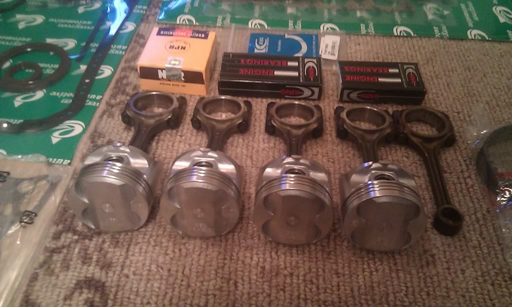

I have been collecting parts for a all motor d15 using vx rods and p29 pistons.

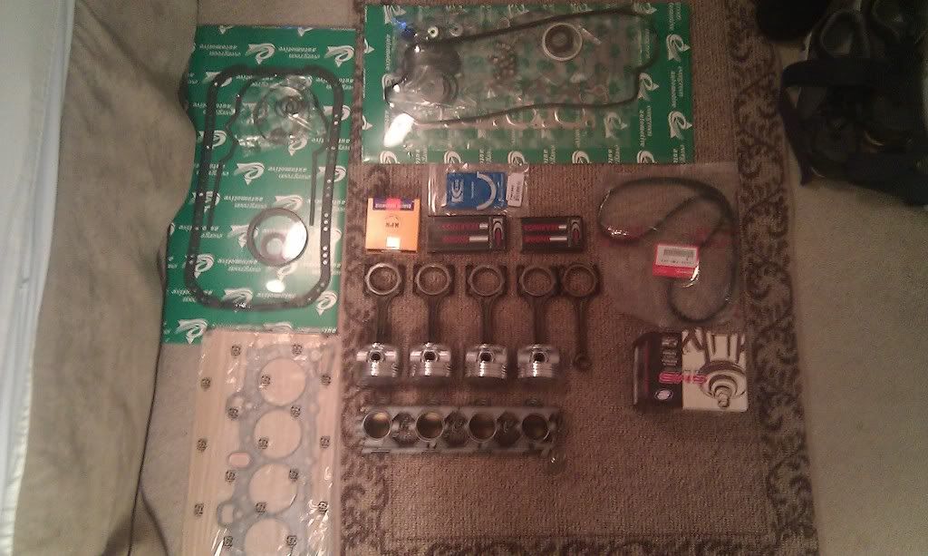

Parts I have colledcted
cbr itbs
delta 280 cam
vx rods(arp bolts)
std bore p29s
gaskets
4-1 header
king bearings
oe timing belt
etc.
I am going to see what type of power I can get out a single cam with good induction and exhaust and some head work.
Coupled with 12:1 compression should be a fun motor to rip around.
on to some pics.

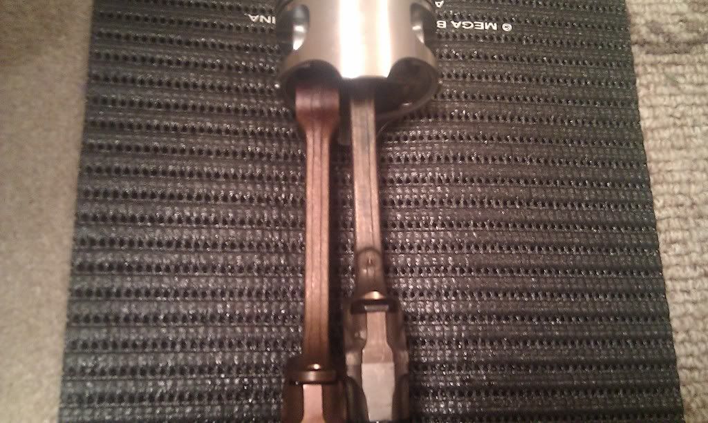

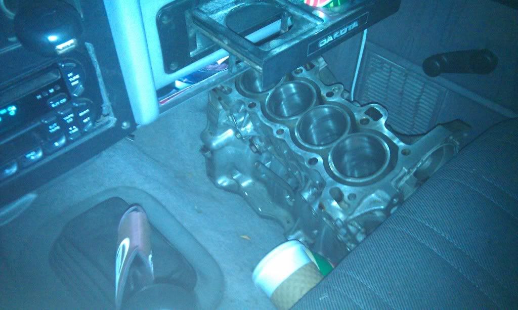

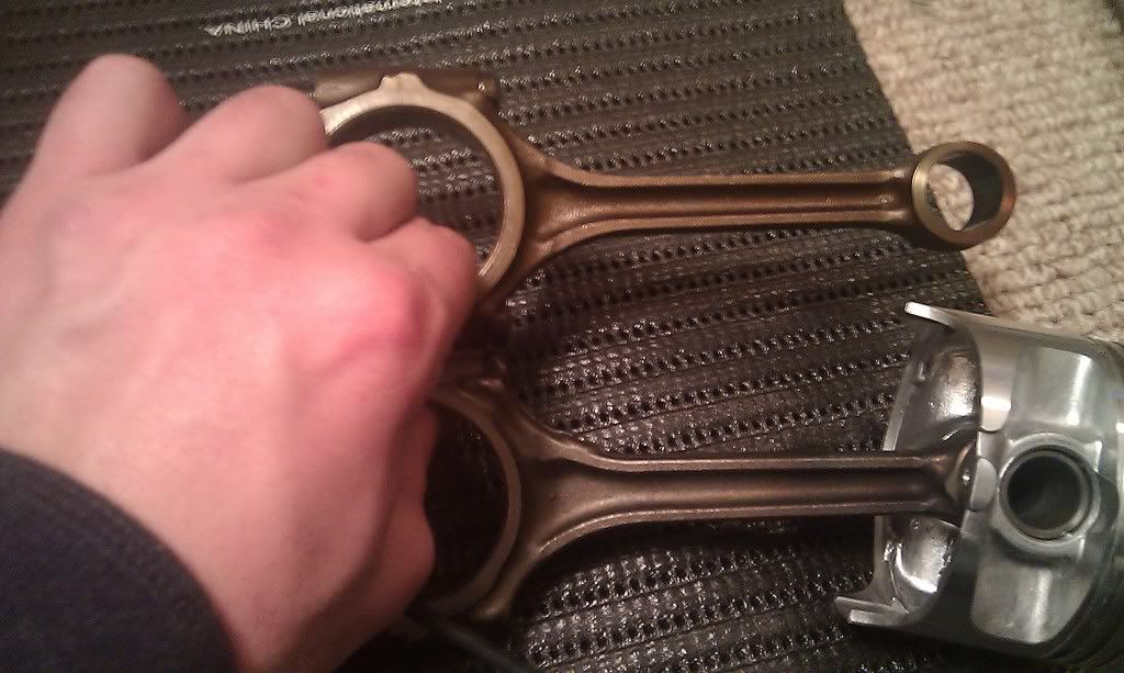

Interesting to note the po7 rods look a lot more like d16 rods vs d15 rods. The beams are thicker as well as the big end esp around the oil jet.
Thanks to Russ for the rod bolts and itbs and flipnog for the crack head price of the rods.

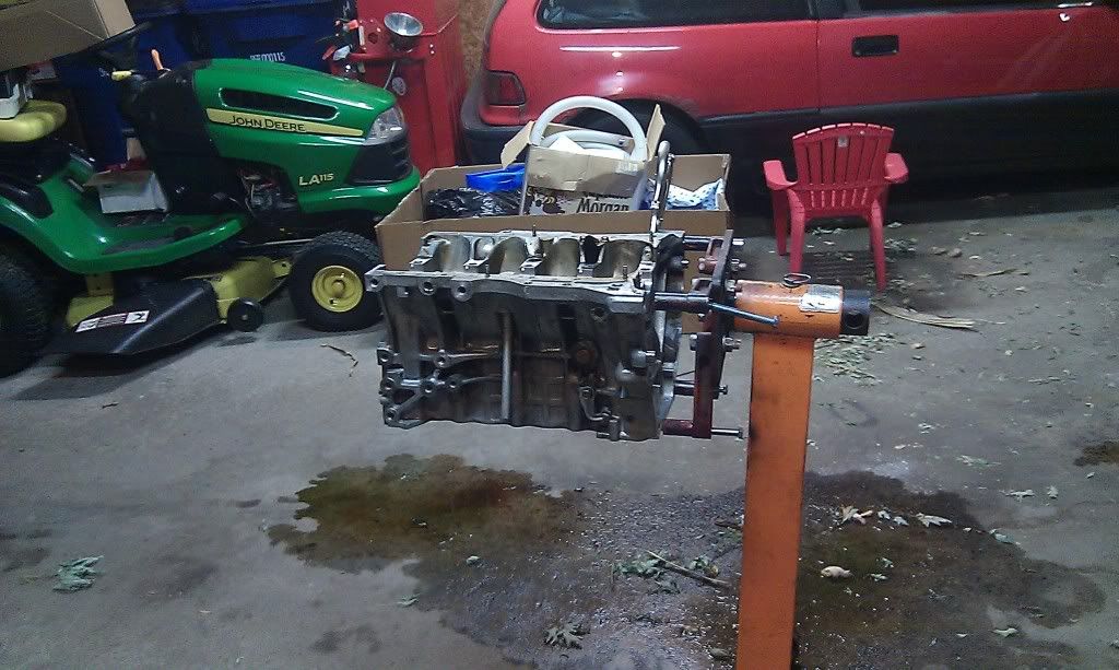

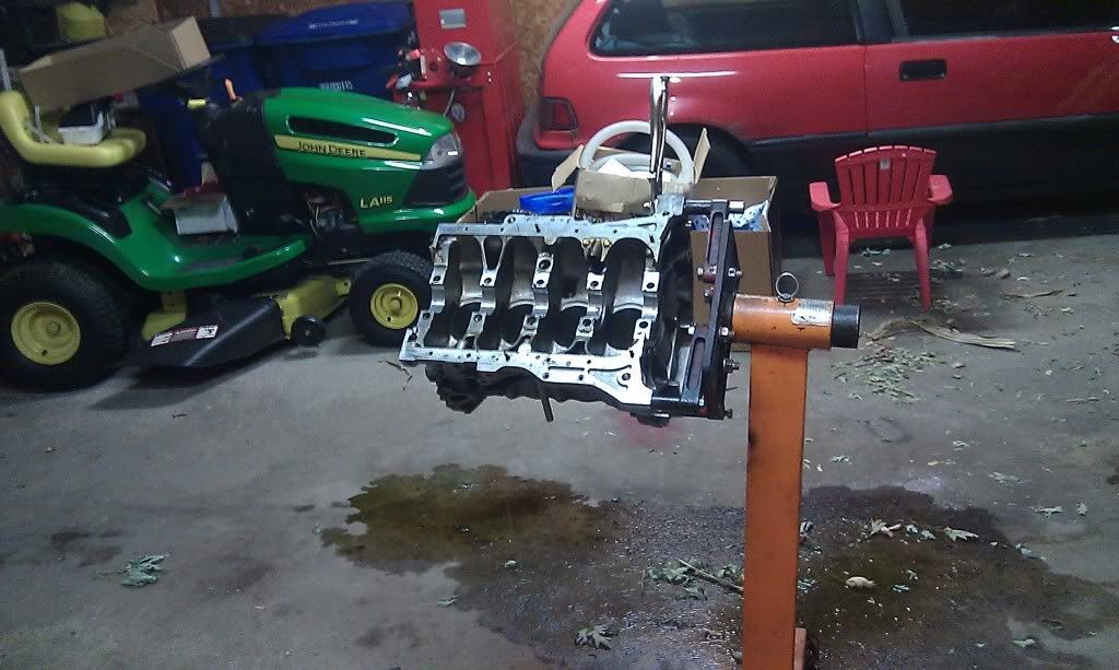

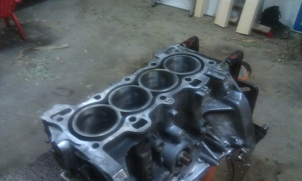

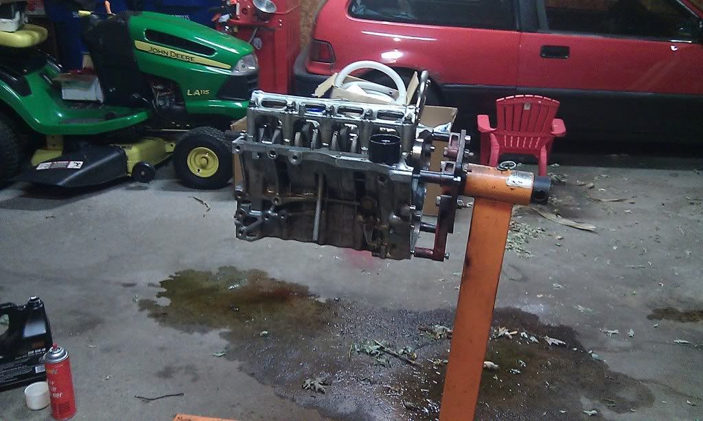

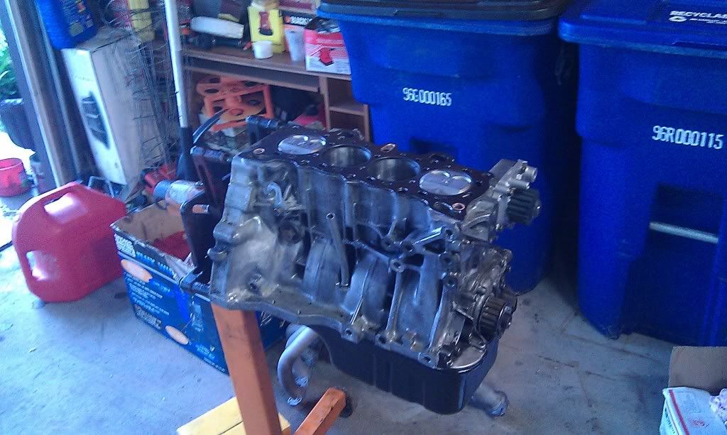

Tossed the bottom end together yesterday going to finish it tonight.
Put the crank in. No pics of the crank but we have all seen plenty of cranks. It was polished.

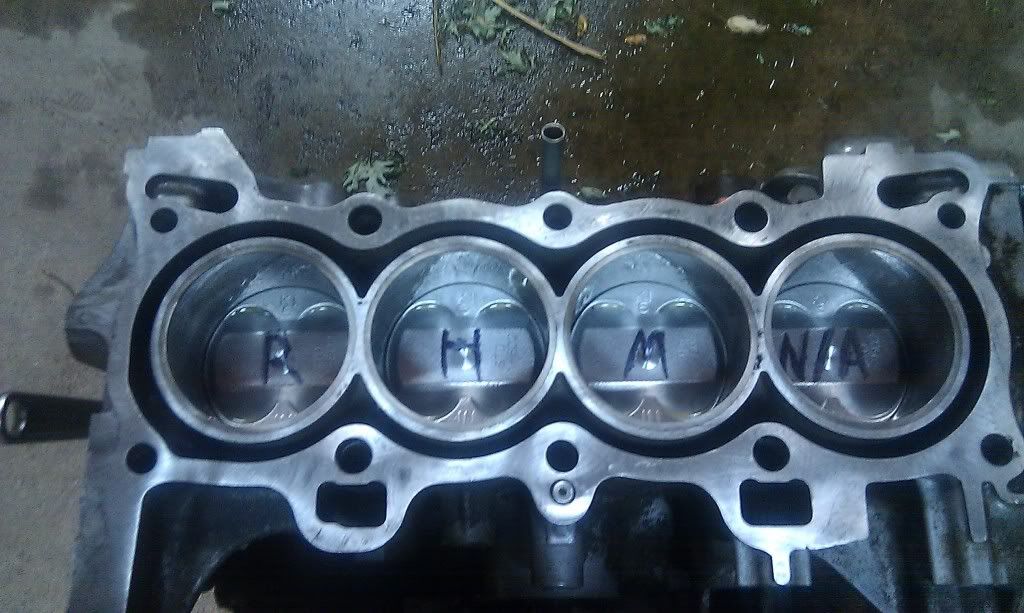

Tossed the first slug in it and rolled it over to tdc. I did calculations and research and when you look at in pics 53 thou does not seem like much but after you see it for yourself they are really far out there.
No Boost  O0
Finished the bottom end friday night with daswife.

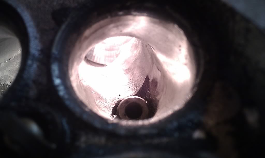

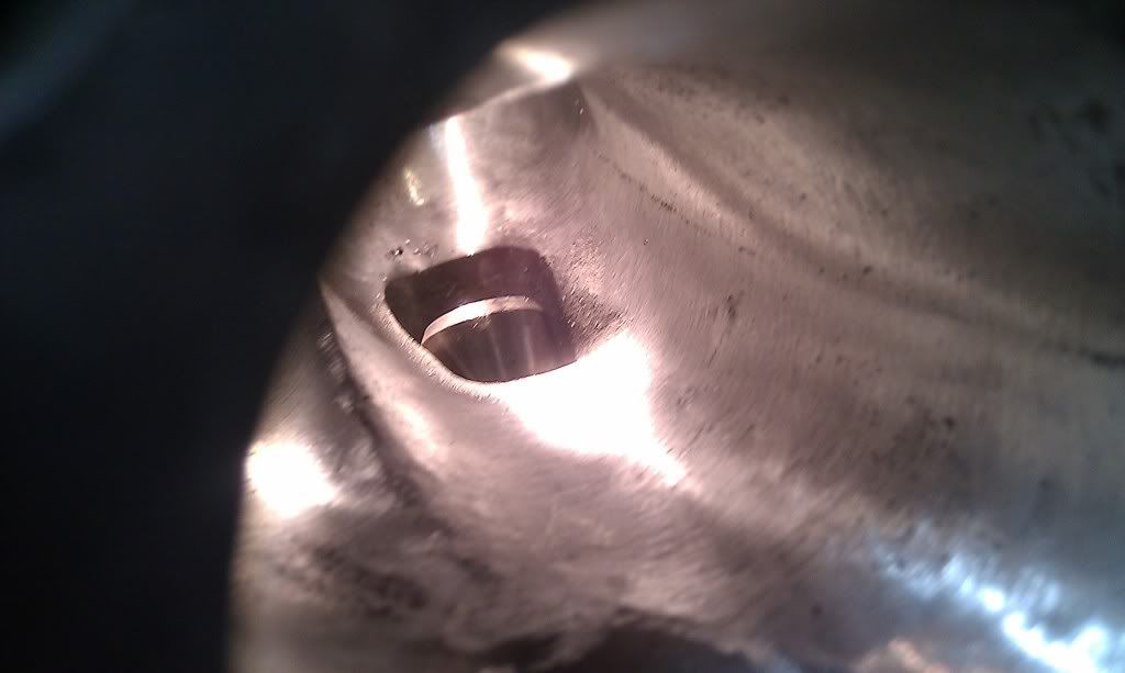

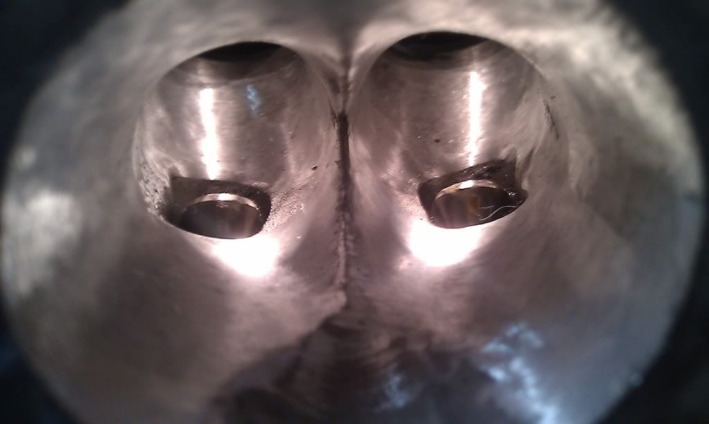

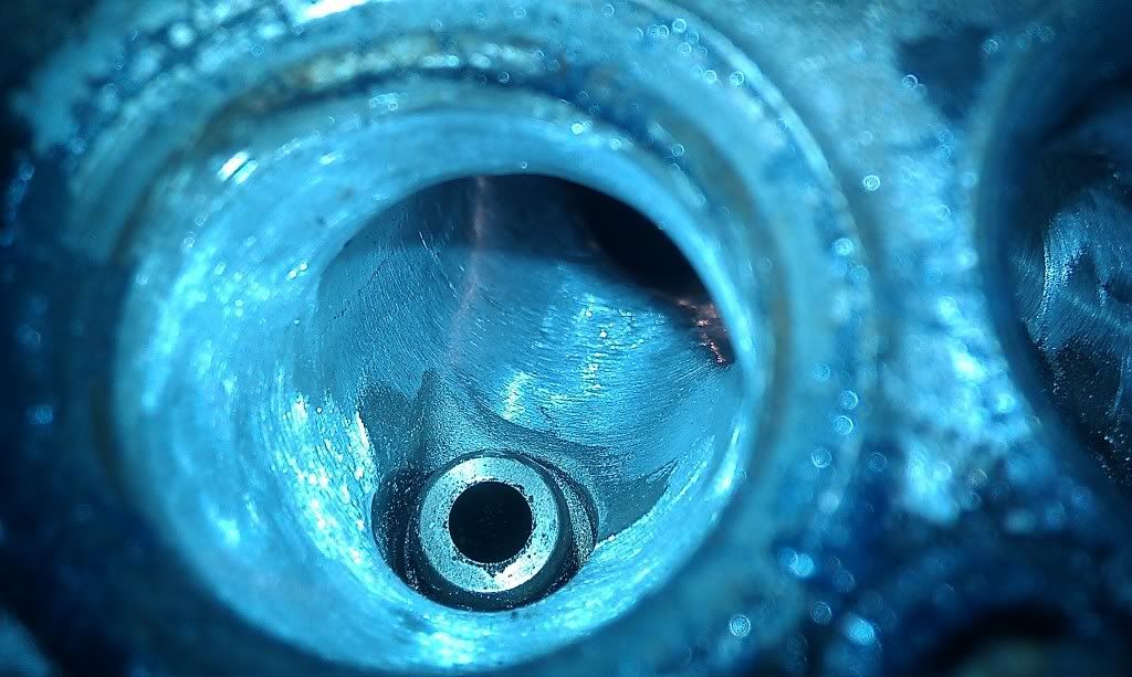

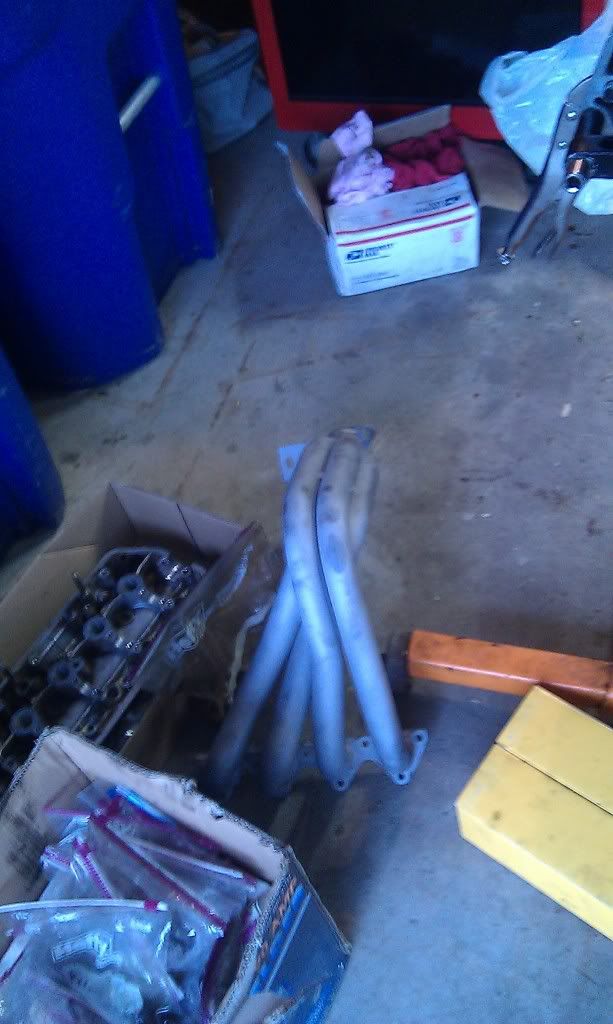

Worked on the head all today. This thing was beat. No pics of the drill vac line lapping goodness. I cleaned up all the ports, was running out of time so the exhaust got less work than the intake but everything has been smoothed and blended the bowls have been worked into the seats. I left the port divider pretty much stock and I am not sure what to do with the injector pockets as the intake manifold I am using does not have provisions for injectors. Was thinking about filling them in with devcon and blending them into the rest of the port. Suggestions? But onto the pics.
Intake
Exhaust
Pic of the 4-1

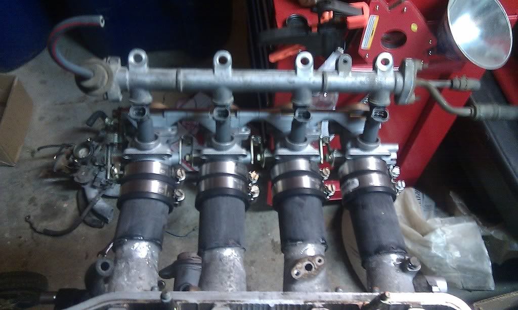

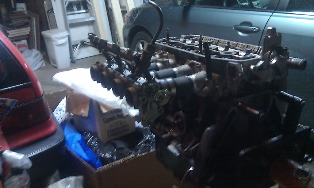

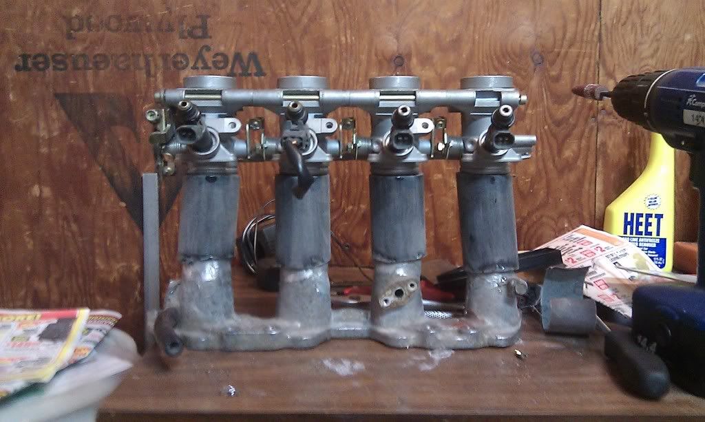

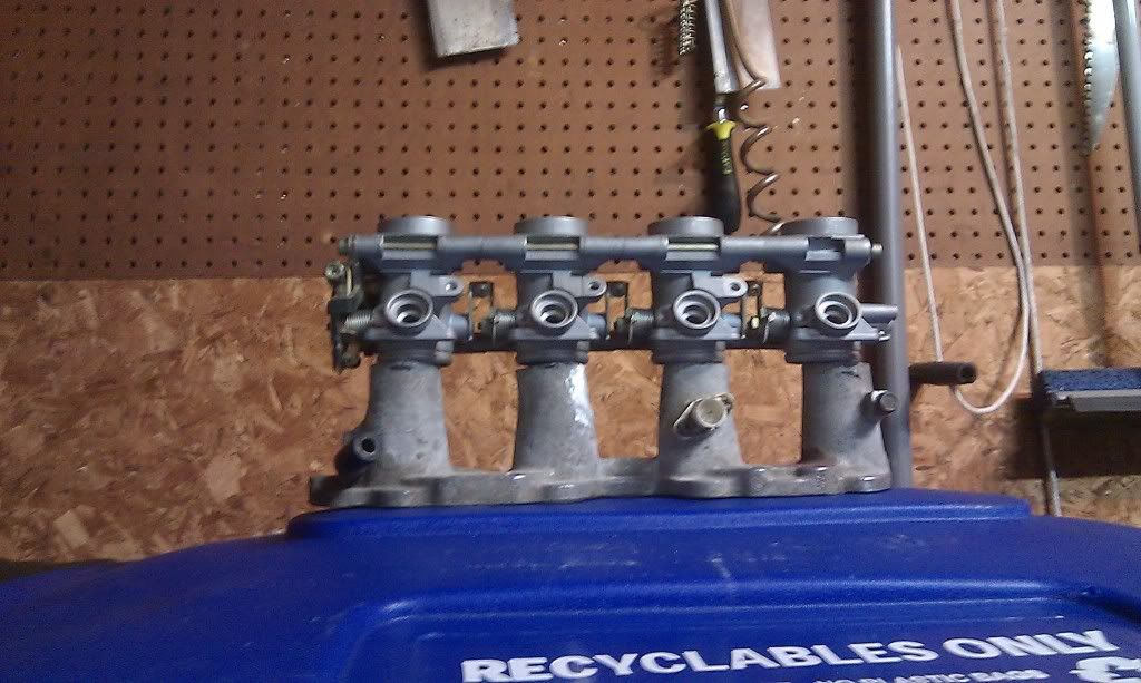

Took an old dpfi manifold and after a little cutting and lots of grinding coupled with some cbr parts and came up with this this. Enjoy
11-6-11
Finished up the itbs this week. Got some composite tubing from a machine shop in town I run there dyno at from time to time for dyno days tuning etc. Its a little over 1.5" in dia. lightweight and strong. this was a 2ft sample stick he got that he said he wasnt going to use. anyways cut up some lengths and grabbed some epoxy and went to town. When I was done I have runners that are all 5.25" from the flange and they are all within 1/16th of an inch in length. I am going to brace them to keep them from having a change to crack. The throttle bodies came with no fueling so I needed to devise one. I took them to the junk yard and started to look at all different kinds of small engine fuel rails and in the process grabbed some densos that were promptly decapped. I came up with some hyundai 12v 1.5l(i think) rail. Its return style and aluminum and will fit just about any injector I want. I still need to make the final mounting brackets but my injectors fit very tightly in place so it wont need to be anything crazy strong.

They are factory Vx d15z1 rods d15 big end and 137mm. I would have to say a vx bottom end with a non vtec head would net vitara compression and bigger rods it might make 220 wheel boosted.
and DC sports made a 4-1 d series header. I got one from hiprofile although I have yet to pay for it.  :noel:

I read the guy on d series who did the same thing and found out about the plugs. I am really debating on the hgs I have 2 composite gaskets currently but that will kill WAYY to much compression. They are .048 thick. I am thinking about messing around with the idea to cut apart a stock mls gasket and see how many layers i need to make it "safe" to clear I am trying to get as much compression as possible while still not having the piston meet the top end. The head without valves will sit on the block with just one gasket and not hit at tdc but its got to be super close.
Hey STOOPID, I am that guy :) Read my avatar...
Might wanna round/bevel the edge on the piston top.
« Last Edit: October 23, 2011, 09:56:39 PM by crttaz »
DasPoop
  • Posts: 1761
Hrm didnt think of that(bevel the pistons). Any specific measurements on the bevel? I saw that you used 2 y8 gaskets stacked. I hope all this goes together. If all else fails I will stack 2 composite gaskets and have ~11.3:1.
EDIT: I think I am just going to stack 1 composite on the bottom and a mls above it .085 thick and 11.7:1 which is still pump gas friendly. I am just hoping my cam clears at this point. I also have a 272 in my stock d15 that I suppose I can use. If I have enough room I might send off another cam to get a 282 grind :evil:
« Last Edit: October 23, 2011, 10:38:10 PM by DasPoop »
NOTE I never ran my motor, but a buddy did @ 13.7:1 until something major happened, never heard what it was though.
Cometic .080" HG is an idea, Two MLS would be better. You can get a 5 layer MLS which equals the composite thickness, OEM replacement from Honda. I mocked up using a .425 lift cam and there was no valve clearance issues.
Note that with the thicker HG's it will advance the cam timing slightly.
I guess on the bright side, when you disassemble it you won't need to do any ridge reaming.
Just make sure you account for rod stretch at higher rpm. Just make sure it gets it's lube. I've seen many more D16 rods snap from siezing onto the journal than rod bolts snap.

You missed almost everything in porting a head that makes power LOL
DasPoop
  • Posts: 1761
Re: OMFG I have a Build Thread. the all motor d15 "sleeze" :ITBS!!!:
« Reply #14 on: October 25, 2011, 09:16:07 PM »

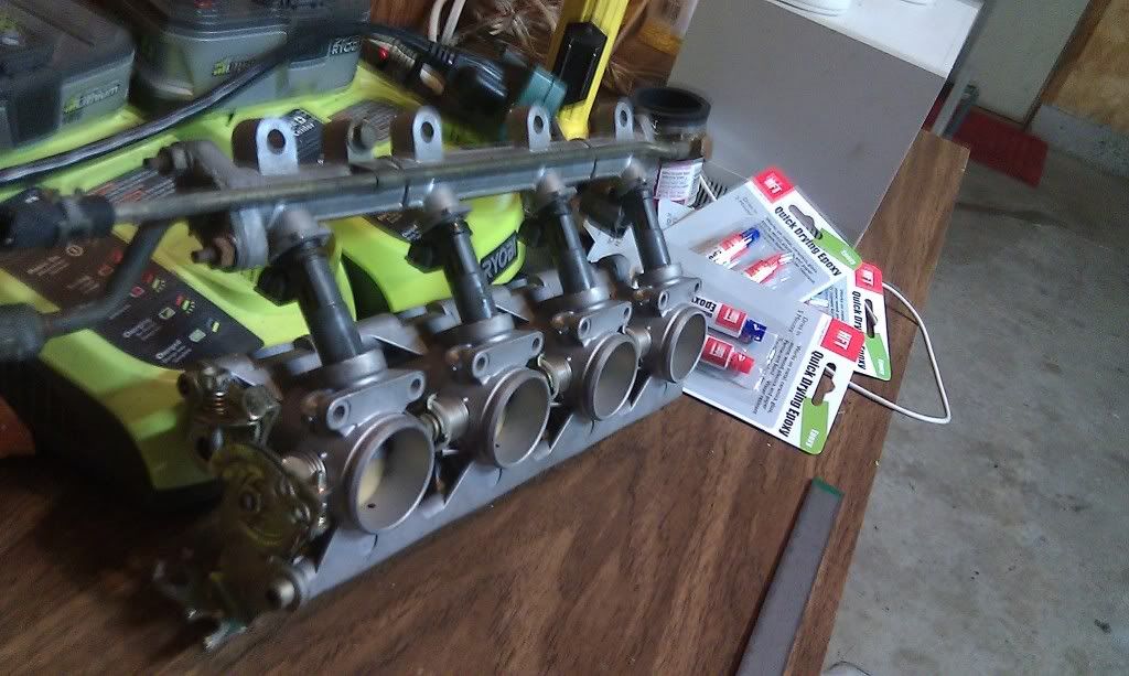

I was waiting for that. I bought some devcon to fill the injector pocket in. I took notes off the endyn website. I got a new mandrel to allow me to work further into the port and tweak the center divider. Do you have any tips. also how do you take payment for parts?
« Reply #15 on: October 25, 2011, 10:08:09 PM »
Blend the guide down into the port and work the shit out of the divider. Also you should not see any casting. If your porting a head you better take out some real material to make a difference powerwise. Unlike the b series heads d series heads especially the non vtec ones need the ports opened up tons to make them perform.

I havent looked at d15b2 manifold in a long time but cant imagine the ports being to friendly powerwise
This is a set of itb's I did years ago. z6 manifold cut down alot and new fuel rail mount welded on since we went way down to almost the flange. Perfectly staright and the z6 manifold has the largest ports of all sohc oem manifolds.
DasPoop
  • Posts: 1761
« Reply #17 on: October 25, 2011, 10:56:17 PM »
Thanks for the porting tips.
The itbs i have are only 36mm in dia. I am most likely going to end up hogging the shit out of the manifold. I choose it because well I have 4 of them and I wanted to use the stock injector location on the itbs. The manifolds ports look to be the same size as the gasket but that doesn't mean shit. I am seriously toying with the notion to fill in the roof of the port with devcon and blend it all together but having that big of a step after the manifold might help a ton with reversion. I am not 100% about that theory so any insight from people would help tons.
« Reply #18 on: October 25, 2011, 11:09:52 PM »
Try to get the biggest itb's you can on there honestly. The set in the pics were a 42mm plate unit that tapered down to 40mm. I ported the itb's so that they were 42mm from plate to inlet. The velocity stacks I think were off the biggest cbr honda makes got them at a local bike shop on the cheap. They bolted up to and for 25 bucks did the job.
Your over thinking it the power in heads especially in honda heads is blending the guide into the port,honda heads you can get away with it. Look at anyone who does it for a living we all do it well I use to do it when I could actually get a head sent in to get ported.

Im hoping you also are going to weld some pipe onto that cut up manifold. You want those as straight as possible for obvious reasons

Devcon fill the injector humps
