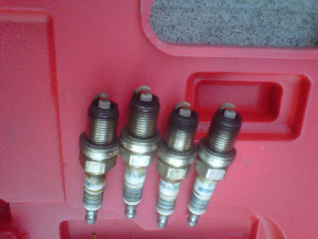

HF leak down tester says 70%, 73%, 72%, and 75% Don't know how much I can trust HF tools.
Couldn't do a compression test b/c the tester broke, but after break-in the compression was around 175psi in all cylinders. Problem persisted ever since break-in.
Didn't hear any leaks through the exhaust, intake, and no bubbles in the radiator.
attached pic of spark plugs, this is from normal driving

so you have 70+% leak down in all holes? sounds like you did more than just pop a head gasket. Start it up and take the oil cap off and see if you get sprayed in the face with oil. I am thinking under boost you are only hitting on 3 holes and the one that is hurt is the one that blacker plug came out of. Your putting pressure in the crank case and forcing it past your now scored to hell bores/busted ringlands
