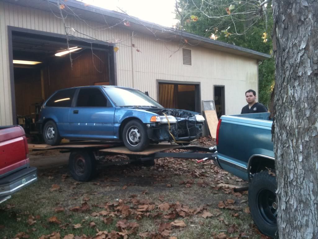

This is mine. Excuse the car on the pos trailer. It was a test run to make sure the trailer would work before putting a lot of work into it

He sure as hell doesn't work on it in there. There is barely room to get in it.
What work did you need to put into it?  Looks perfect to me :mexi:
Re: Building a garage!
« Reply #49 on: November 21, 2011, 01:53:29 PM »
It needs tires and I was going to put 2x6's on it to make a deck. Luckily before I dumped any money into it, a guy asked me about storing his car trailer in trade for being able to use it. It sits behind that building where I can't even see it and I use it at least once a month, he uses it about once every 4 months.

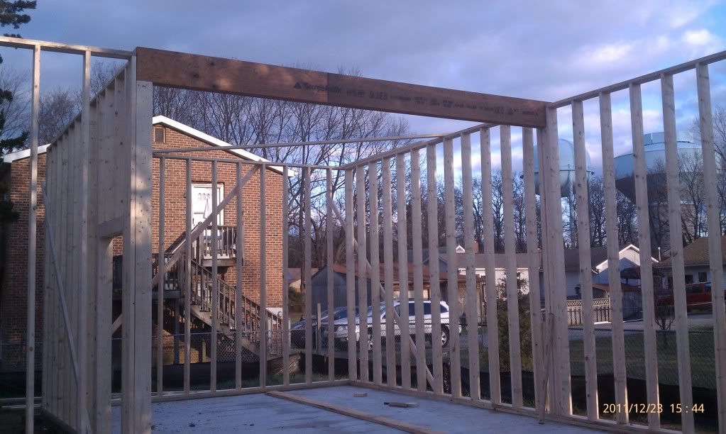

« Reply #55 on: December 26, 2011, 06:00:37 PM »
Looks good. But I would have moved the beam back 1.5" so you could have ran another stud along side of it to create a pocket for it to sit in like it is on the other side. If you were to add another one now it will protrude outward, Meh plenty strong the way it sits though. I imagine your gona use some sort of strap/tie to hold it from kicking out anyways though. Looks good. I only wish I had a garage that big.

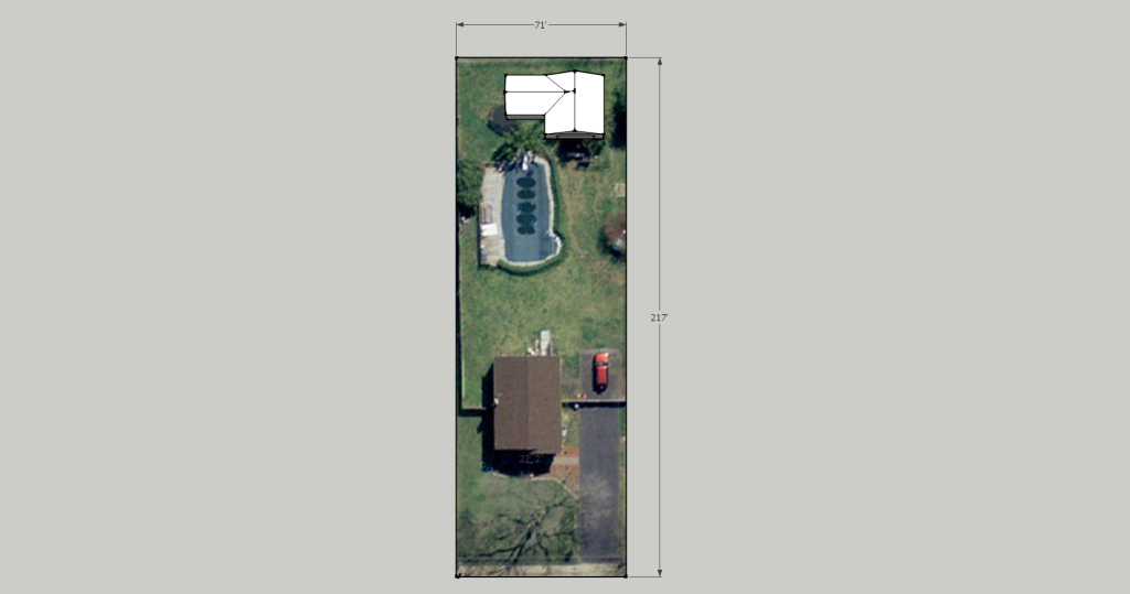

What program/software did you use for your rendering?  I like that it has the materials needed listed to help figure out the price.
stealthiskey
  • Posts: 441
« Reply #57 on: December 29, 2011, 08:47:59 AM »
That rendering was done with the free version of google sketchup.  It's not the greatest program, but it is free.  I added the material list in somewhat manually, although it will count the number of "objects" (such as 2x4s) for you.  My biggest gripe is that you can't set a dimension, everything is click and drag something as long as you want, which can screw you if you need different levels of precision.
Turns out I'm no structural engineer either.  I can draw stuff up according to common practice (16" OC etc), but I can't calculate wind loads, and beam strength.  Had to hire one to actually draw up the real plans for permit approval.  The overall dimensions are still the same, but there are some critical alterations.
But to their credit, I was able to view google maps, take a screenshot of my property, measure out the dimensions, rotate and crop it to just my lot, save as jpeg.  Then using sketchup create a rectangle the size of my lot, and import the jpeg image as a texture, thereby pasting in the google maps image right on to the ground.  Helped visualize where everything would go, and how it would fit around the pool and trees.

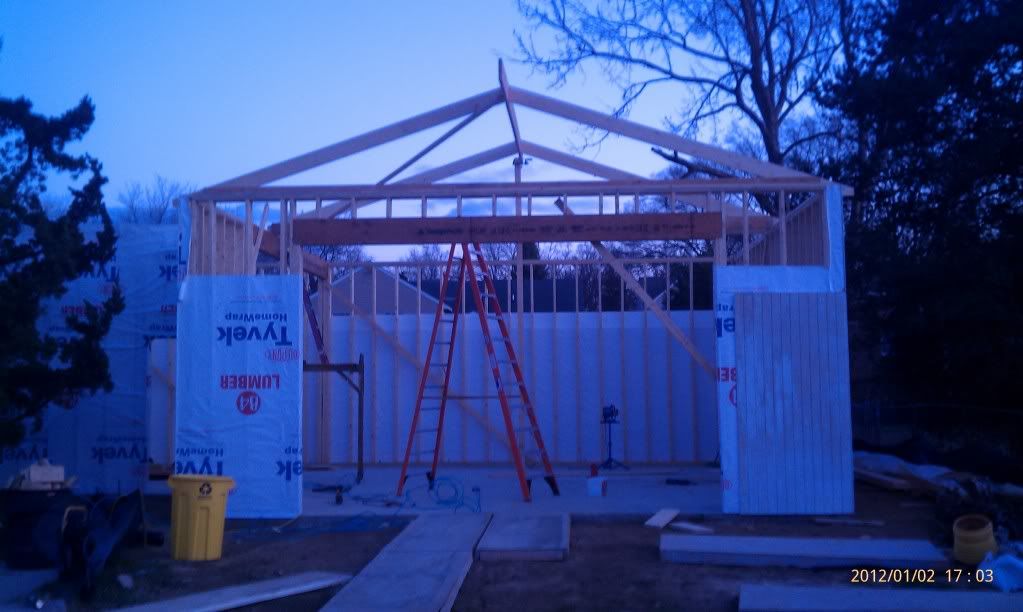

Gotta plant some trees in that bare spot, or something.  Good compromise between what I want and what I can afford.

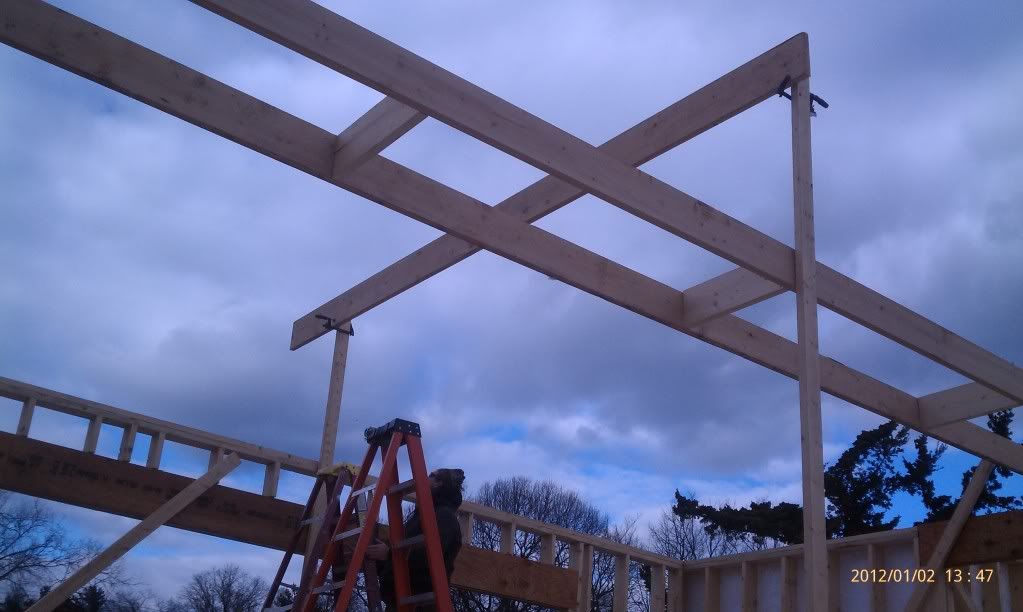

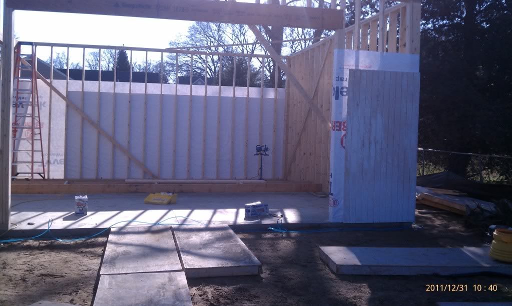

Made some good progress:
View from across my baller status pool
Tyvek and wall sheathing.  May not be what you're used to because I'm using t111 not vinyl siding.
Putting some of the roof up.  No trusses here.  Putting those first beams up was terrifying, also happened to be one of the windiest days this winter.
This one running across is about 16' in the air, and that's a 12 ft ladder.  Put them up with clamps until we could get the first set of rafters into position.
Looking good
